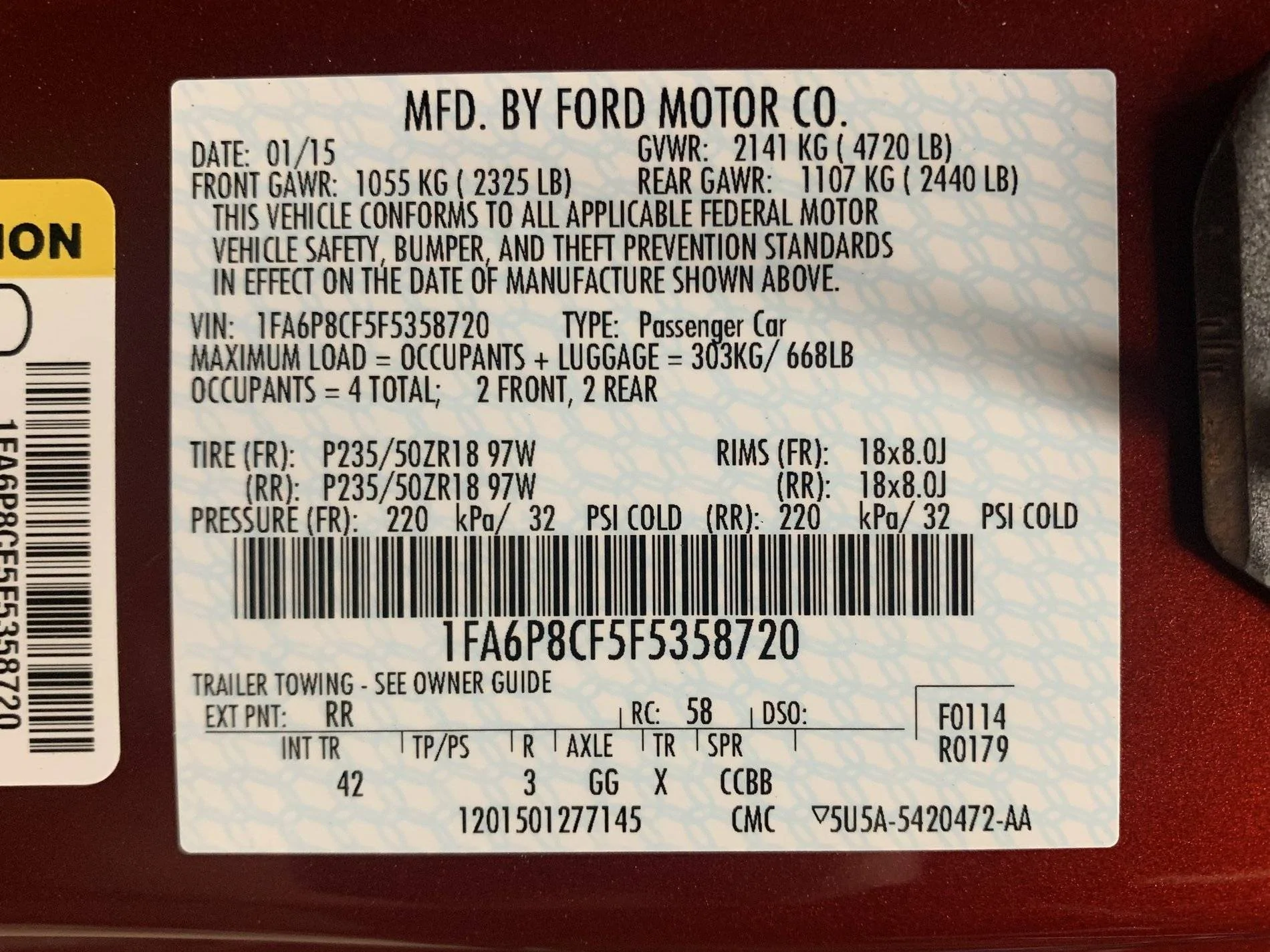

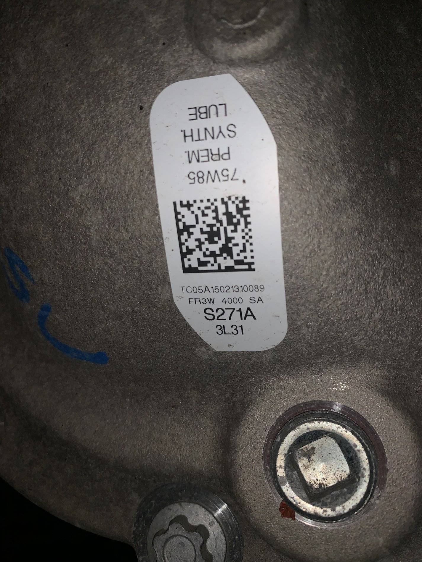

I’ve been researching for the past hour or so and have been getting mixed information about how to find what ratio rear end I have. I don’t have the original window sticker, I’ve looked at the diff and the door jamb but am still having some confusion. 2015 GT manual, non PP. Any help appreciated

3.31 gear. 3L31 and the GG code shows what gear the car came with stock....

Thanks, I saw the GG but couldn’t find any direct answer. Appreciate it

3L31 means 3.31 ratio locking rear.
