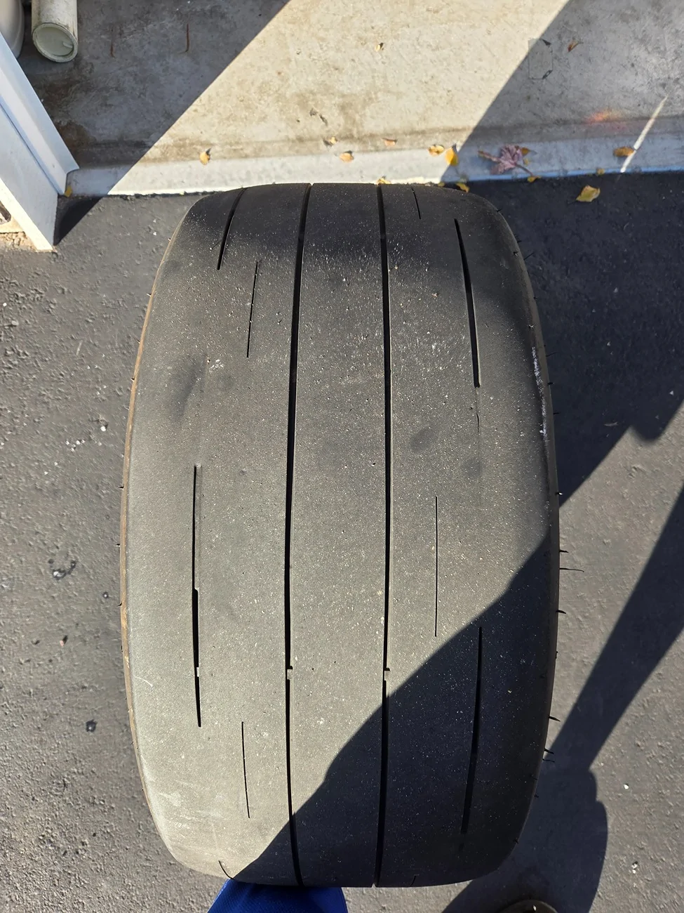

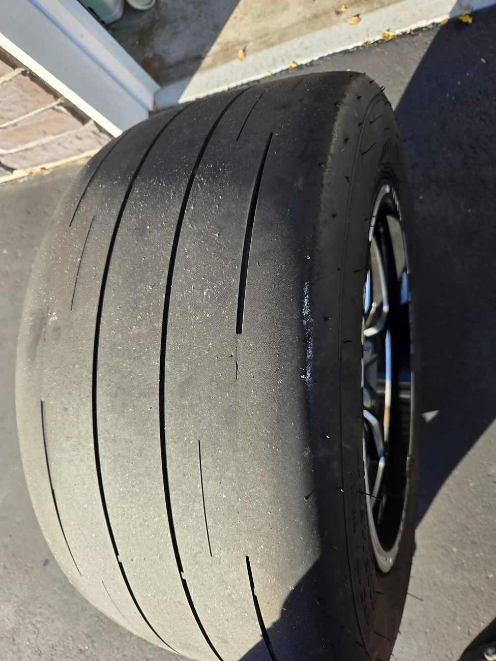

Update: I had the alignment guy check he said that the alignment was fine & was perfect to drive
The window of allowed spec allowing him to state this, is pretty wide. More generic than anything.

This is -.6° rear camber and basically 0 rear toe with a 305/45/17
What components did you need to get that alignment in the rear? Do you have camber arms?

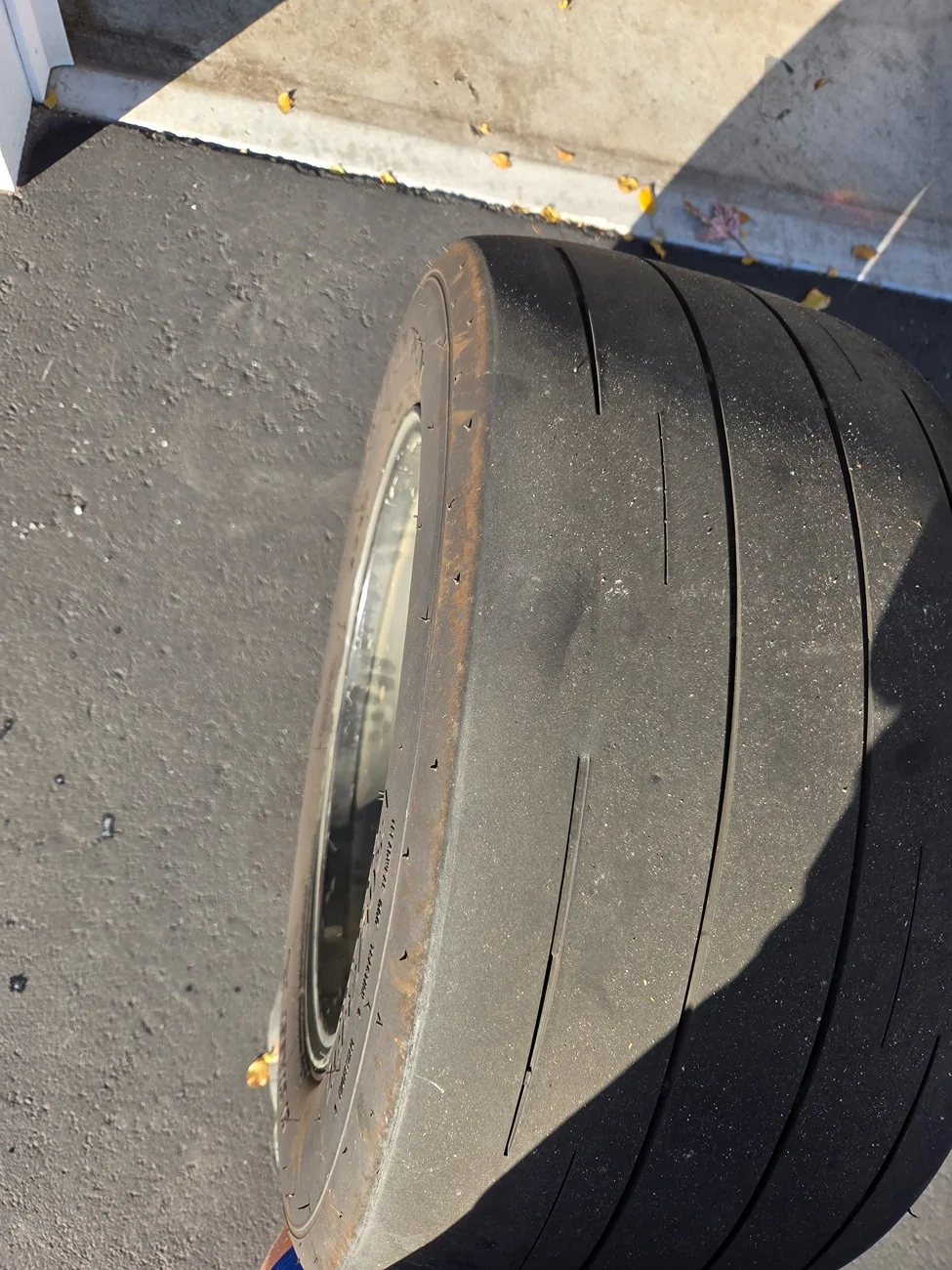

Old thread but wanted to give info for new unaware people. I would say yes since I got uneven wear. Inside tire seems to be wearing out more than than the outside. Im on stock suspension.
Pws6
Feb 3, 2020
170
142
Usa
2019 Mustang GT
Then you know the taller the tire, the more pronounce ( in/out ) on the top it is with say the same -3 degrees camber. You'll have to make adjustments for it. Unless of course it's at 0.
This is one of the funniest things I've ever read. Does the angle of a protractor change based on how long it is?
