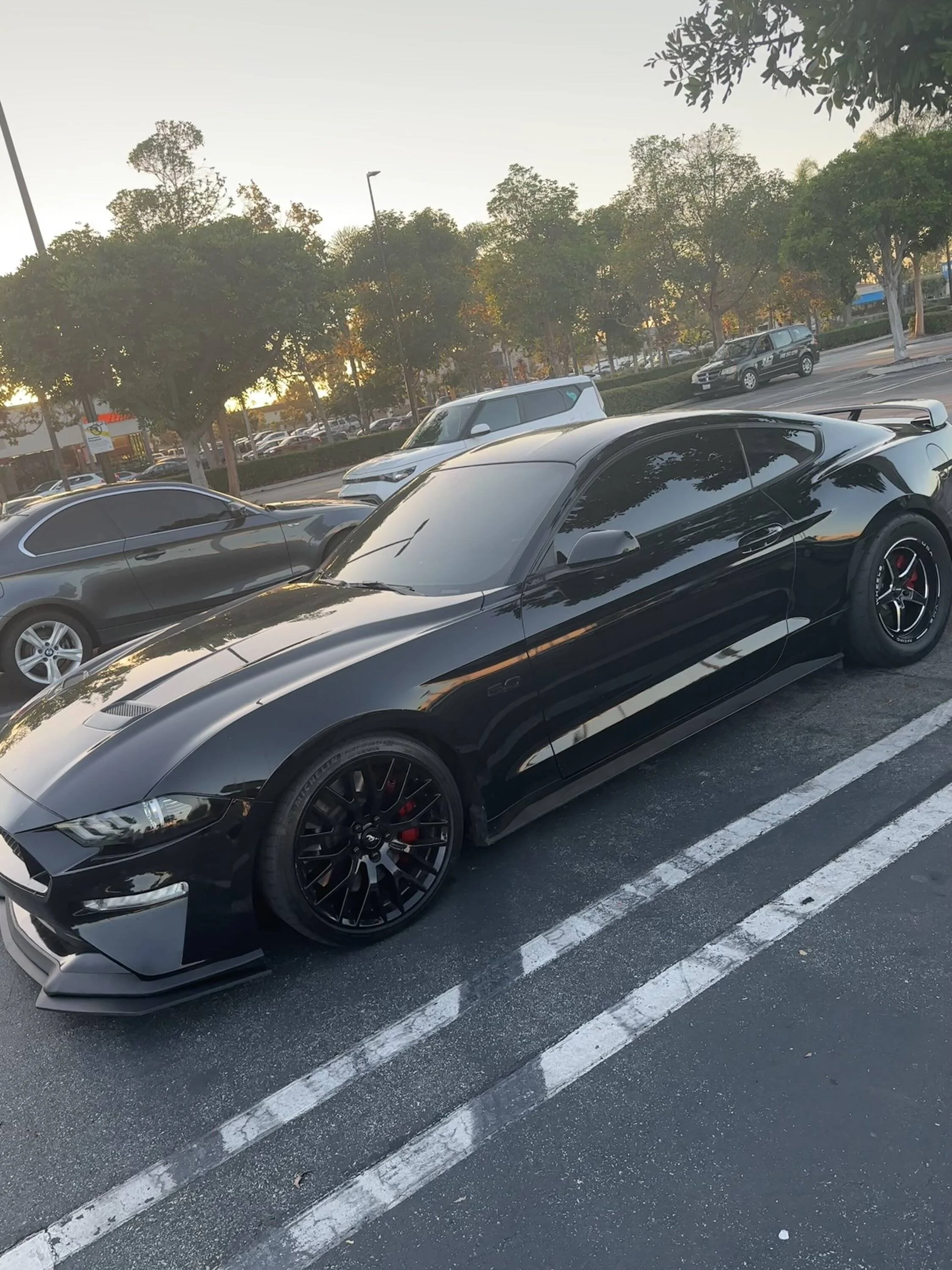

I was wondering do I need an alignment I haven’t seen anyone else do it haha
Probably a stupid question but I just put 305/45/17s on my rears with 255/35/19s with stock wheels on the front and I plan on daily driving it . I was wondering should I do an alignment so the thread last longer & any other benefits?

Update: I had the alignment guy check he said that the alignment was fine & was perfect to drive but I I am getting a lot toe wear but he said it’s normal for these type of cars. So I guess if you throw on a drag pack for the rears you don’t need an alignment but I will be going back with some drag specs just to make sure!
