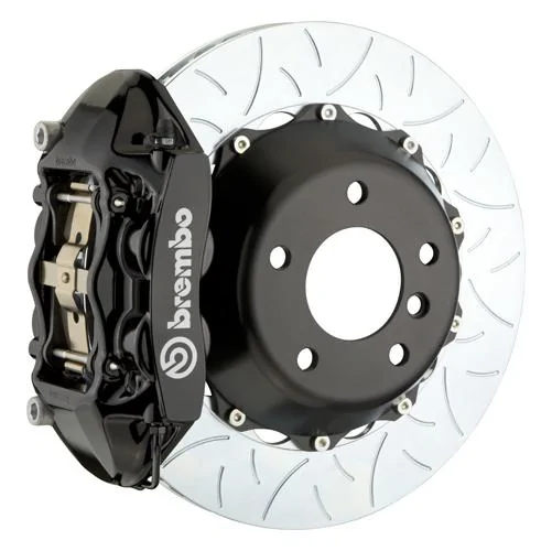

I'm pretty sure there are other options. Isn't there Brembo GT, Brembo GTR, Baer and AP Racing rear brake kits?
Depends how serious you are. I would definitely throw in an adjustable proportioning valve or whatever to make fine adjustments to the bias. But I think that's a little hardcore.
Not for the REAR in all cases listed above.
Ford is about to make a kit that will let you put the GT350 brakes on a normal and PP GT.
Brembo has had rear kits with or without parking brakes since the car has been out. 4 piston Caliper, 380mm 2 piece rotor. Brembo also has Road Race Systems available.

Brembo kits at 6k and up
The AP kit is 4K and parking brake gets deleted
Gt350 setup is the best option

Where could I buy these?
We carry the full line of Brembo BBK's. There are multiple options available but you can do a 380MM(15") rear kit with 4 Piston Calipers that retains the parking brake for roughly $4800 and one without a parking brake for roughly $3650. Brembo is an engineering partner with Ford and GM so these kits all work with the factory ABS/Stability control. They come pre-assembled with everything needed.
You also can go to billet monoblock calipers in the race systems again with or without a parking brake. There are 4 different caliper colors and 3 different rotor designs (all 2 piece) depending on usage. We can also supply G-LOC brake compounds for all the Brembo kits.
We will have them on our website soon, it is something we sell more of on the C6-C7 Corvette side honestly so we just haven't added them to the Mustang section as of yet.
Any additional questions please shoot us an email through our website.
  • Like
Reactions: F0J
