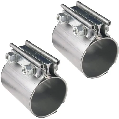

I used these. There are different designs but this type with inner and outer parts worked well.
That’s the type I used and got them from a local auto factor for around £10, they had a box full of various sizes
