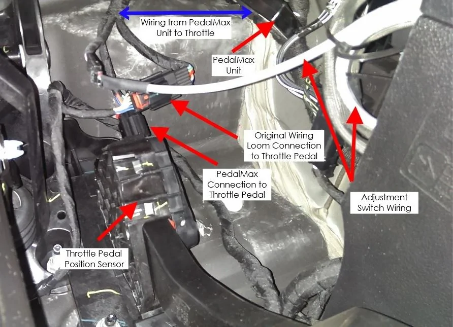

Well, first off don't believe the 'it takes 5 mins to fit' BS! About an hour is more like it - and be prepared to get yourself in some weird and (to any casual observers) very amusing positions. I ended up with my head down by the pedals and one foot either side of the headrest, holding my phone under my chin as a torch!
It's not too difficult to connect the actual unit or adjustment knob, but it's getting the unit and wiring cable-tied neatly out of the way that takes the time.

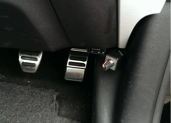

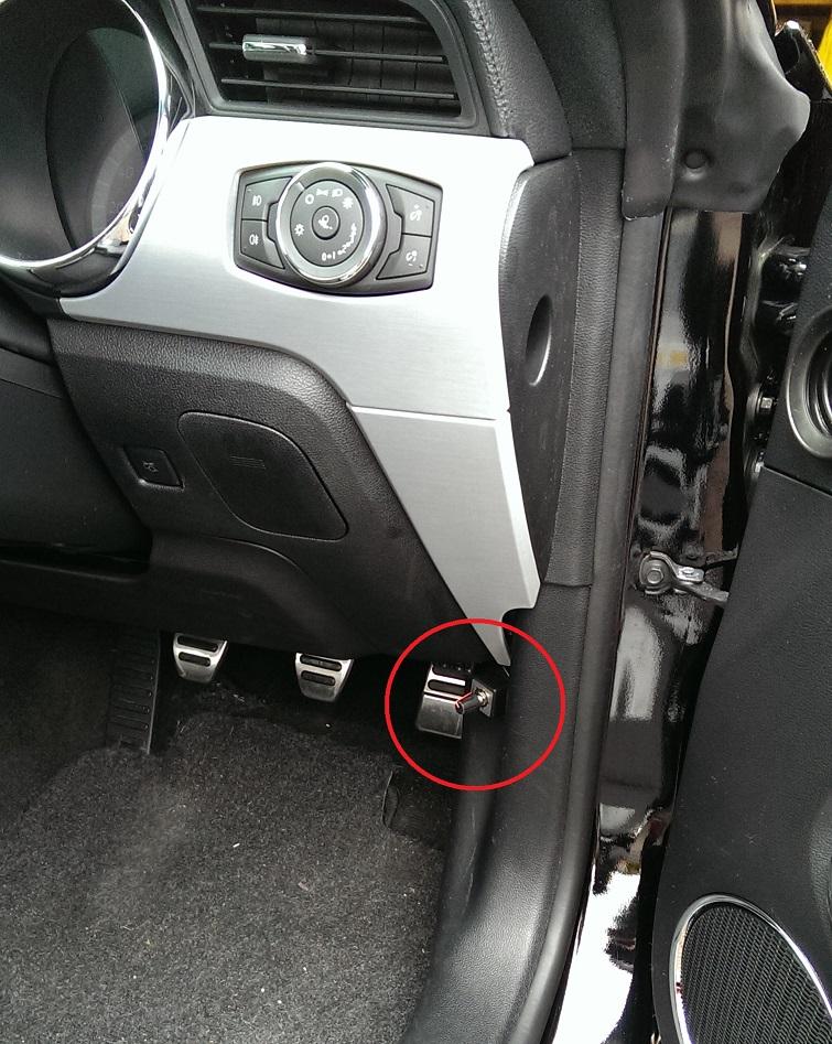

I fitted the adjustment knob down by the OBD (I think) port. It's out of the way so the setting is not likely to be accidentally moved, but still reachable from the drivers seat. I fixed it on with self-adhesive velcro squares to ensure the whole installation can easily be removed without leaving any marks.

Photo1: Post fitment, with all the wiring cable-tied out of the way above the fusebox.
Photo2 and 3: Position of adjustment switch.
