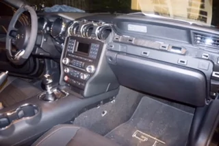

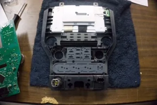

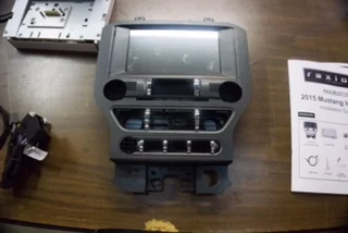

So the long awaited Raxiom Unit has made its debut. Well atleast 3 units have made its way into the world. Alex was very clear upfront that we were not to sugar coat anything and give an honest review (and he wanted 1,000 rounds of 7.62.....jk). The install took about 48oz of beer and required only a few tools; trim removal tools, T-10 torx and 7mm driver. Everything was straight forward, the instructions did skip over a small step or two but Alex will be getting that squared away I'm sure. I invited Alex to help but apparently 3hrs notice isn't enough time and building a vanity for your woman friend takes priority.
The factory trim pieces come off relatively easy if you have a set of plastic trim removal tools. Harbor Freight has them for like $10. I didn't break any clips. The instructions are fairly detailed and notate where each clip is located.

Install itself is super easy. If you can read instructions and use basic hand tools, you can tackle this install yourself not problem. Install should take about 2 hours, depending on how much beer you drink. The only tools you need to get the job done are a T-10 tor driver, 7mm nut driver, and a set of trim removal tools so you don't tear up your dash.
The instructions are very clear but I'll give you a quick summary of how the install goes.
1. remove the ac vent cover
2. remove the lower portion of the center console from the driver and passenger side
3. pry up on the center console, this lets you lift the top portion of the console about an inch. Helps with removing the factory unit
4. unbolt the factory unit
5. swap over the specified circuit board and buttons to the new unit
6. remove the old display unit and cd player
7. plug in the new harness to the back of the cd player and re install the cd player
8. plug in the new nav unit to the harness and connect the rest of the wiring
9. re install the new unit in the dash and put you dash pieces back together
