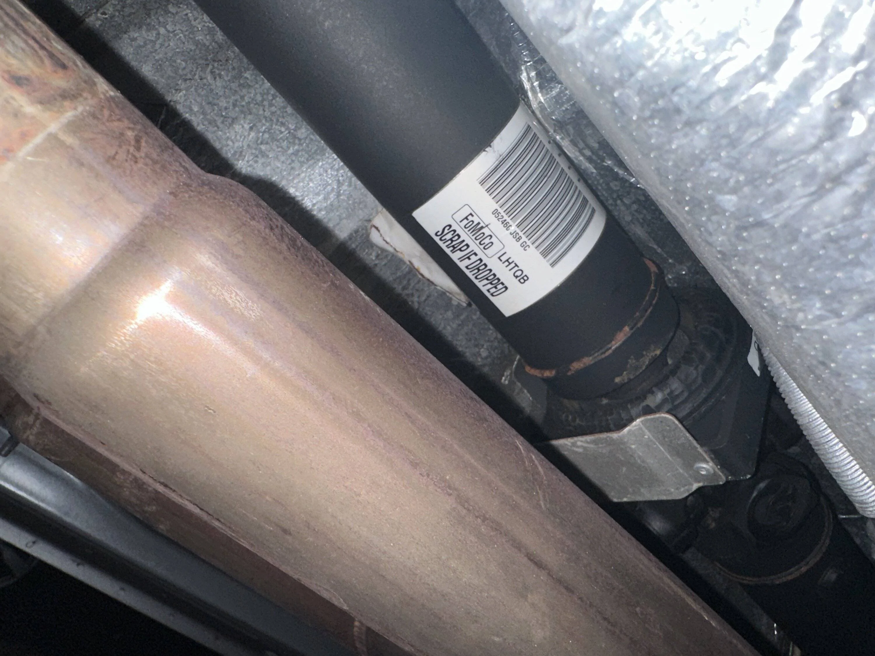

Was driving down the Highway and this sound appeared suddenly. Only audible above 50-60mph and gets louder as you accelerate. doesn’t happen when reving stationary.
i read about potentially tightening the handbrake cable but wanted to see if it could possibly be anything else before i get under there.

Are you sure they isn’t a loose sticker on your driveshaft hitting the transmission tunnel?

Sure sounds like it. Or a loose heat shield.

think you were right regarding the sticker. Half of it was coming off the drive shaft. Pulled it off completely guess we’ll see.
