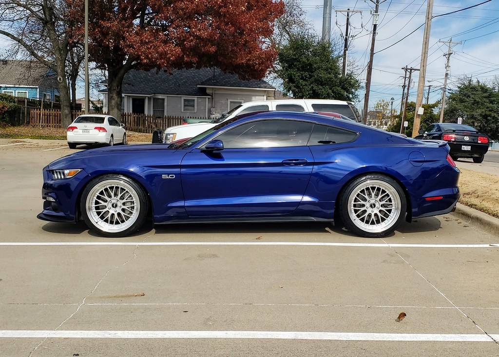

It's basically a rear spring install. They should have that procedure in the workshop manual. Instead of fully removing the spring, they're just adding a spacer on top of it. It might be a little difficult with stock springs, since they will be taller than lowering springs. There might not be very much room to maneuver in the spacer without completely dropping the rear cradle and they may need spring compressors. With my BMR springs, I was able to drop each side by itself low enough to fit in the spacer. My only hiccup was needing to also undo the rear muffler hangers in order let the cradle droop enough, but that wasn't a big deal.
But just for reference, I'm fairly mechanically inclined, and I did it in about an hour and a half taking my time on jack stands in my garage.
