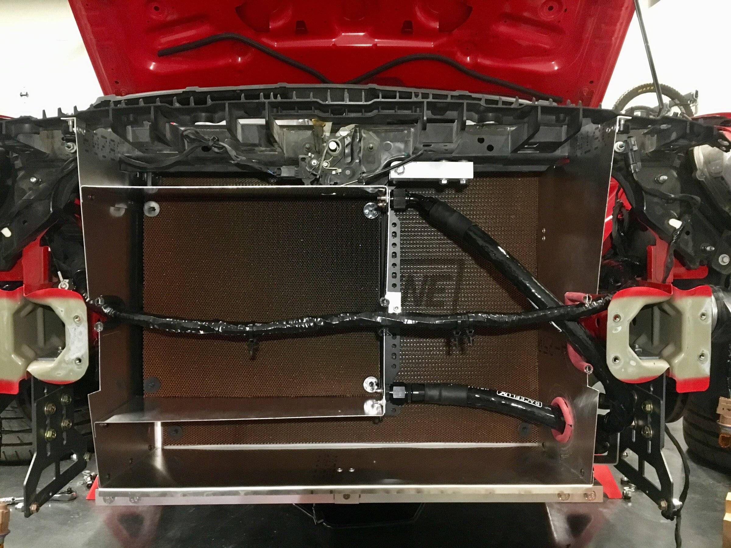

Painstaking process but worth the work. This is 0.040” aluminum and is plenty stiff once bent up and bolted together.
Thank you, this is exactly what I’m looking to accomplish, looks good. I plan on getting started with making a rough mock-up this weekend.

Yeah make it from cardboard templates first and then transfer to your final material of choice.
How's the air under the hood while driving now? I know a lot of track guys struggle with venting the large amount of air that gets trapped under the hoods of these cars and they've started blocking off as much of the grille as possible while still being able to keep the car cool.

I also have a racelouvers hood vent that works well so no issues with hood lift.
