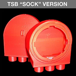

TSB Modified Blower Attachment Now Available
Sorry it took me so long to get this ready to go, but I finally have an attachment that will connect to the newer "sock" version of the blower unit.
If you want to give it a try it's available from my website Darko66.com
A few things of note:
I can't make any claims on how much of an improvement it will make. It should do two things however: allow the fan to perform at it's maximum ability (the sock Ford added to the unit greatly restricts air intake) and also allow the fan to draw assumedly cooler air from the front of the seat.
Since the sock has to be removed from the blower unit, it might be necessary to remove the blower from the seat to do so. It's not that hard to pop off, but you do need to be able to get a good grip of it. I made a brief video that shows the removal of the sock and the install of the attachment. You can view it below.
[ame]
Regarding the video, please note that I cut off the sock from the plastic ring, but that isn't necessary. I'd cut it off while I was investigating before I understood how it was held on. Also note that video cuts off at the end while I'm commenting on the cable tie hook. I was just saying that I added the hook so that a cable tie can be added to hold the attachment to the blower. It isn't required as the clips hold it on securely, but I thought it wouldn't hurt to give it a little extra hold to minimize vibration.
Once the sock is removed, the unit doesn't have any kind of screen/filter to keep dust out. I've added a very coarse aluminum screen to keep anything large from being drawn in, but dust will be still be drawn into the blower and seat. What kind of long-term effect this might have I don't know. If you are concerned about this, I'd recommend adding something to the intake hoses to filter the air.
Beyond the removal of the sock and the snapping on instead of screwing on of the attachment, the install is the same as the original.

Sorry of my ignorance but, this will attach to the fan in the seat back correct and take the sock out of the equation? I'm about to order a set and just want to make sure I put it in correctly.
Darko66
Jun 1, 2015
112
120
Phoenix
2019 Mustang Ecoboost
Yes, sorry, I might not have made that clear. The sock comes off altogether and the attachment snaps on and then you add the three 3/4" hoses to the attachment like shown in the instructions for the original attachment.
Cool thats what i was assuming but, I would rather ask just to make sure. Thanks again man! Cant wait to get the part in to fix this issue.
