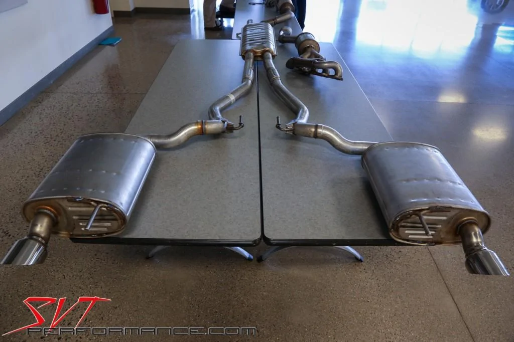

And you sir are correct :eek: Big Ass Chamber Muffler
All the cars are getting that massive chambered muffler. Now I know that an X-Pipe might be in order. The good news is it appears the exhaust made it front to back without too many crimps and dimples so a mid pipe and mufflers will make changes easy. All you need is some band clamps and a sawz-all :)

And you sir are correct :eek: http://www.svtperformance.com/?attachment_id=3132
I still think it will differentiate Manual vs Auto. This was the DIB GT at Barrett Jackson.
See this is why I get pissed, so much different info. Then the question becomes is that just a car for the auction they built or how it will come off the line. I guess I will just wait to crawl under mine.
