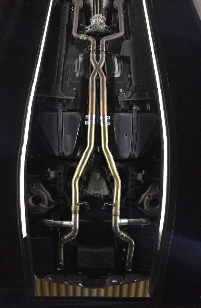

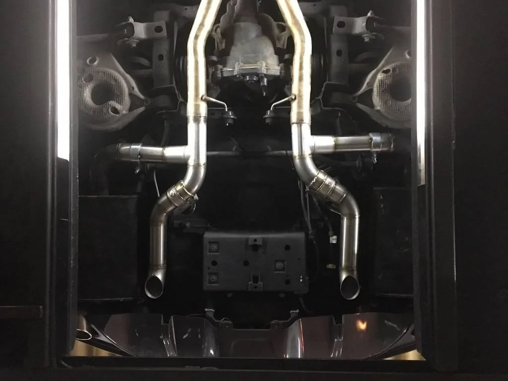

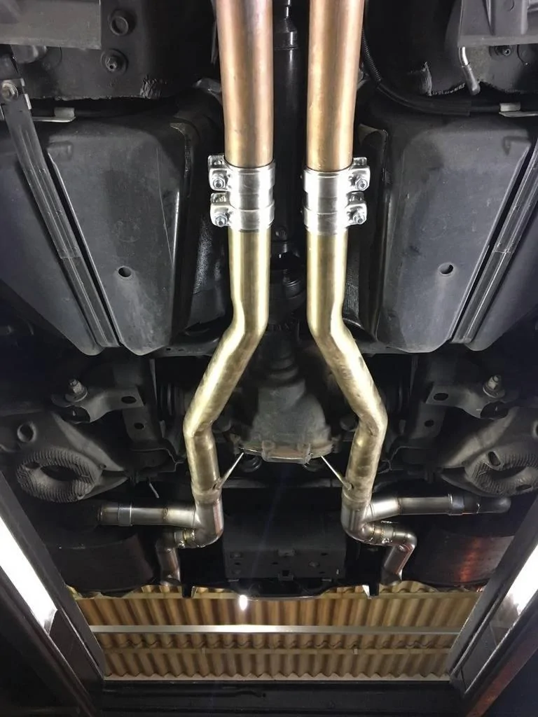

I have a fully custom switchable system from a company called Guerilla, and its brilliant.
I had the system made up by Guerilla here in NL, but they will also sell you the valves seperately, and the exhuast cutting can be done by any experienced shop.
http://www.guerrilla-exhaust.com/en/
My system:
Cost me about 1800eur all in... which obviously isnt nothing, but about 1/2 the price of a full Roush system.
I think the Roush exhausts are very good value, but they are taking the piss asking $2k for the active controller.
