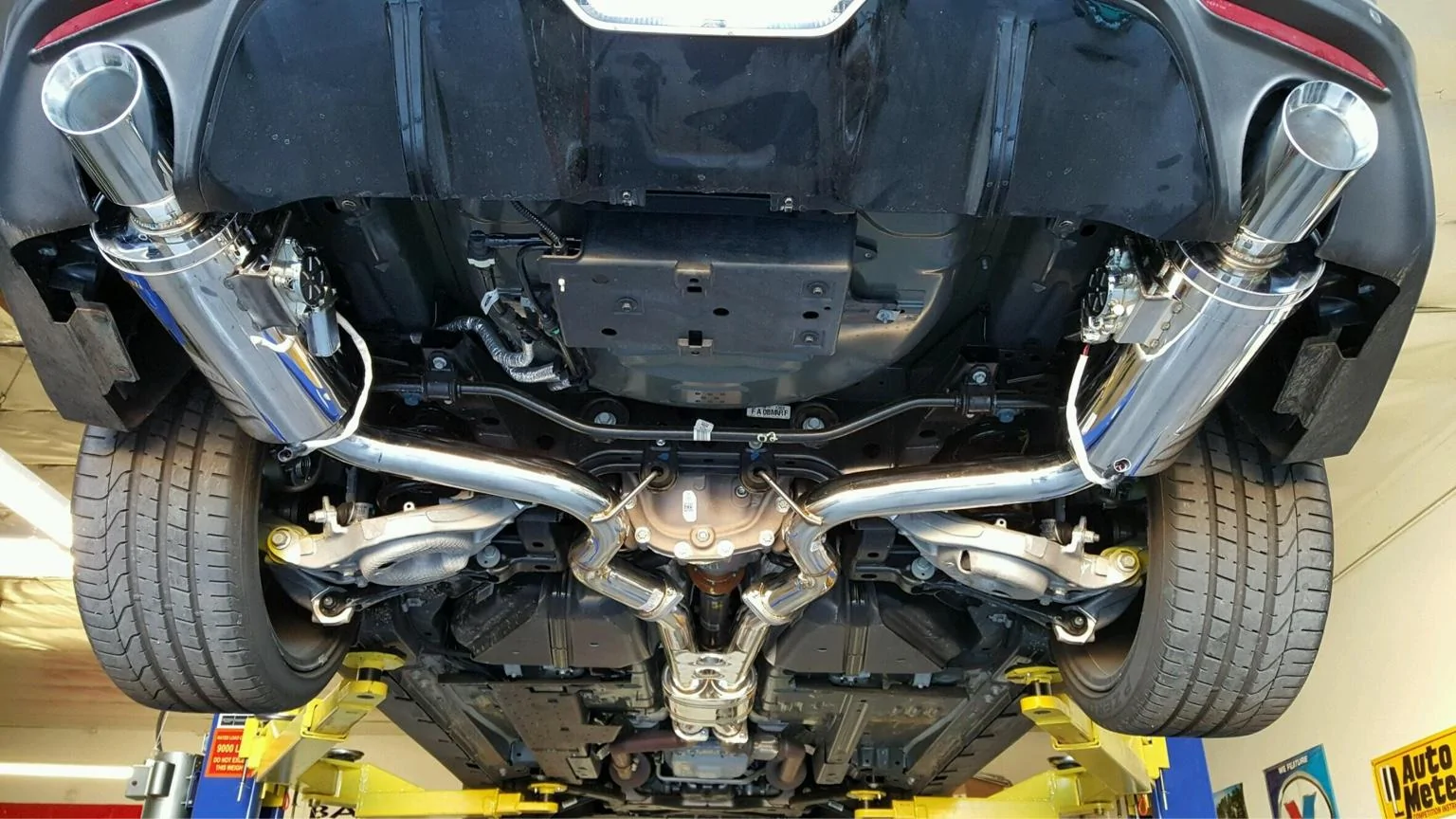

I don't think the install is supposed to look like that with clamps showing as they are in the site video. The OP from this thread has this image of his setup which imo looks pretty nice.
Regarding the sound when closed, I am pretty sure the flange is fully variable and you can set it in between at different levels. So you would not have to keep it fully opened or fully closed. I could be wrong though.
