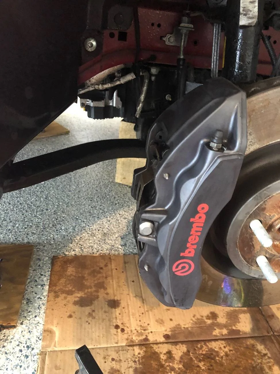

before I put it all together after some servicing my e brake has a little play in the handle . It does not look like the post s I ve seen with the bolt with the nut. It s kinda al sealed and I can see 2 cables come out to rear. There are some springs and stuff I don t know about on the caliper. If anyone has a quick answer and picture please post . Brake fluid, Oil, cleaning caliper, checking brakes.... Thanks

Got it. FYI, Is is like the pictures other than the pictures are a cut away. You can t see the nut, just a hole to put the socket thru. I was able to turn the nut without using the wrench, just the socket and long extension. Now the light comes on in two clicks instead of a few inches of play first.

Adjusted the e brake, oil change, brake fluid change, checked brake pad life, clean calipers all together.
