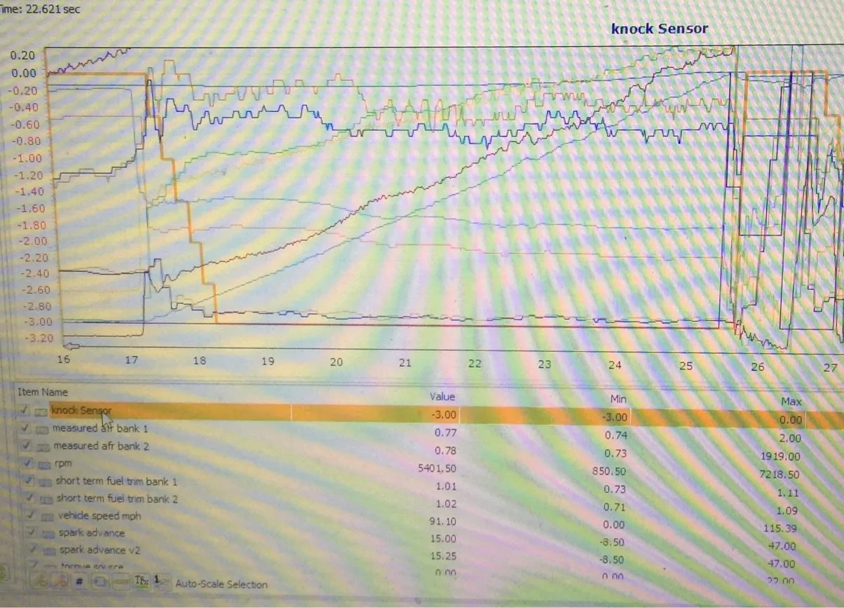

Questions on my datalog from last night
christian
Happy Member
Jul 12, 2015
264
71
Bellefonte, PA
2015 Guard GT
Beefcake special with jlt and 3.6 pulley
4th gear all readings at wot
Anything look off?
Knock afr bank spark adv 1 spark adv 2 Speed rpm
-3.00 .776 14.5 14.75 114 6800

Need to see the whole log. That only tells a snippet

heres a pic starting wot...prolly wont help lol
Nope not at all -_-
PM me the excel file if you want or see what they say.
Mainly you want to look at lambda. That's fuel and make sure they stay close to each other but not over .82 and holding.
KockR is timing advance or retard...detonation shows as positive and additional timing is shows as a - value
