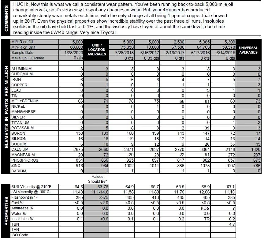

I'll post my latest oil analysis from my 4Runner. It originally showed back in 2015 that there was higher sodium reading than what would be considered normal. Sodium means coolant...not good. I put in a couple radiator tablets and that seemed to do the job. I don't know if it has a leak or if it was something residual from the previous owner's maintenance. Analysis was able for me to see what was going on and correct the issue...hopefully for good.

Interesting that your doing this for your 4Runner. What about your Mustang?

I have only done one oil change on the 5.0 and have no idea what oil was used by the previous owner: weight or brand. I plan on it next time, though to see how the Mobil1 5w30 performed.

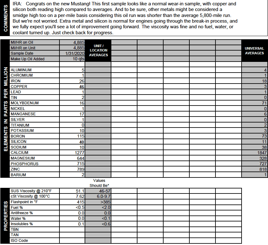

Good report, so you have a baseline.
Really important, no fuel, water, or antifreeze! For me that part was really important.

OK, so got mine back this morning. Nothing to see but it was good for my peace of mind.
