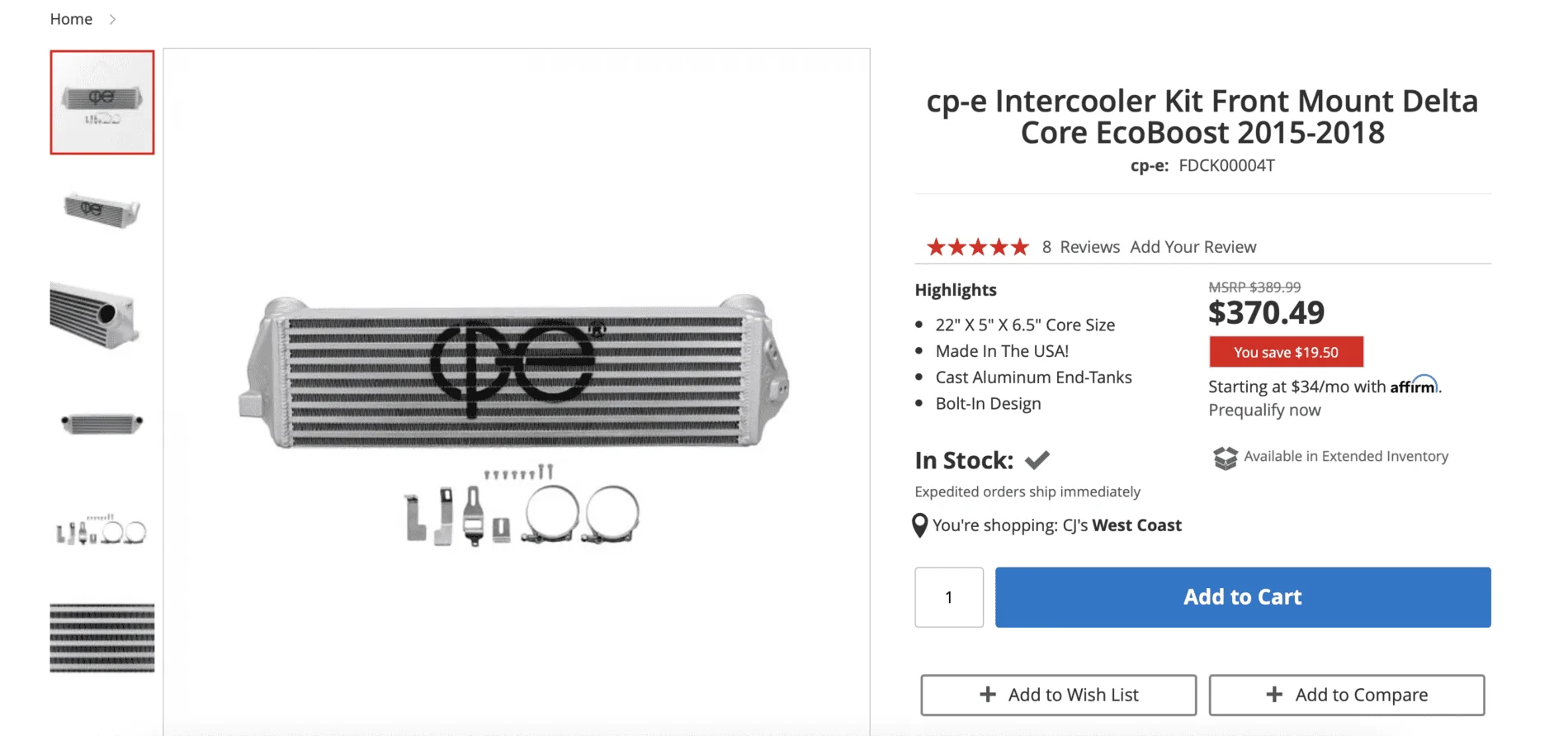

That CPE says 2015-2018. Will it work on my 2020?
yes. all 15-21 are the same.
you'll see a lot of parts that won't list 19/20 just because the listings never been updated.
oh, except fender extension plastic pieces, under hood. those are 15-17. thats due to hood redesign/headlight change.

I've been bouncing back and forth for a few days with all the options. Pretty sure the CPE is out of stock everywhere I looked though, and the CVFAB looks like it requires charge pipes for fit. Need to keep researching....
its in stock at cjpp
id try and ask for a 5% discount.
