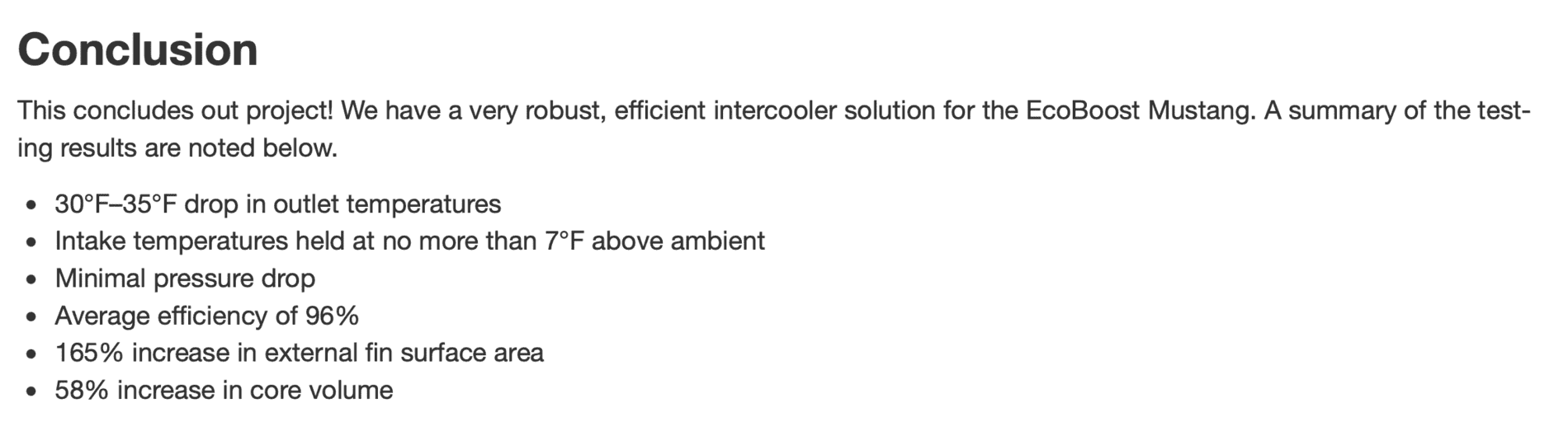

hey here you go. mishimoto, they provide original size, and theirs, and testing etc.
part 1
https://www.mishimoto.com/engineering/2015/01/the-mustang-ecoboost-intercooler-part-1-stock-cooler/
part 2
https://www.mishimoto.com/engineeri...ost-intercooler-part-2-prototype-fabrication/
I can't find part 3.
but here's part 4
https://www.mishimoto.com/engineeri...atedposts_origin=2570&relatedposts_position=1
part 5 (testing)
https://www.mishimoto.com/engineeri...rt-5-finished-product-and-final-testing-data/

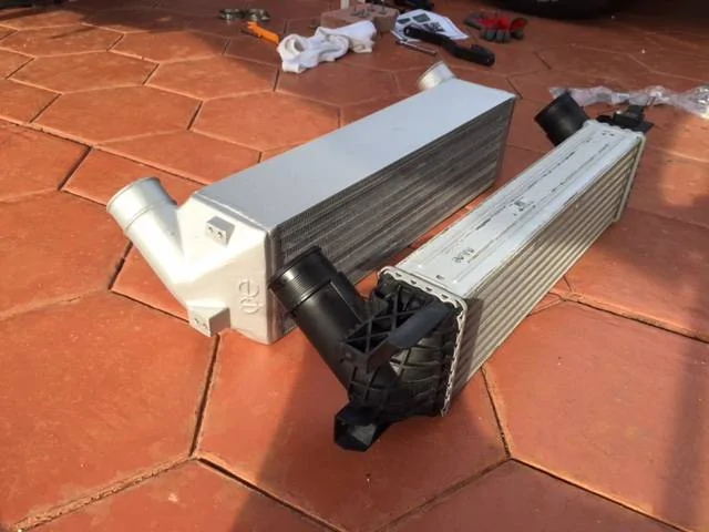

below is a pic of what I have, CPE vs oem. (someone else's photo) but I like it. mishimoto is prob similar size. as they both utilize stock area.

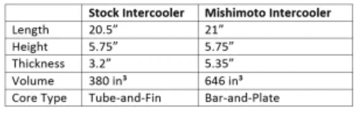

you being a tuned ecboost (HPP) you will even see larger benefits, this is from stock tune. I am Ford perf tune, same as you basically, and my car really likes the cold air.

A large difference is oem is tube and fin, aftermarket is bar and plate. google says bar and plate is superior in terms of efficiency cooling then add the larger size, more rows etc.. almost double the cooling in size alone before bar/plate factor
