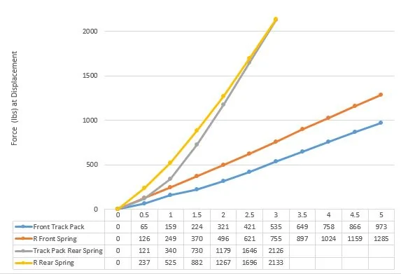

Do the R Springs really change the ride that much?
They change the ride dramatically.
Also even though the R and track pack rear springs have similar rates they don't work the same.
The track pack ones are more progressive. The r ones are more linear

Spring Rate Comparison
This is the data from my 2016 Track Pack Springs vs. the R Springs.
Data is courtesy of the folks at Vorshlag, purveyors of most excellent camber plates.
The R rear sway bar is 1/16" larger diameter.
