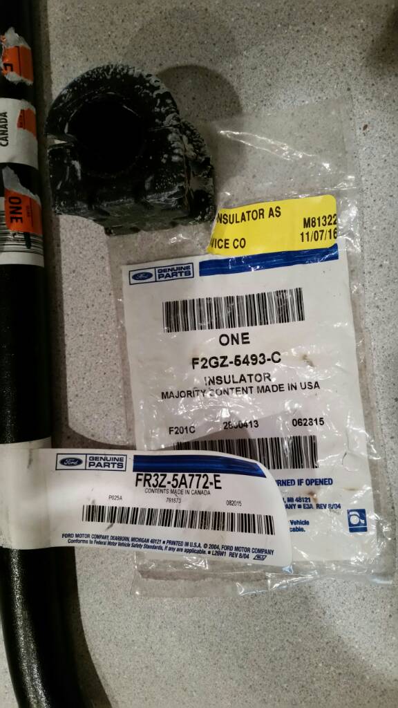

As mentionned in another thread (question about R springs) I'm considering upgrading to R components to improve handling on the track. I will definitely order the 4 R springs. I'm also considering R sway bars. From what I've been able to gather the front is the same between R and non-R, correct?
For the rear, I've seen different p/n
FR3Z-5A772-G (R?)
FR3Z-5A772-E (non-R?)
When I look at these parts on fordparts.com and other parts site, the E comes up as w/o magnaride and the G w magnaride (or reverse I dont remember...). So could it be that the rear sway bar is the same between R and non r and the only difference is w or w/o magnaride? Confused!! maybe someone with an R model can enter his VIN and it should show up the correct p/n?
