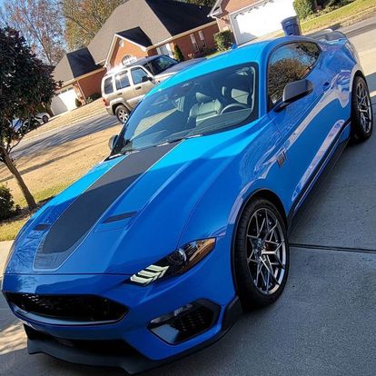

Hi, I have a Mach 1 handling pack on the stock HP wheels right now. I was thinking of going 19x10 squared with 285/35R19 but I'm curious what offset I should run considering the handling pack has the fender flares.
I've seen a lot of recommendations for +35/+40 but this seems to sit flush with the stock fenders which might look weird on HP fenders. Would I run into issues running lower offset like +25?
Also outside of the visual concerns would running this cause any serious performance changes?
