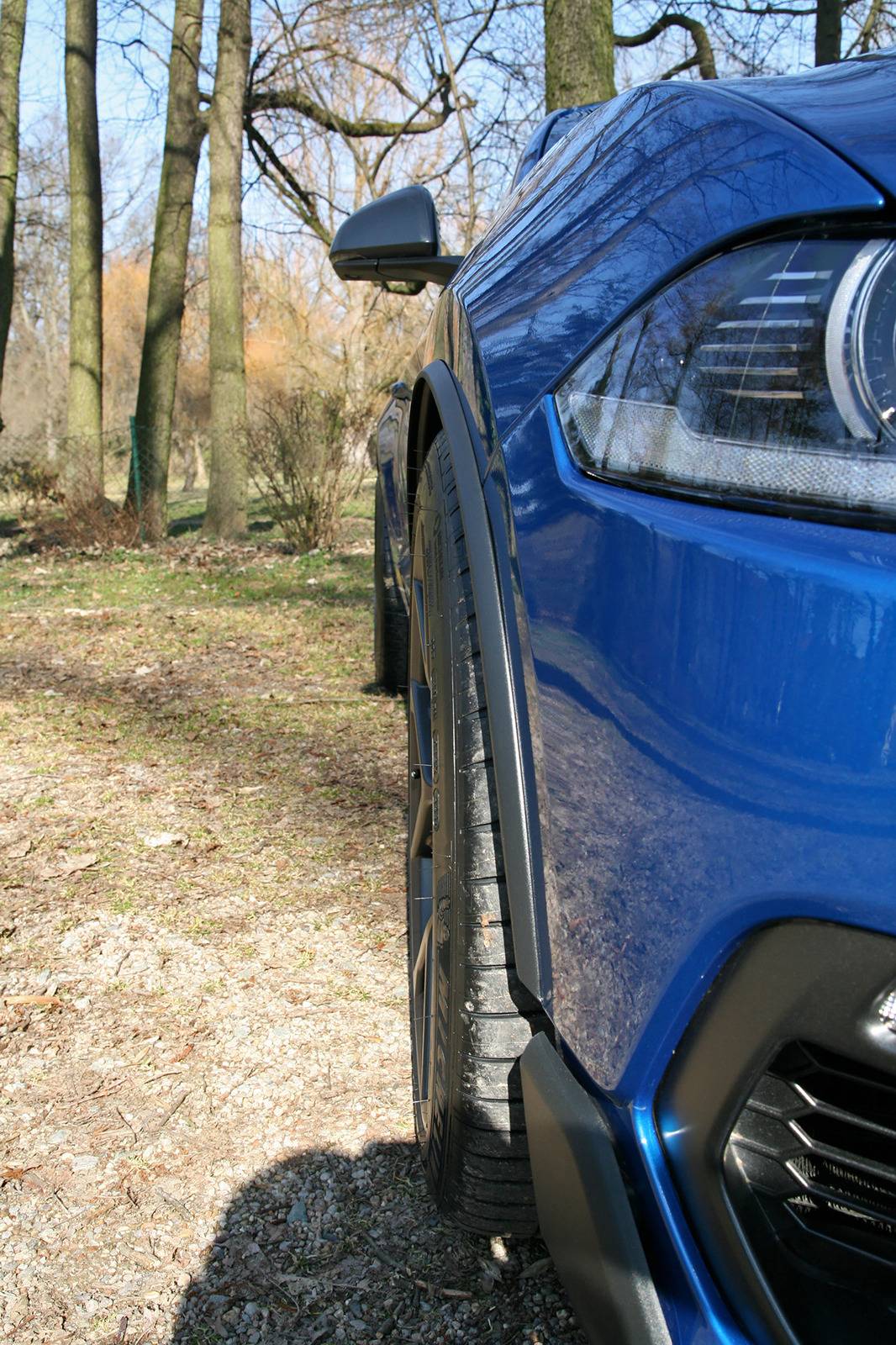

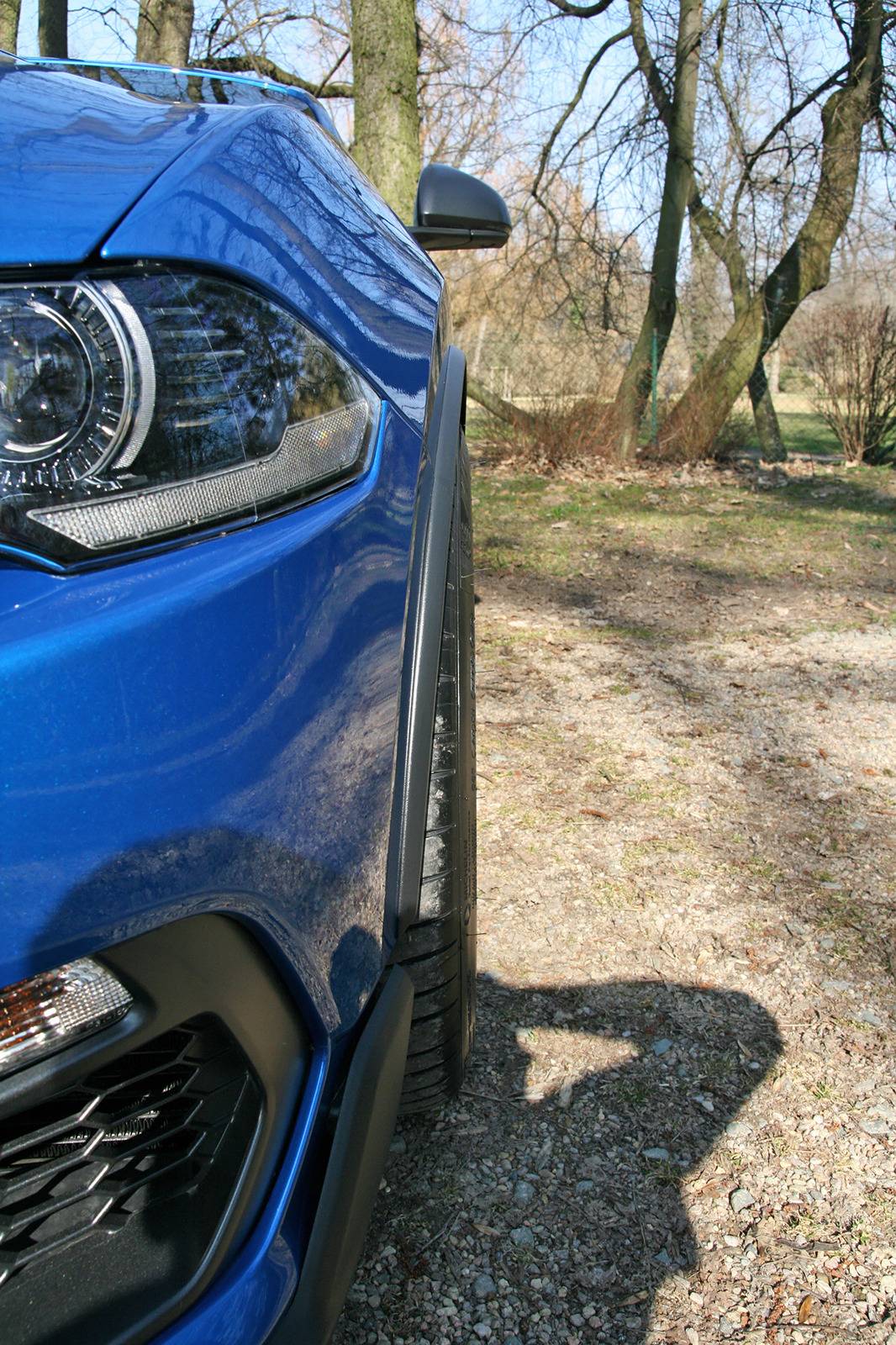

These are 10.5" Ford wheels in the front, they stick out quite a bit.

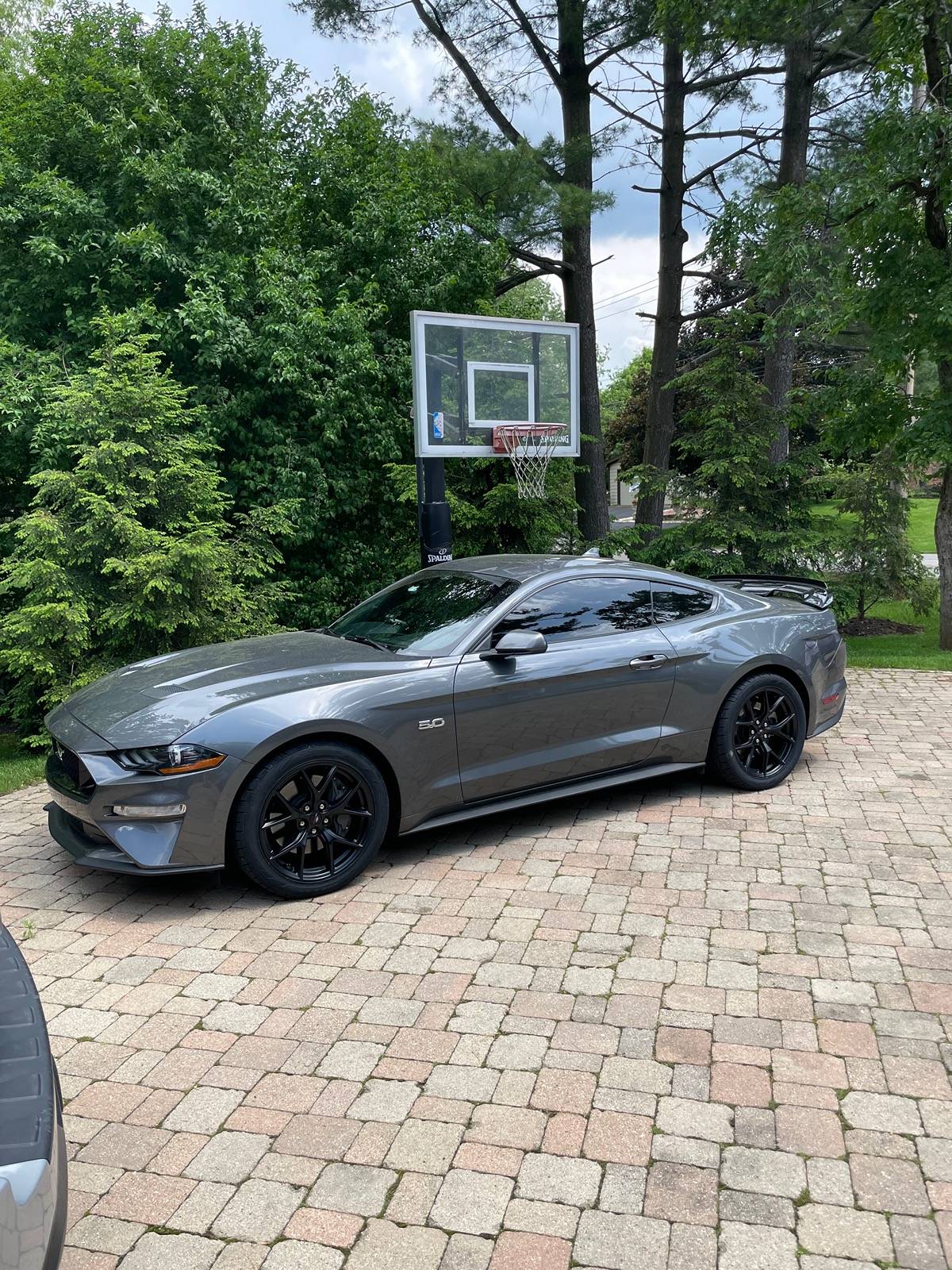

This is how that setup ended up looking
