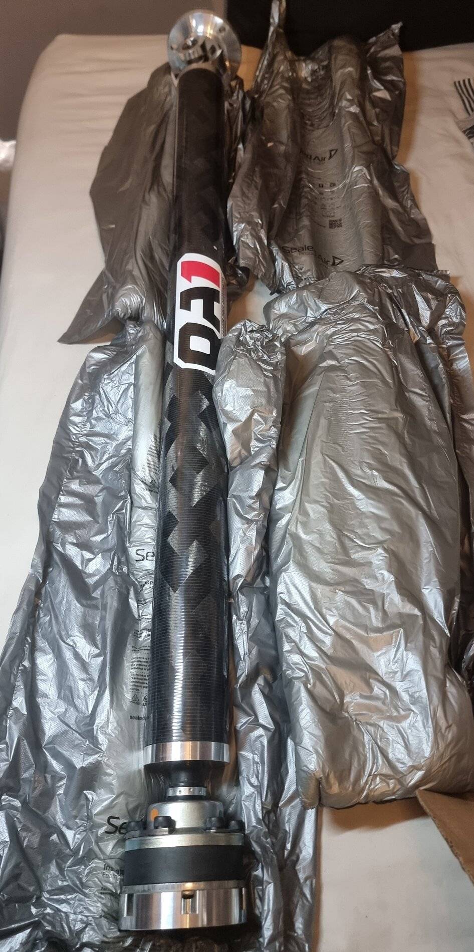

Sorry to see that. I can only imagine that you had quite a wait to get it too. That’s crazy that they didn’t do a better job of packaging the driveshaft. I though most ds manufacturers shipped them inside of a super thick round cardboard tube that was almost indestructible and then put that inside of a box like the one yours came in for extra protection. Apparently, some manufacturers are doing things on the cheap, although what they charge for the product isn’t cheap.
Can the damaged adapter be replaced? If so, hopefully you can get them to do rush shipping of a new one to you since they should Have packed it in a way to prevent that. Then again, I wonder if the banging it took could have also compromised the carbon fiber. Maybe it’s best to just ship the whole thing back and request a refund.

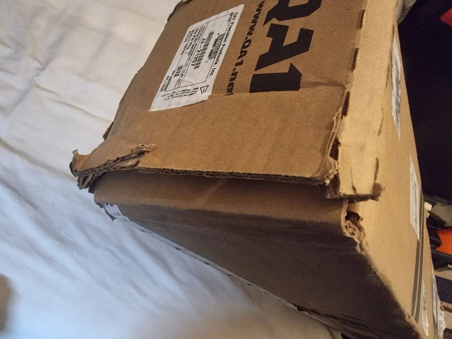

I paid extra for the SFI approved driveshaft, so it's been calibrated/tested, I also won't know whether the carbon itself has been weakened until it shatters.

CJPP are speaking to QA1 to see if it's still usable, I think they want to try to offer replacement parts and a partial refund. I'll be wanting a full replacement or it's getting returned, I suspect the manufacturers warranty may also now be void too.

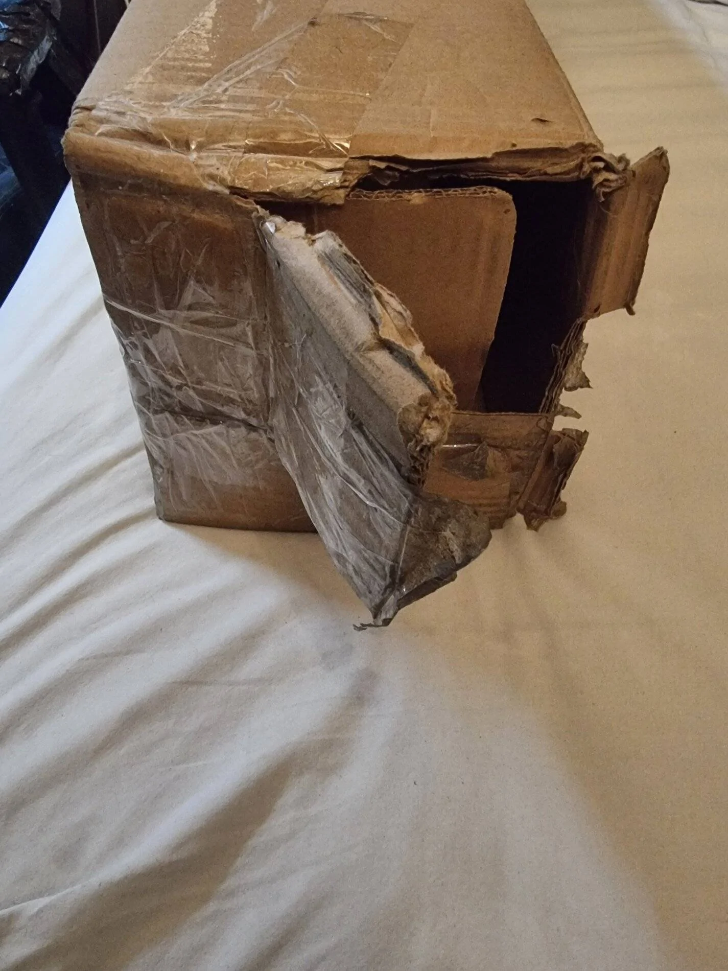

It wasn't really that well packaged either

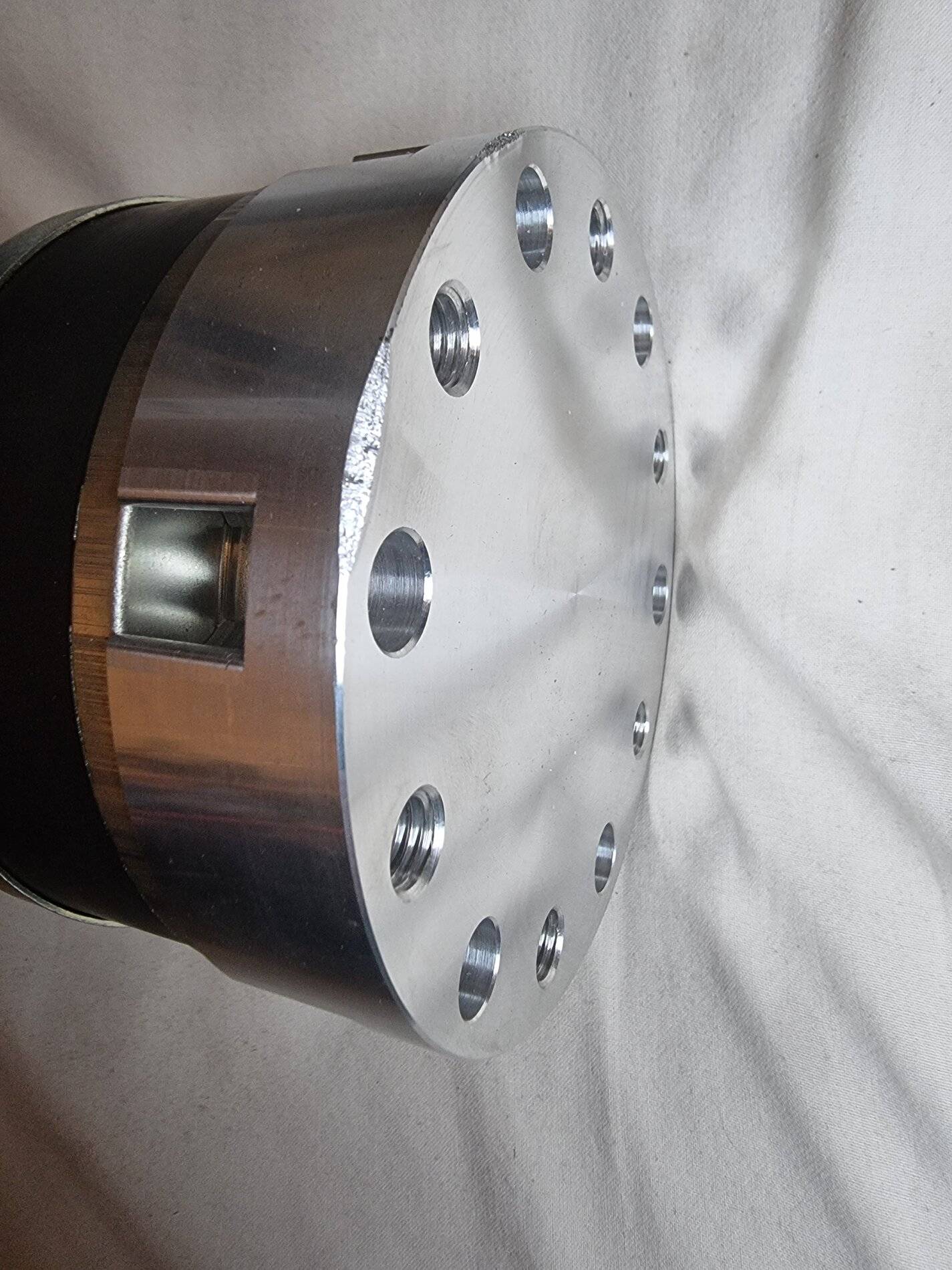

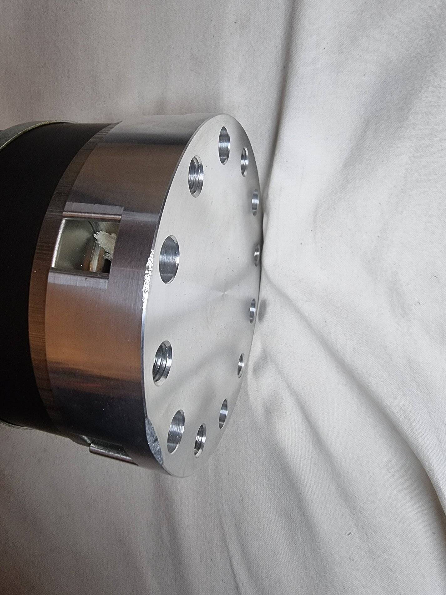

I think it's fine to install. The dented part sits inside the diff pinion flange so won't really have any issues with balancing. Just file it with a fine file if you need to and you will be fine.
Id be over the moon if it came like this, 100% useable and could potentially get a good amount of refund or even for free!
Install it and send it.

So the dented part is fixed in place and won't cause issues filed down but it would if it was replaced. Would you not be worried the carbon has been weakened by the impact of being dropped ?

Yes. If the part is replaced, then the balancing you have paid for won't really be worth much. Keeping what you have is your best bet.
Check out my install video of the DSS drive shaft. Fast forward to have a look at the diff pinion. It will literally sit inside it and the diff pinion flange will over lap it externally. The dss had an adapter that was installed inside the pinion first. Yours won't have that step.
I would buy a metal ruler and run that on the mating surface along the dents etc and make sure they are flat. If not file down. Same with external just run your hand sound the de ts to make sure it's not protruding out of its factory envelope and file down if you have to.
The impact would have been taken by the metal. The carbon seems to have been wrapped with foam fairly well and could be damaged at anytime during shipping even if there was or wasn't visible damage to metal adapter.
There is always an element of risk when doing this install but from what I see. It's not an issue. Check the carbon visually and if it looks good, you'll be fine.

The drives shaft slid out the box because the foam wasn't very strong. You can see the packaging was taped back up by the courier.
If no visible marks on the carbon. You are good to go. I would never give anyone advice I wouldn't follow myself. One thing you could do is buy a drive shaft safety loop for added peace of mind.
