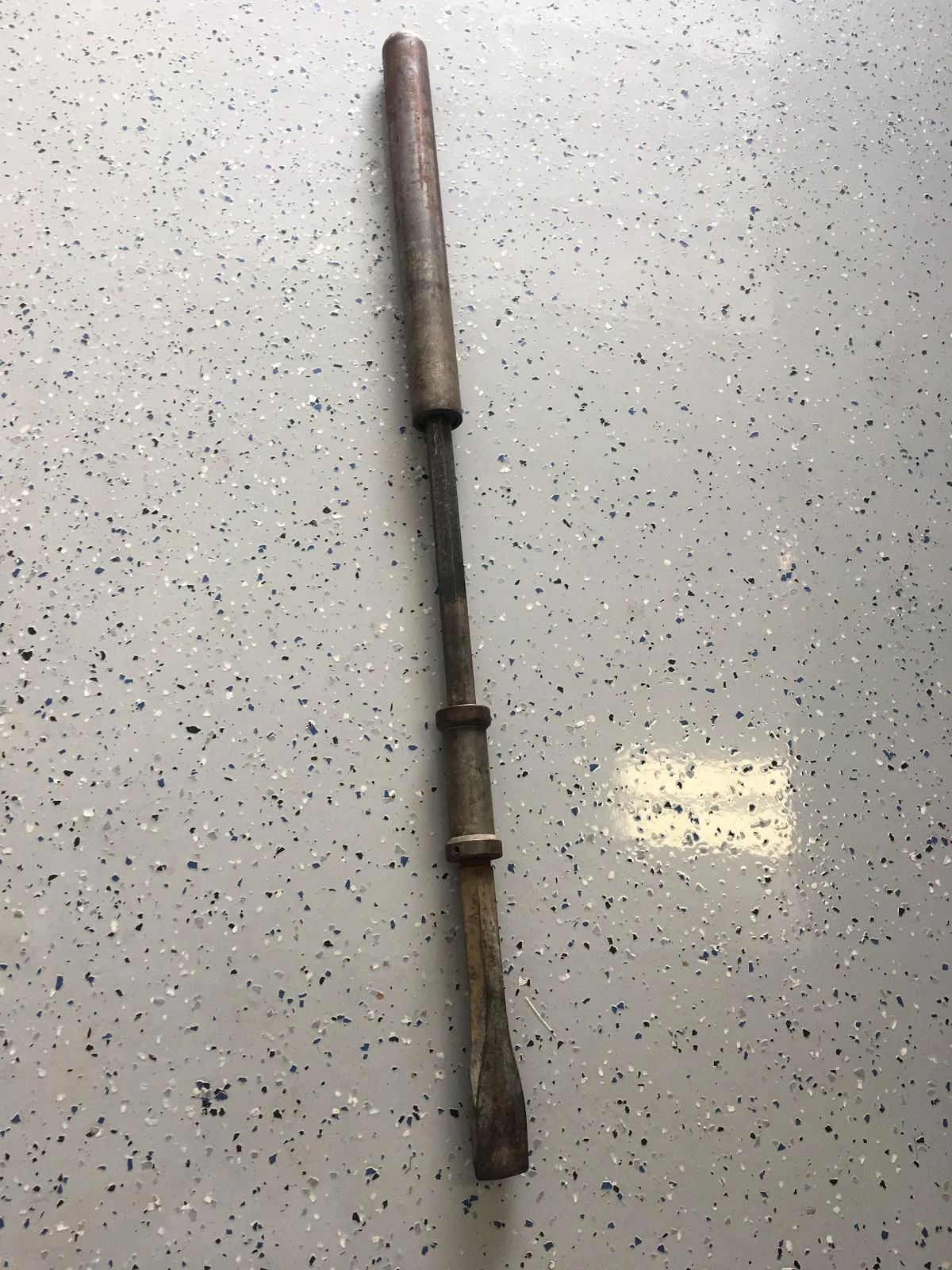

Slide Hammer for sure !
For those having trouble popping half shafts out of differential, there is a little trick to it.
Everyone in the videos say pry it out with pry-bar against diff housing and metal housing of half shaft. On some models you can pry all day and even use two bars and axle still won't budge. On a GT350 I almost broke my 4ft pry-bar, still no luck.
The trick is to use a blunt force. This will cause the inner c-clip to release.
I used a "Tire Bead breaker tool" (Pictured) I positioned the flat end on the half shaft metal housing and gave a gentle slide-hammer with tool, and it popped out right away.
Actually, the guy who said use a long 1/2" extension and big hammer was pretty good advice for those who can't get ahold of a slide hammer device.

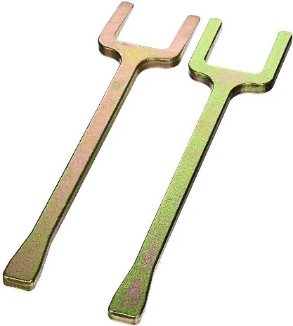

Trying to pull my half-shafts on my R, but they don't to want to come out of the diff.
I've watched all the video's online but mine won't come out that easy?
Any help?
Thanks
I used a slide hammer axle fork super easy.
