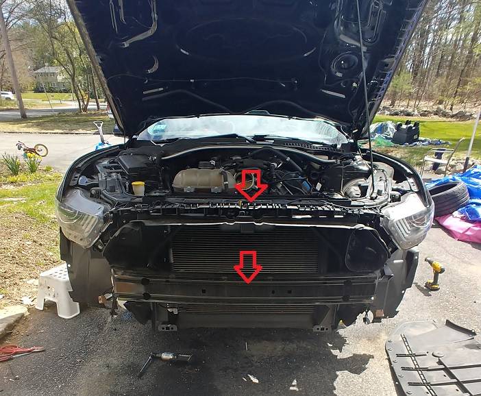

I'm getting ready to pull the engine and trans out this winter and due to my limited garage space (especially up) I was trying to figure out if the engine would fit coming out straight forward. I was going to remove everything in front including the crash bar and upper tie bar and then wheel the whole setup forward on a rolling cart.
Anyone do it this way?

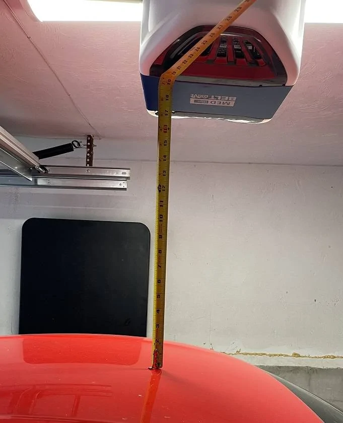

How much do you have to lift the body so the engine clears and can be rolled forward? I only have about 19" clearance above the roof of the car before it hits the garage door opener. I can remove it and gain another 6" but that's about it.
