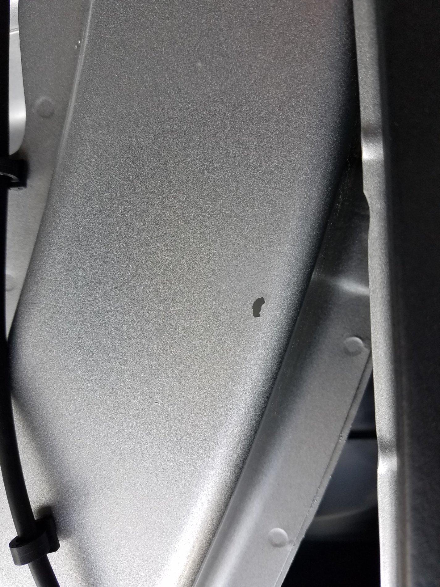

I'm having an issue where the hood underneath is rubbing on the reinforcing struts.
