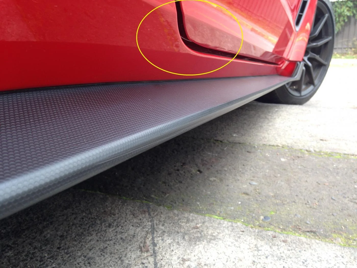

I noticed this over the bottom of my passenger door.
Are you referring to something looking like this? The door is closed in the below pic. The door edge sticks out a little bit.

No, mine is pretty much the exact same issue Cobra Jet linked.
