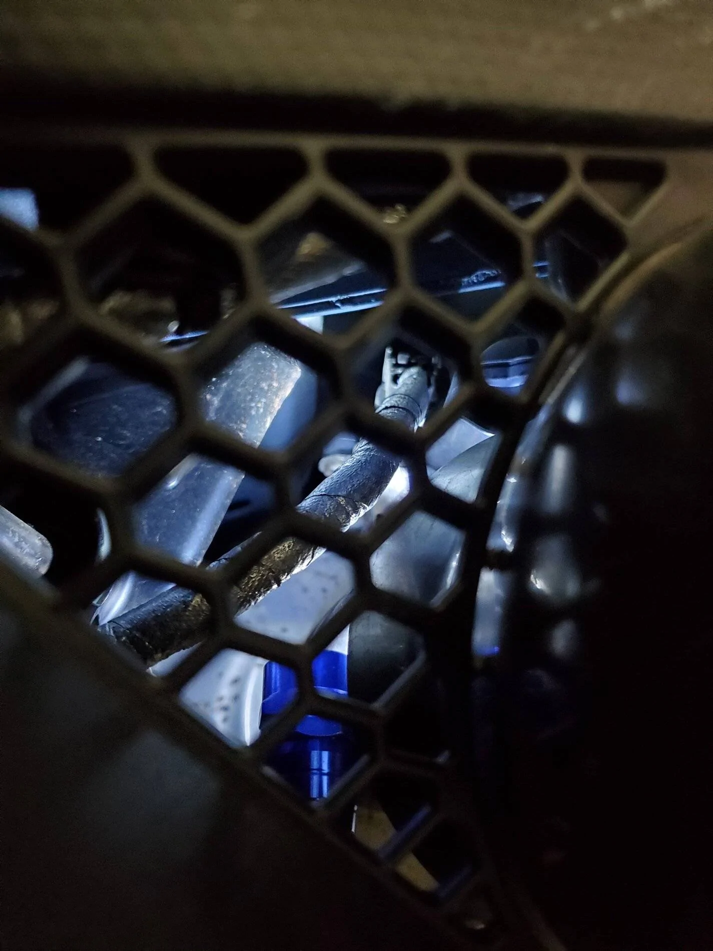

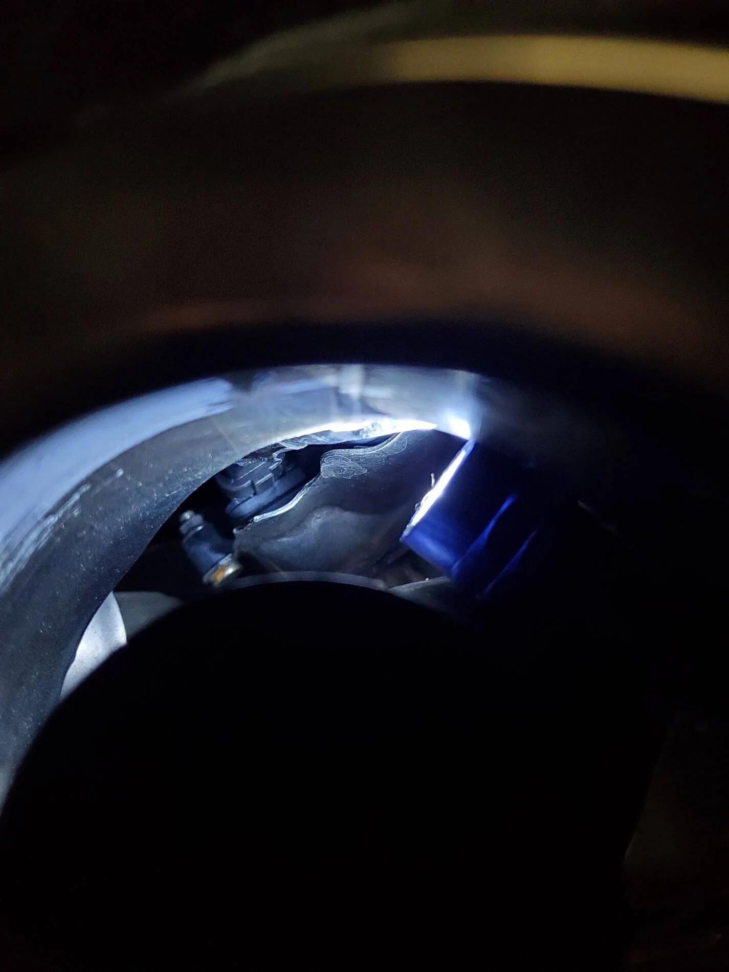

I just went out and checked mine. My valves are open a small amount. If you take a bight light and look thru the honeycomb on the right side you can see if the harness is plugged into the valve assembly. On the left side you look up thru the exhaust pipe with the valve and can see the plug on that side. If it has a grimmspeed module there will be no harness connected to the valves. Dont know if this will help any.

BINGO! We have a winner!
The harnesses are not plugged into the actuators. They are looped over something and held tight with a wire tie. There looks to be just the open plug port so what was done to deactivate the valves is still a big mystery.
Great call man. Now the process begins of identifying what product is where?
