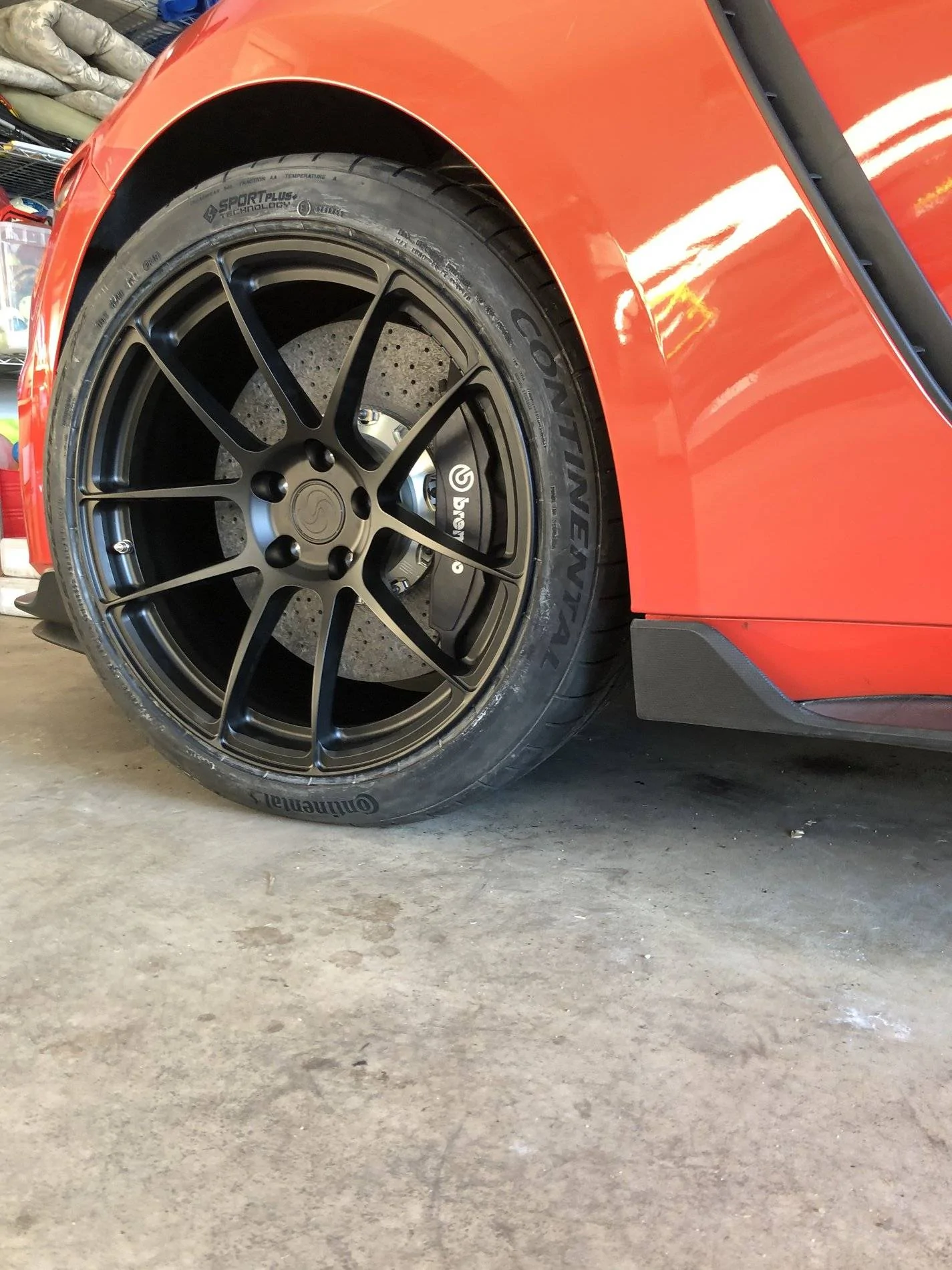

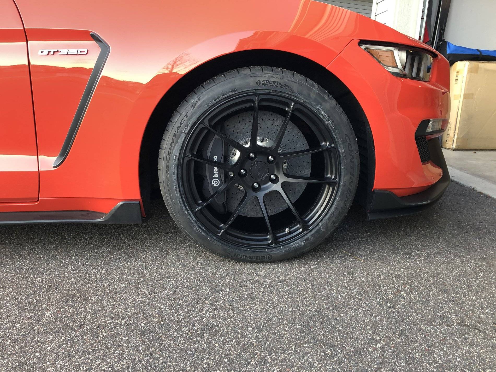

So spring and Covid gave me time to move forward on making this car feel more nimble. Track oriented gearing and power at higher revs in a 3700 pound car has its negatives darting around town in day to day driving.

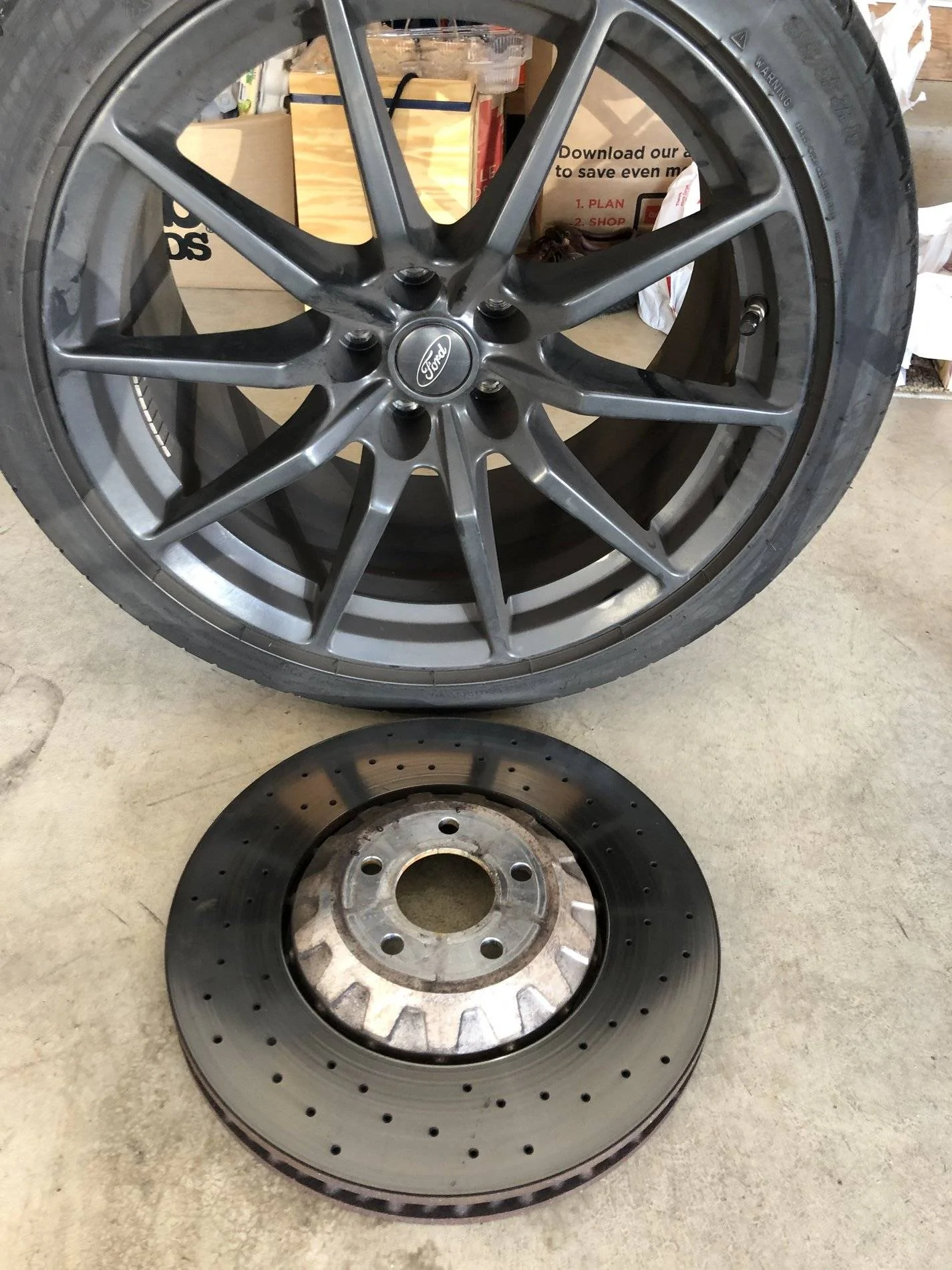

Losing these anchors:

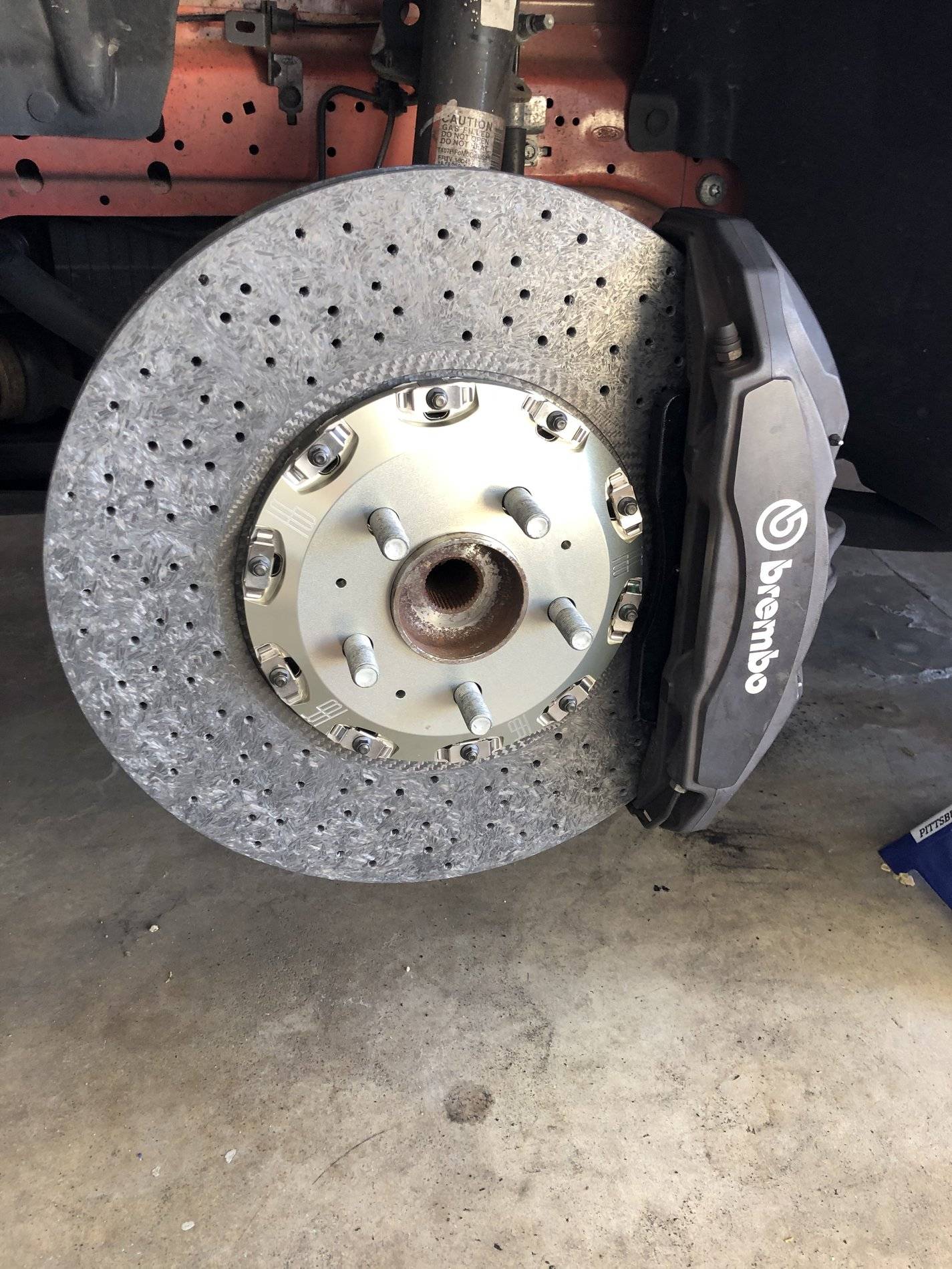

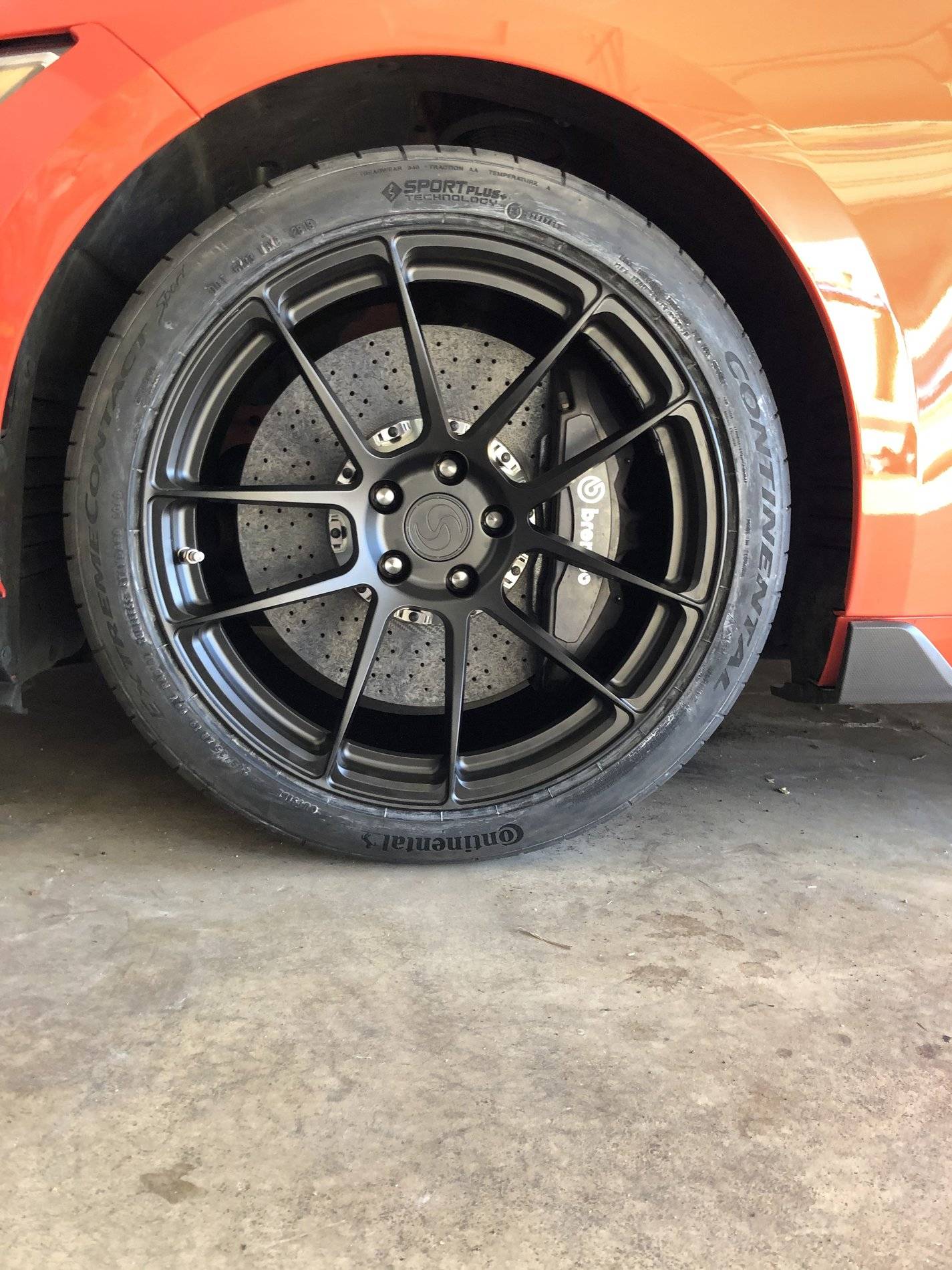

Replacing with these:
(was shocked how heavy those iron rotors are!)
Didn't go with rotor change for back wheels, just under 7 pounds saved per rotor wasn't enough to justify cost. Already did enough mental gymnastics to justify money spent on the SV502s and front rotors/pads.
Did some light driving when done, apparently need to do that for a couple hundred miles before bedding the ceramic brakes.
First thing I noticed was lighter steering feel. Always drive in sport, love the heavier feel in general. I hope I adjust to the feel over time. Immediately got me on the forums trying to figure out how to add some weight back to the steering with other mods. Doh!
Anyway, once I get some more time and let her loose a bit more will report back.

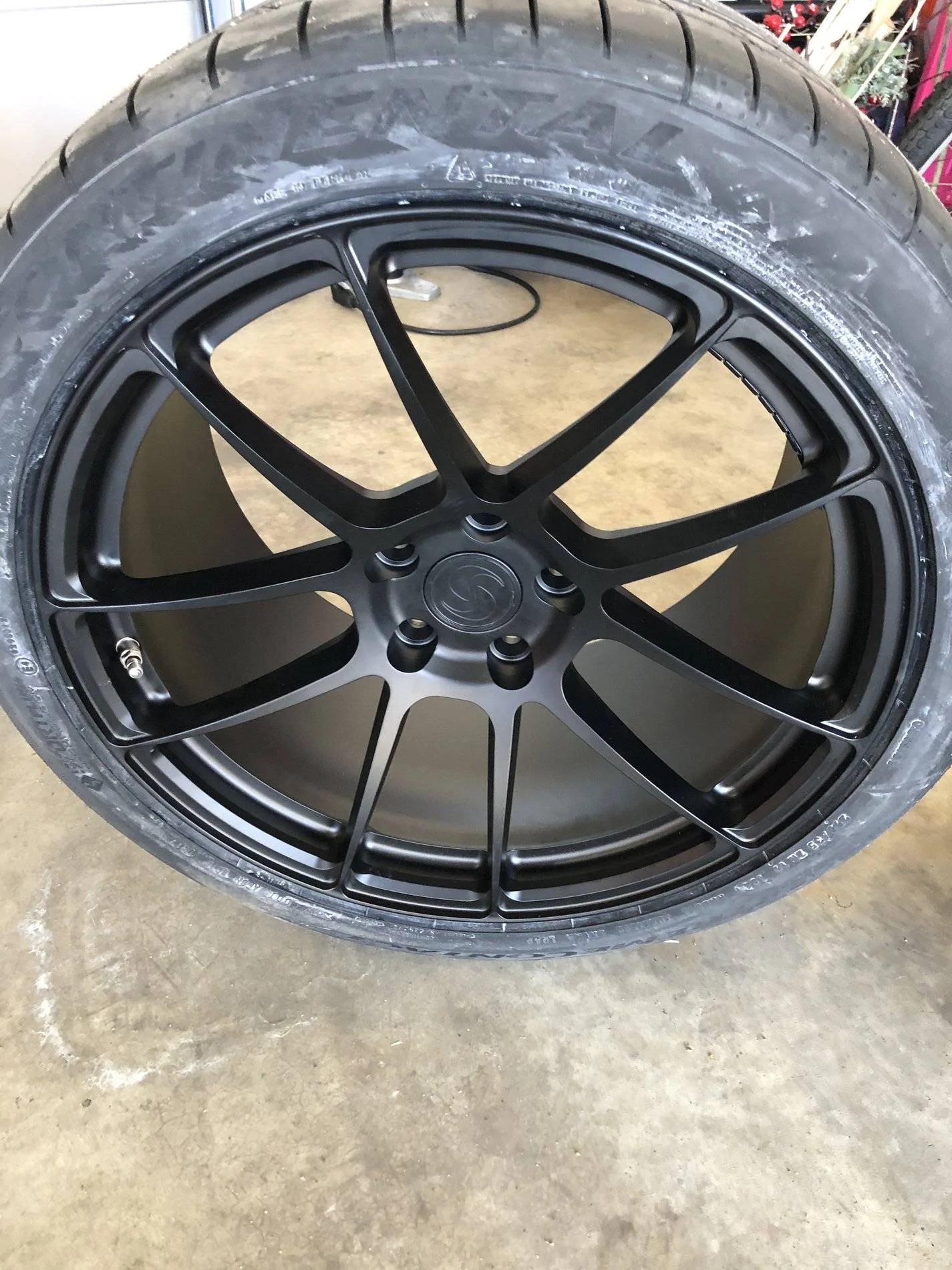

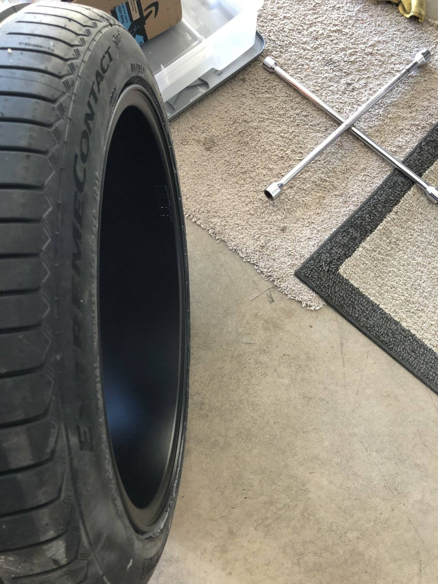

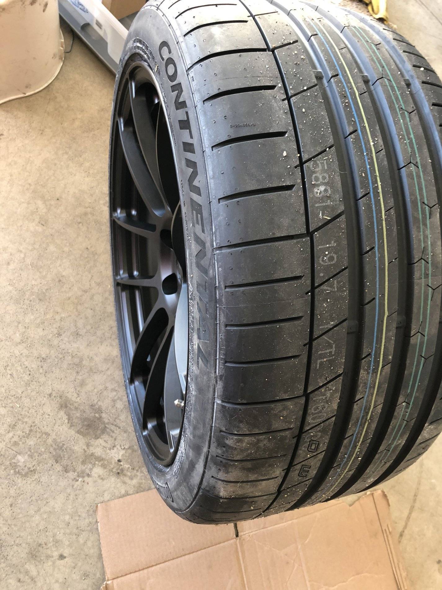

Went with extreme contact sports. 295/35/19 in back, 285/35/19 in front. (oem staggered non-R wheel size in the SV502)) Did a lot of research on sizing, measured widths on tire rack, and finally decided to go a bit smaller than OEM after reading Billy Johnson's article on sizing and handling. They fit perfectly, better than the stock supersports which always look like they don't quite fit right.

How much weight did those rotors save? Also, how much lighter was the new wheel and tire combo? Looks good.
MNGT350
MNGT350
Nov 26, 2017
185
168
Minnesota
16 GT350 base comp orange
Rotors roughly 16 pounds each side. Wheels around 9 or 10? Didn't weigh the tire/wheel combo. 50+ pounds off front rotating mass, 20 off rear. Conti tires a pound or two lighter than PSS I think too.

I was looking at carbon ceramic for the 500 that's coming. Current prices are expensive. What did the rotors set you back?
MNGT350
MNGT350
Nov 26, 2017
185
168
Minnesota
I got them through Tony Brakohiapa at TBR performance. 4500 front only, with pads included. His are only GT350 sized I think. (same ceramic rotor as ZR1/Z28/McLaren, but with GT350 specific hats). I think it's over 5 grand from racing brake for their GT350 spec.
FYI, Ceramic rotors are 2600 if you buy the GM version through AC delco online, but you'd have to come up with a solution to the hats.
I know racing brake is doing GT500 carbon cermaics as well, there was a thread about it recently here, might be on their site.

Yeah, it's a lot of weight off. On some initial mild driving, really lighter on turns. Steering feel lighter too, but I'm getting used to it. Do wish I could just dial up the steering weight on a knob or something, now that there is so much less rotating mass to turn.
I think over time I'm really going to like the change in how the car feels, will see how goes once I start pushing it some more on back roads.

Excellent work with the upgrades. Carbon ceramic rotors are in my future for sure.
OEM GT350 wheels = 33 lbs
Signature Wheel SV902 = 20/21 lbs
roughly 48 lbs lost on the wheel upgrade.
