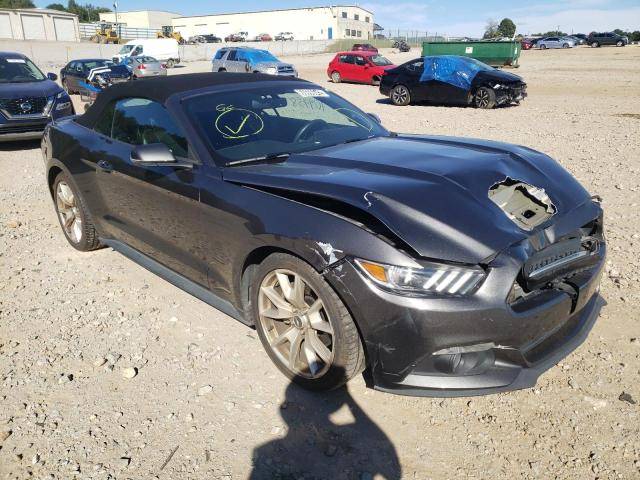

I have been driving my 2015 mustang 3.7 convertible for a few years no. I like it a lot!
last week I bought a project car from copart. Importing it to the Netherlands. I Will post the Progress in this group. It Will be a daily for my wife.
