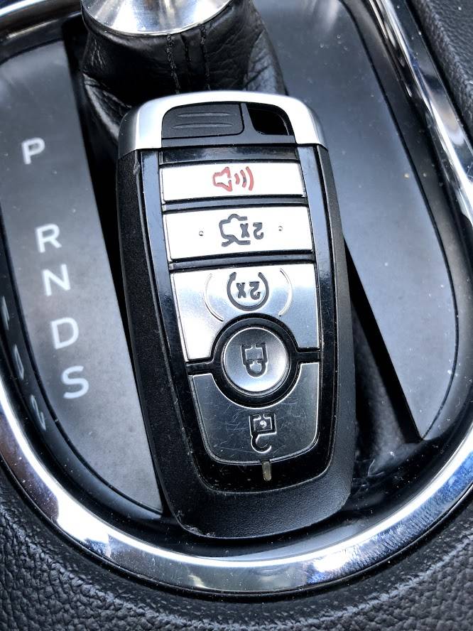

Hi Guys,
Merry Christmas to you all. I just got the new fob but I can't seem to program it. I tried the steps above and what was done in the video and no dice. Not even an error message. What i did notice however is that there is now 3 keys listed on the car. I believe there were 2 prior and i only have 2
The car is a base 2017 mustang
This the pictures of the keyfob in case I may have the wrong one.
Any help would be greatly appreciated
Thanks

The remote is the wrong one for your car from what I can tell. You have a remote for a Premium car with Remote Start. That is on the 902mhz (I think from memory) your car has I believe 433mhz for the remote or 315mhz. Unless your base car has remote start for some reason that I do not realize.
