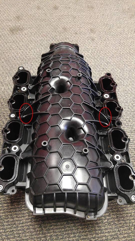

Thanks, just ordered mine. What plastic is Travis at Boostworks talking about trimming, can anyone show a picture? It's going on the minute or gets here. I emailed Lund for a tune for it today, hoping it gets here by Friday. I was going to do suspension parts this weekend but might hold off since my new jack and Spring compressor haven't arrived and might not be here in time. If I have to take the subframe apart I'd rather do it once than two or three times

Trim where I've circled in red.. You may have to just barely skim a few other of the smaller ribs, but that's the main part. 10 minutes with a dremel will do the job. Basically, the flanges on the '15 Coyote heads stick out (inward toward the center of the block) because of the IMRC and O-rings, so you have to trim the ribbing on the manifold to clear that. You'll need the 8 O-rings for the manifold if yours doesn't have them. They're like 20 bucks at Ford. Let me know if you need any further help.
