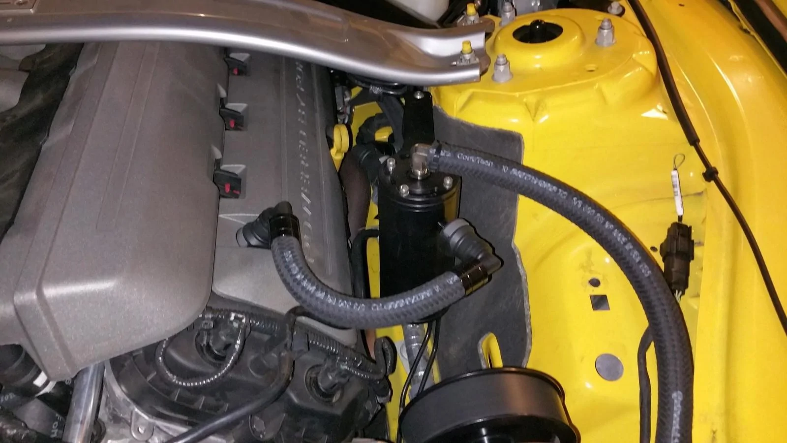

My UPR can:

nice man, have you had anything deposited in it since you installed it
Haven't checked it yet. Will probably give it a look in another 500 or so miles.
