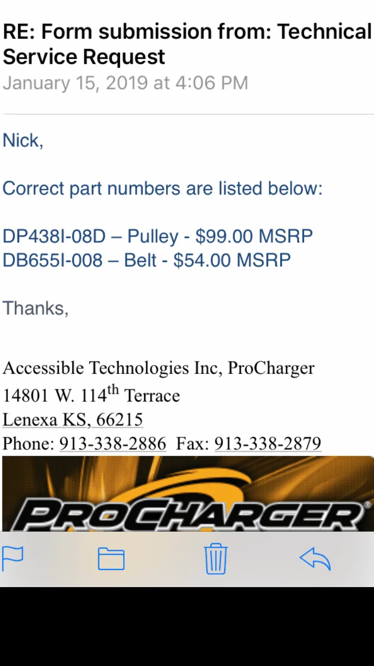

Does snyone have the part number for a procharger 8rib belt that fits a 4.38 pulley?

Gates k08660hd is really tight on the 4.50”. Might be just right on the 4.38”. I ended up getting a 665 to fit the 4.50 better. Belt was rubbing underside of tstat housing it was so tight and limited on tensioner travel. Got a barely used for like 5 miles 660 if you want to give it a try. Topside has barely rub marks from tstat.

K08670hd is the gates green works well on the 4.88. The gates standards procharger sends are very delicate. Do not try to roll one on the pulley or it will rip the outer ribs off. Have to put the belt on the pulley then slide the pulley on the blower with the tensioner completely removed.

Proper pn for that belt would be K080670. Hd I believe is green, I run the RPM belts. No stretch.

Hey Jay i found that when the belt is real tight i usually take the idler pulley,the one that sits on top of the stock idle pulley off.Then put the belt around everything and then put that pulley back on with the belt around it.
