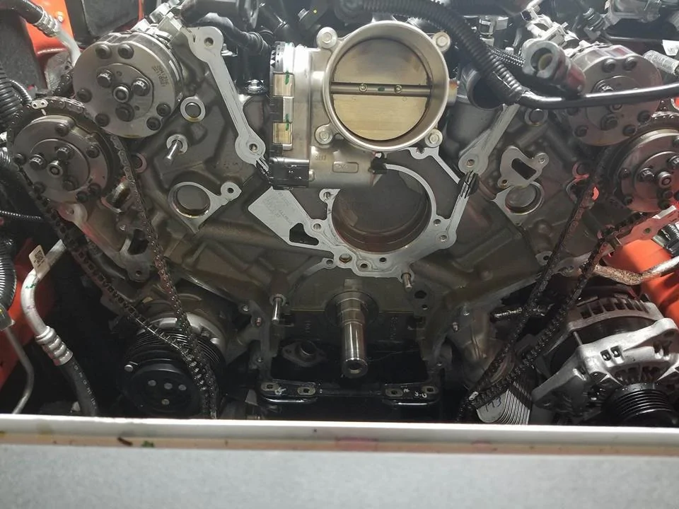

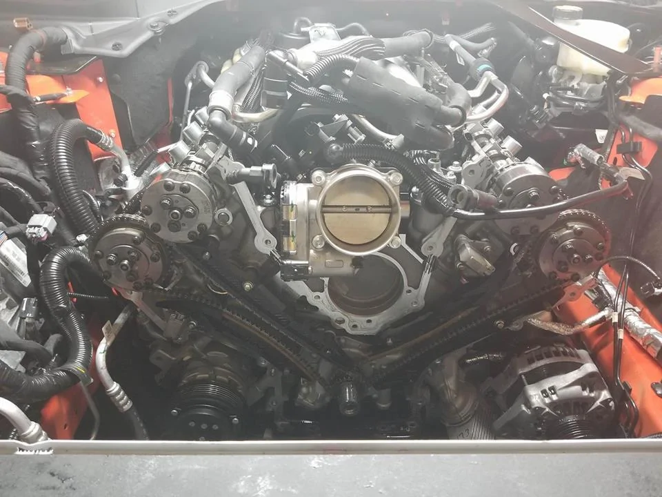

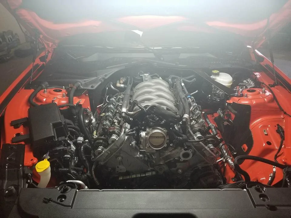

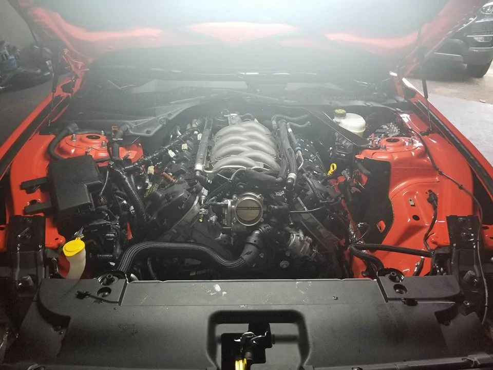

The Procharger is on the truck for delivery tomorrow. Getting ready for the install. Had a friend install MMR billet OPG's and Crack Sprocket on Saturday and picked it up today. Some pictures that below. Brought the car home about 1:00 PM and let her cool off, then started on the prep.
As of now I have the OPGs/CS done, Brisk Plugs in, ID1050x injectors in, VMP plug & play BAP in, boost gauge in, coolant drained and bumper cover pulled. The last picture is the car patiently waiting for the new parts this evening:

Nice! Looks like should be a quick install since you have a head start with the bumper removed.

Nice. You can pop all those clips off behind the bumper holding the wiring harness. The harness will sit on top in front of intercooler.

Will be pretty quick. Only time consuming thing now is cutting the silicone to fit.
I actually counted the "clicks" it takes to remove those hidden 7mm screws in the bumper by the headlight...
In case anyone wants to know, its 221 clicks each...
(using a Matco 1/4 ratchet)

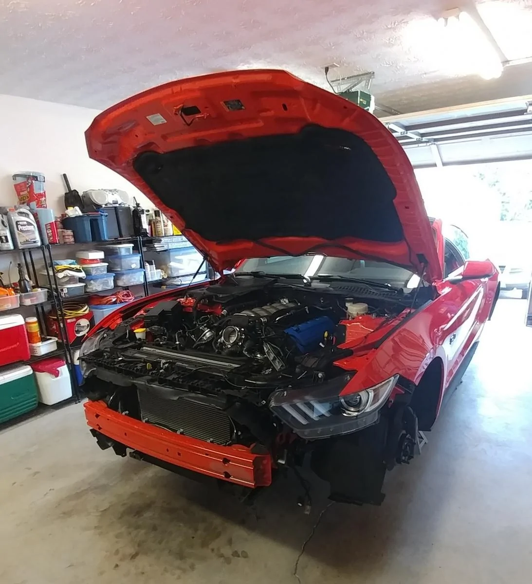

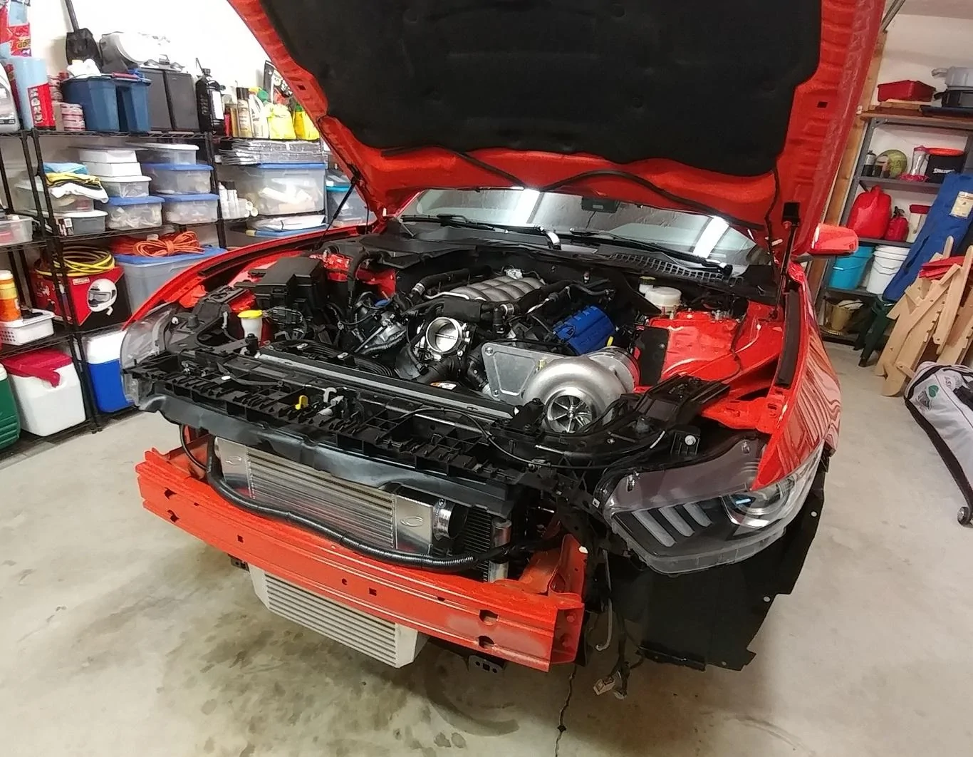

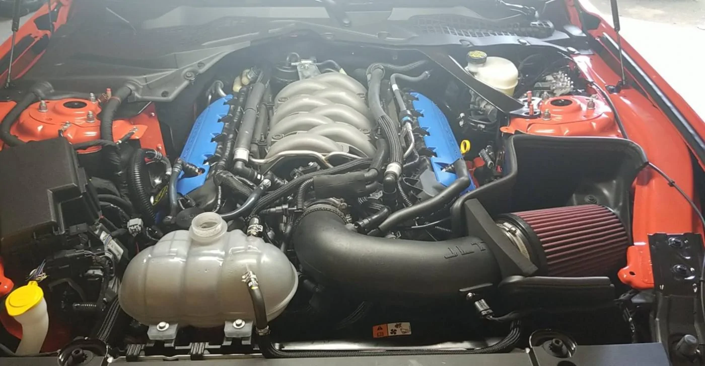

FedEx man came about 1:00 PM and I got started this afternoon after work. Brackets, thermo housing, charger, intercooler, belt, tensioner, tune uploaded, and a bunch of other stuff done. Now just a lot of plumbing to do:
Came with a 4.63 pulley installed. Boosty!
