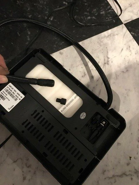

Well, my wife said exactly the same thing, and after seeing your post, I went and tried compressor - same result!
Did you tackle Ford about it?
I took mine back to Titan Ford. The tech had the same trouble I had and tried a compressor from another Mustang which was OK. He then tried mine again, and (in his words) did it up "ridiculously tight" - and it sealed.
So, in short - when it feels like you've done it up all the way - keep going and do it even tighter!

On the back of the compressor is a number of Valve adapters , One is for your valve on your Mustang's wheel, You screw it on first then screw on your hose, No leaking

I saw them and thought one was for an air bed and the other was just for a Presta bicycle tyre - but there were 2 others! (who said I'm dumb? :doh:)

Well, Well. I didn't realise that. The main fitting looked exactly like a proper tyre valve fitting. Especially when it worked OK on another vehicle.
Thank you.
I think a lot of people will fall for this and when they are out in the rain with a flat tyre.
I gave mine away to my son. Will let him know. Thanks again.:thumbsup:
