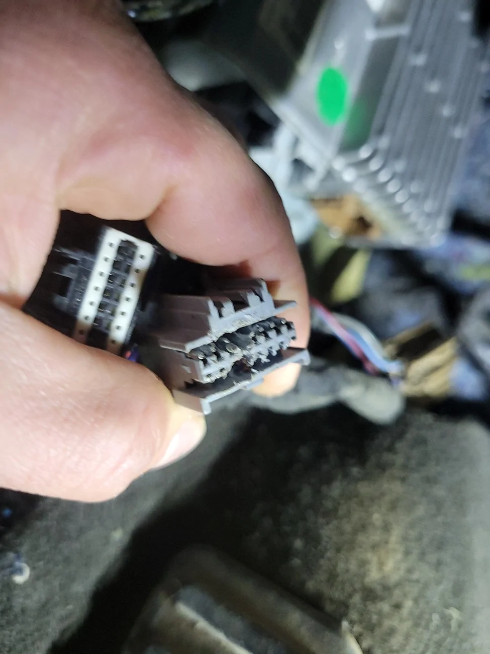

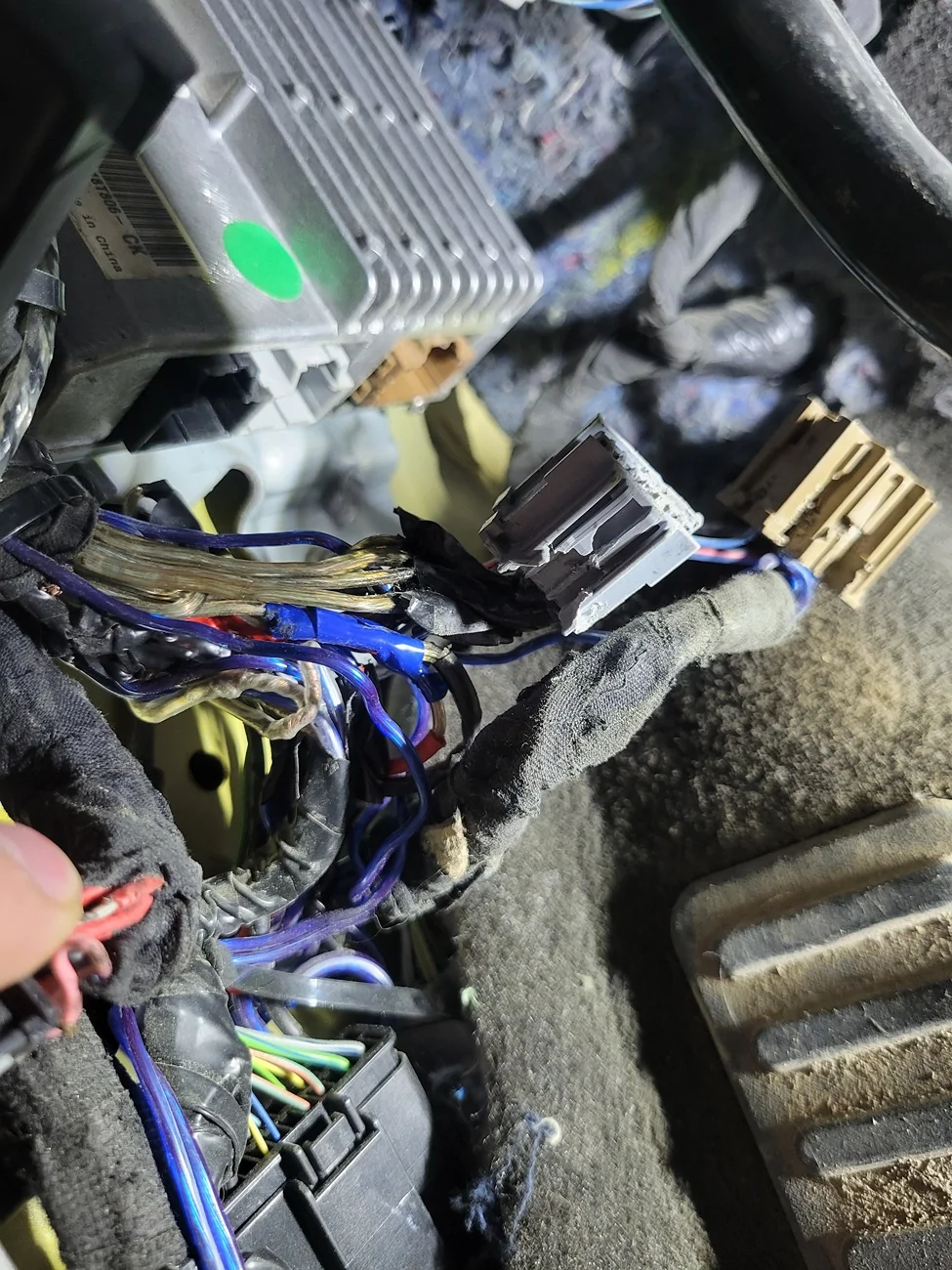

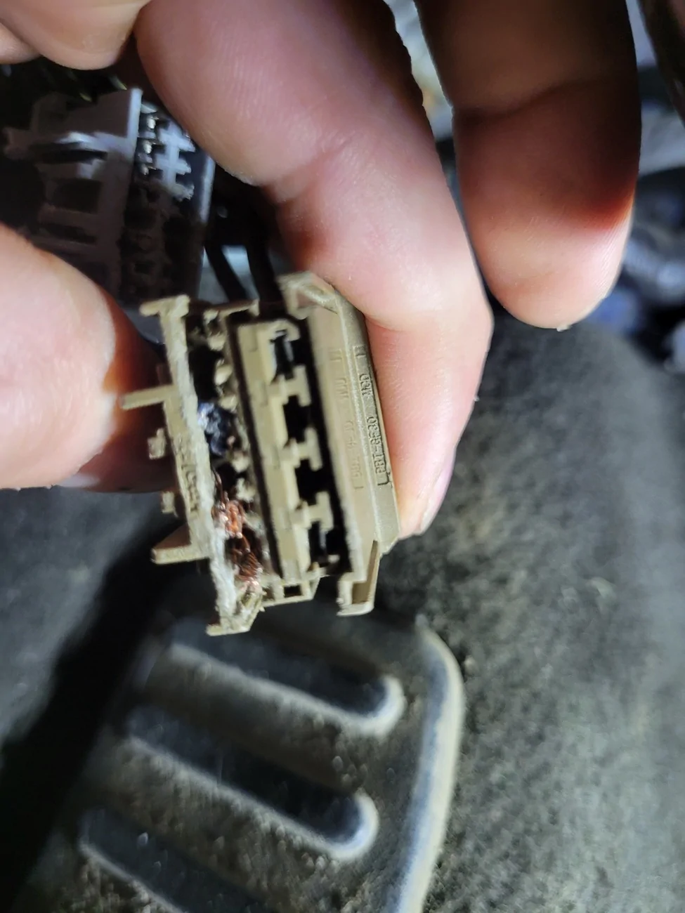

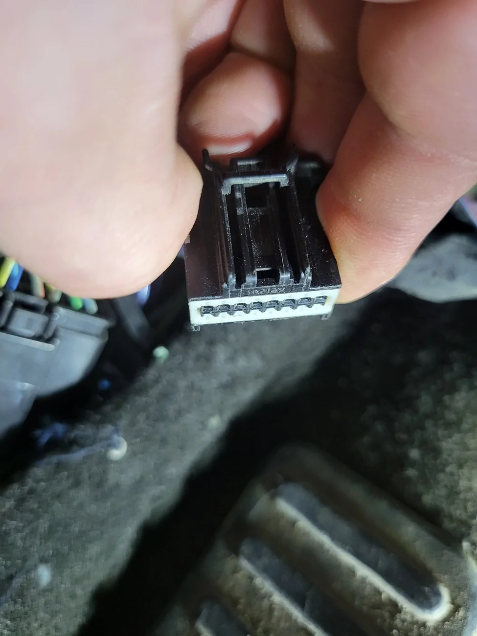

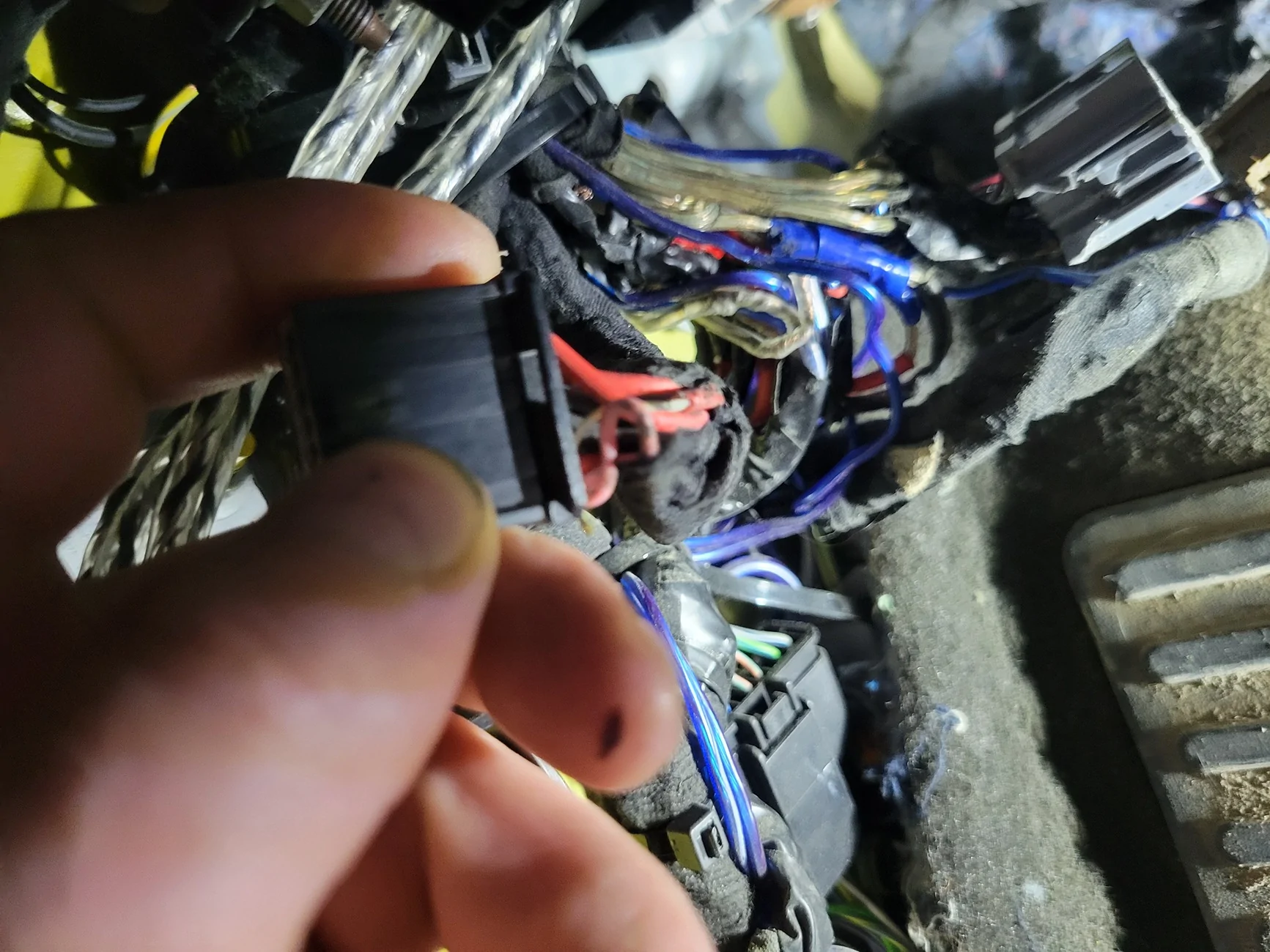

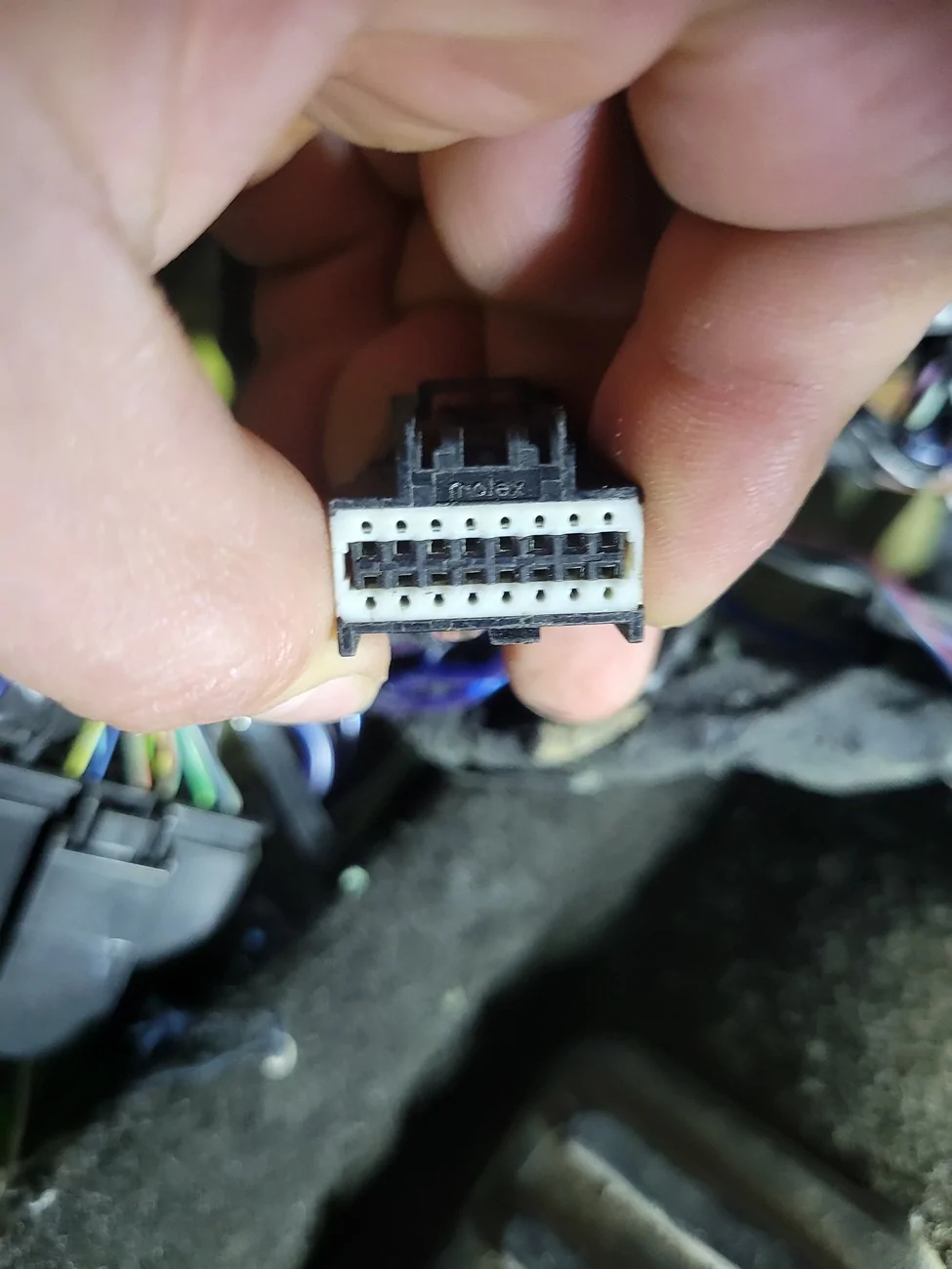

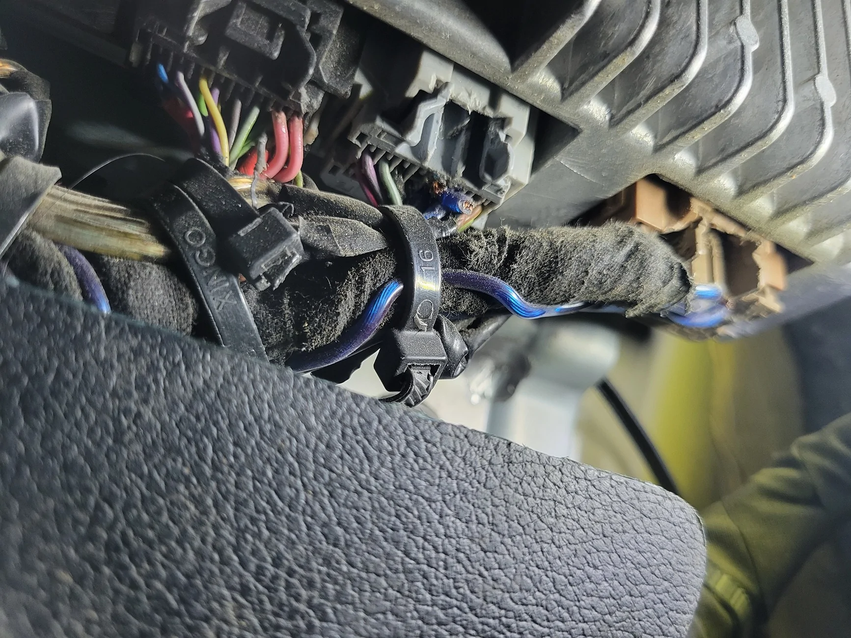

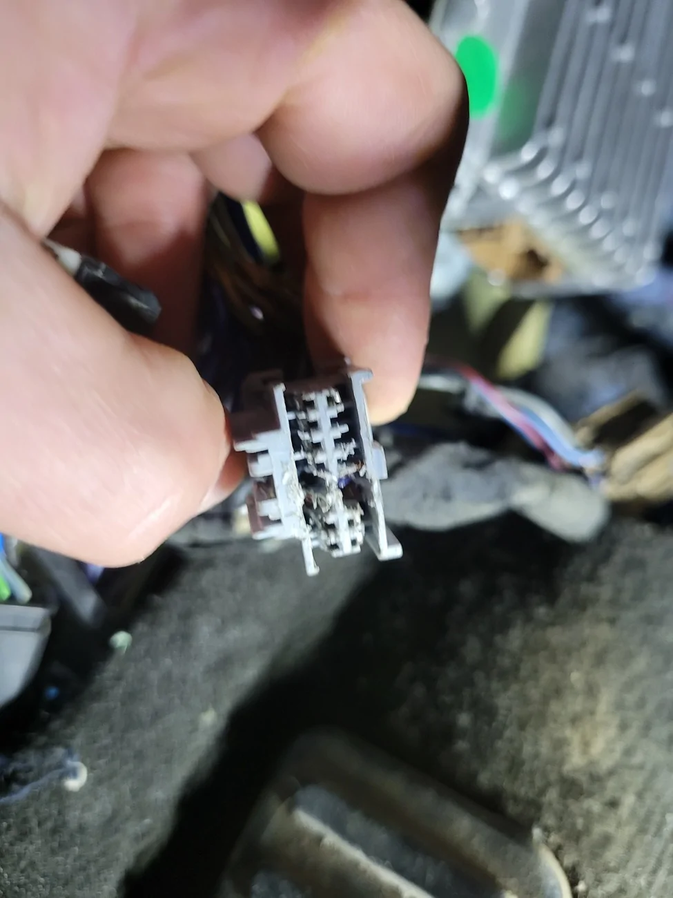

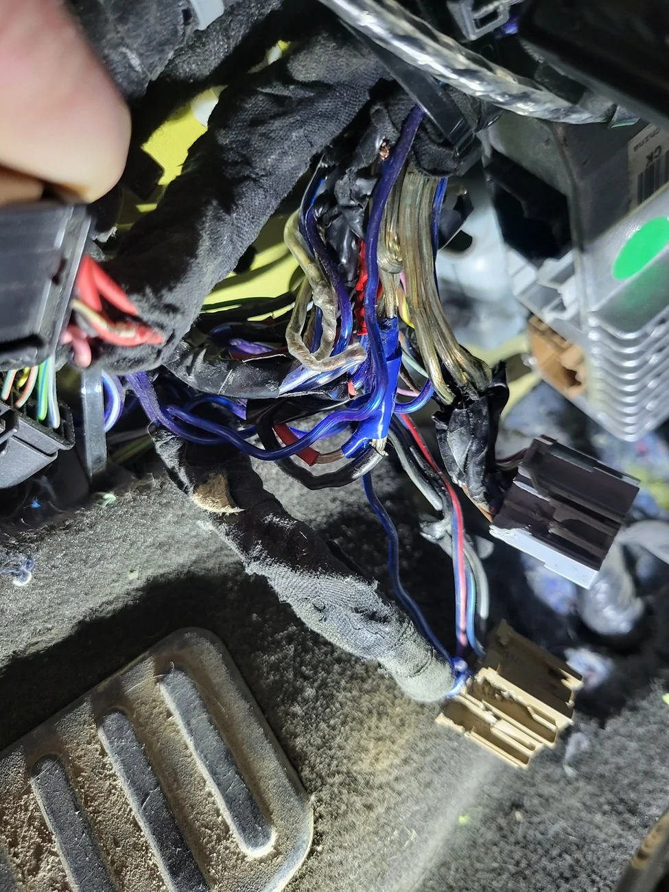

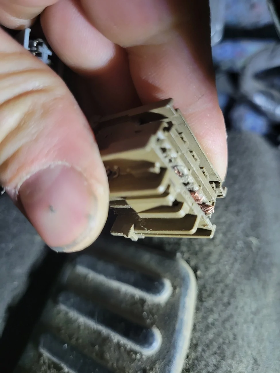

Looking to see if anyone knows the part number for the stock amplifier pigtail plugs because mine are mangled

Wow! The gray and tan connectors were really chewed up. Was there a rodent issue, or was someone tired of trying to get the connectors apart and just broke the locking tabs off?
😆😆😆 anything else looks good I had the whole car apart 3 months ago and it was clean no poop or nests or smell. I think Last guy that had my car was like I can do that lol

Where in the car is this amp located, front,back? Under the dash, in the trunk? I just want to be sure I've found. The right ones
It's in the front left corner under the dash

Apologies for the late response and delay. I have provided the connector names, the brand of connector, the pigtails where available. I have also provided the connector at the manufacturer website, the link where the bare connectors can be purchased at two major online retailers.
Please see below:
Black
C2385A
The pigtail is WPT-1560. It is ~$115.00
Wire Assembly WPT-1560 | OEM Parts Online
However, below are the individual details for the connector. If you are comfortable making your own connector, you can do so with the parts below for less than $5.00
Connector Brand: Molex
Connector Series: 34729
Manufacturer Search Results:
Connector Pins/Terminals: 16
Connector Female Part#: 347290160
Manufacturer: Connector Housings Part 347290160 | Molex
Mouser: 34729-0160 Molex | Mouser
Digikey: 0347290160 Molex | Connectors, Interconnects | DigiKey
Female Terminal: Molex CTX64
22 gauge: Part Number: 348033211
34803-3211 (Loose Piece) Molex | Mouser
0348033211 Molex | Connectors, Interconnects | DigiKey
20 gauge: Part Number: 348033212
34803-3212 (Loose Piece) Molex | Mouser
0348033212 Molex | Connectors, Interconnects | DigiKey
Grey
C2385B
I could not find a pigtail for this one
Connector Female Part#: 347290161
Manufacturer: Connector Housings Part 347290161 | Molex
Mouser: 34729-0161 Molex | Mouser
Digikey: 0347290161 Molex | Connectors, Interconnects | DigiKey
Brown
C2385C
The pigtail is WPT-1552. It is ~$106.00
Wire Assembly WPT-1552 | OEM Parts Online
Connector Series: 34969
Connector Pins/Terminals: 14
Connector Female Part#: 349690142
Manufacturer: Connector Housings Part 349690142 | Molex
Mouser: 34969-0142 Molex | Mouser
Digikey: 0349690142 Molex | Connectors, Interconnects | DigiKey
If you need, I have the entire pinout details at the link below.
Please go to the S550 and search for any of the 3 connectors above.
S197 / S550 Connectors
Red_&_BlackS550
Red_&_BlackS550
Oct 10, 2025
41
Alberta,canada
LEX
2015 mustang GT 5.0, 2014 F150, and a 2000 Dyna
Hell yeah that made it easy! I appreciate it. unfortunately ford is closed until Tuesday
slonison
Sep 18, 2025
82
87
New York
Steve
2013 mustang
Your pictures were invaluable for getting the connectors. I am happy I was able to help. The grey connector didn't have a listed pigtail. However, Ford may be able to help if you give them the connector number. If not, and you really need it. I will be placing a mouser order soon and could make one for you.
