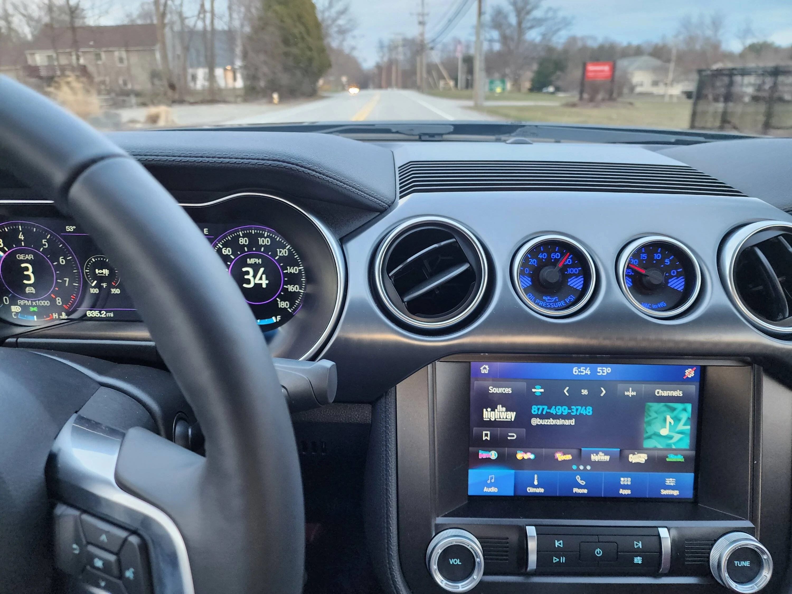

Just curious of these guages are supposed to be changed with mycolor settings or always blue? Mine are the latter. Dealer is saying that is normal. If it isn't. Anyone have a pic so I can demonstrate that to them? Thanks!

never thought of it as all my gauges are blue.

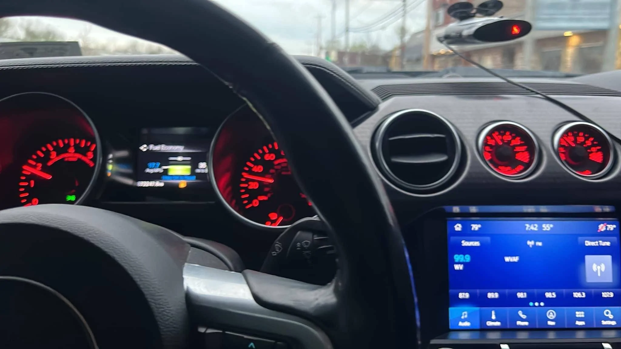

Mine are red.

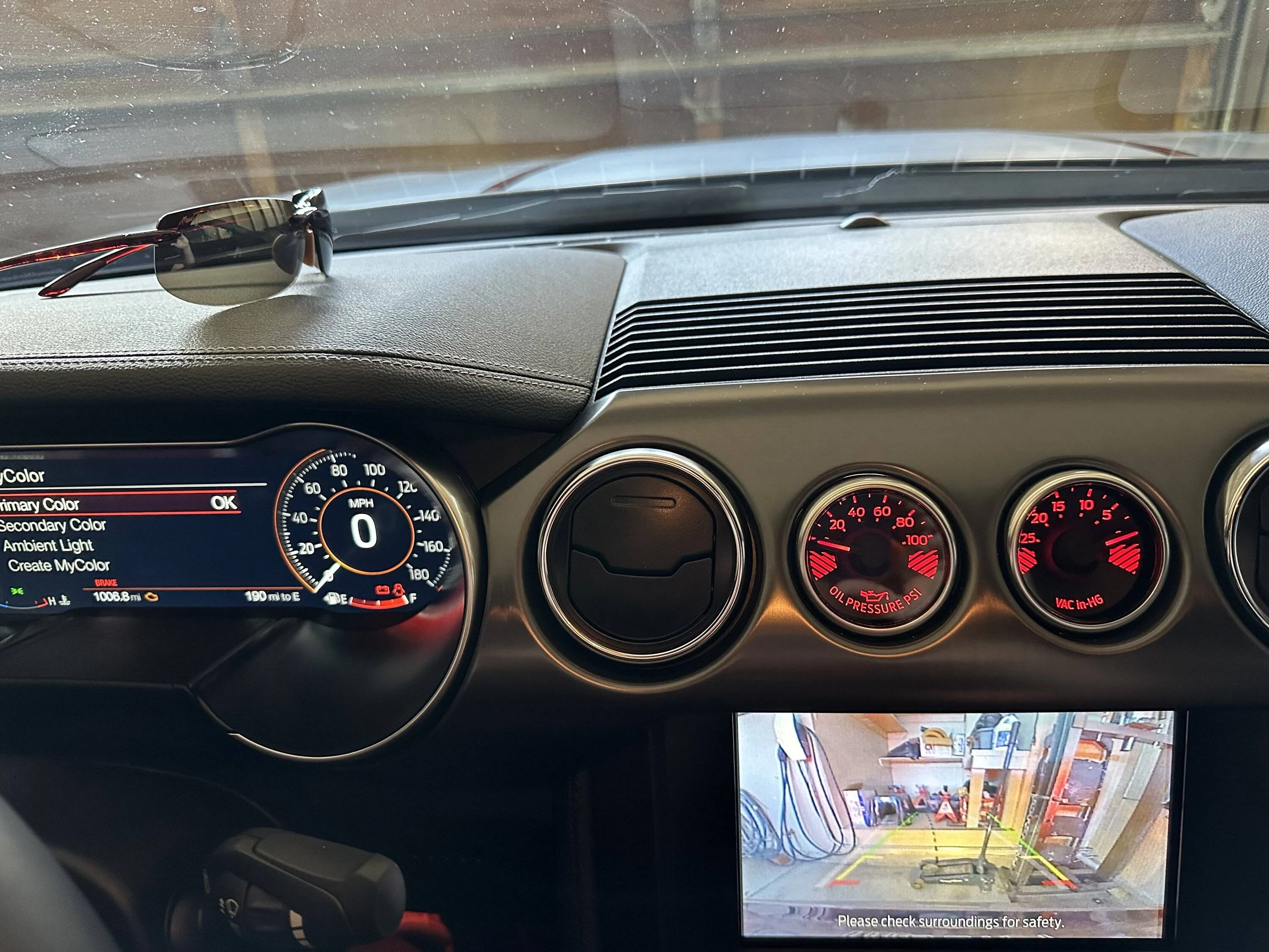

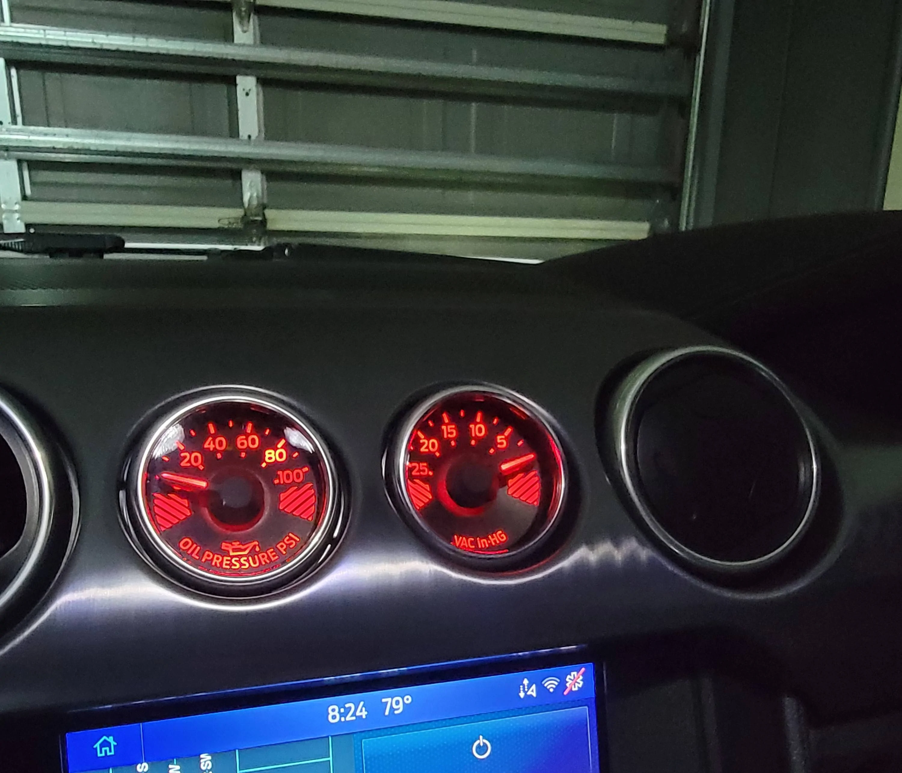

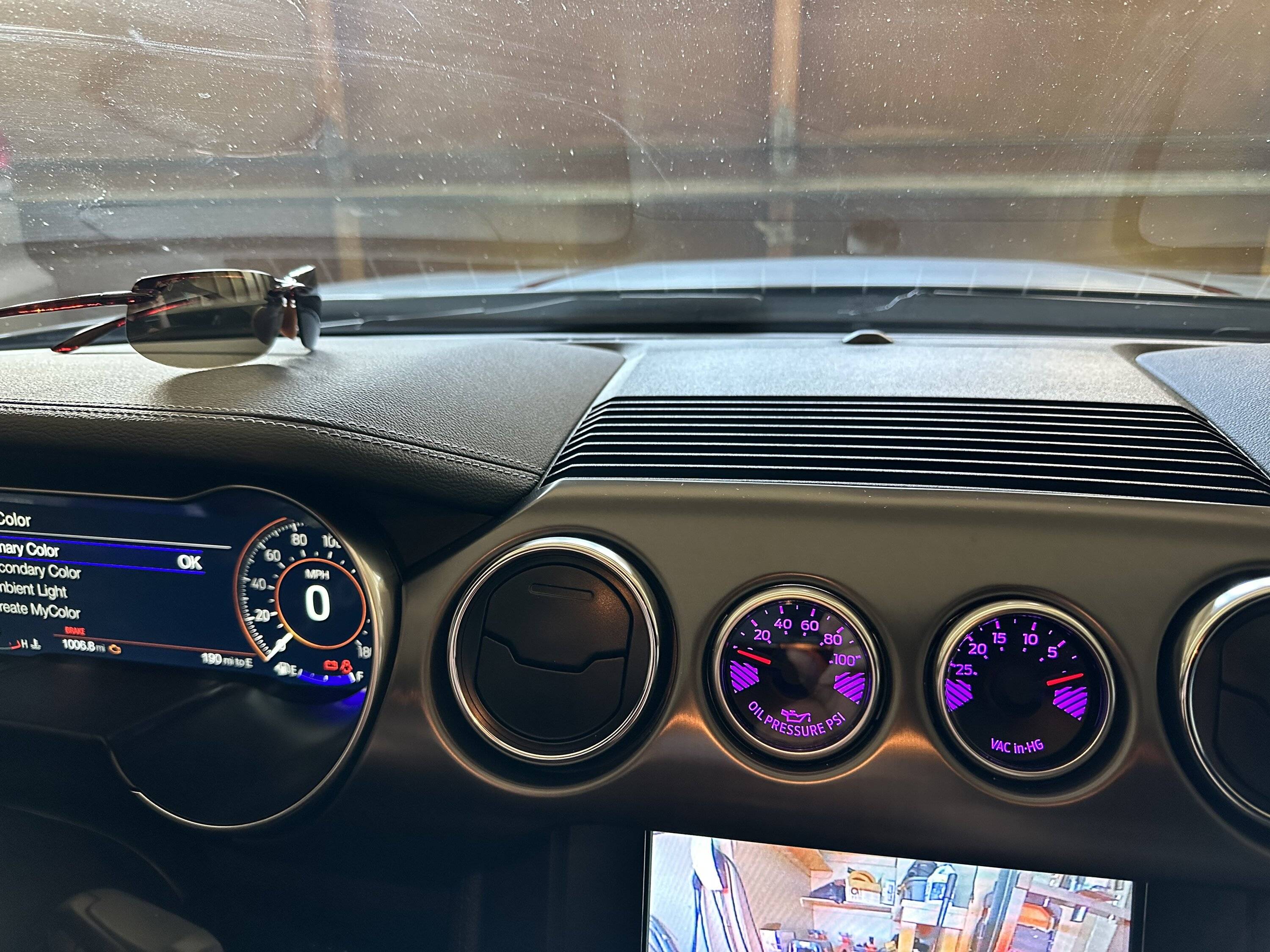

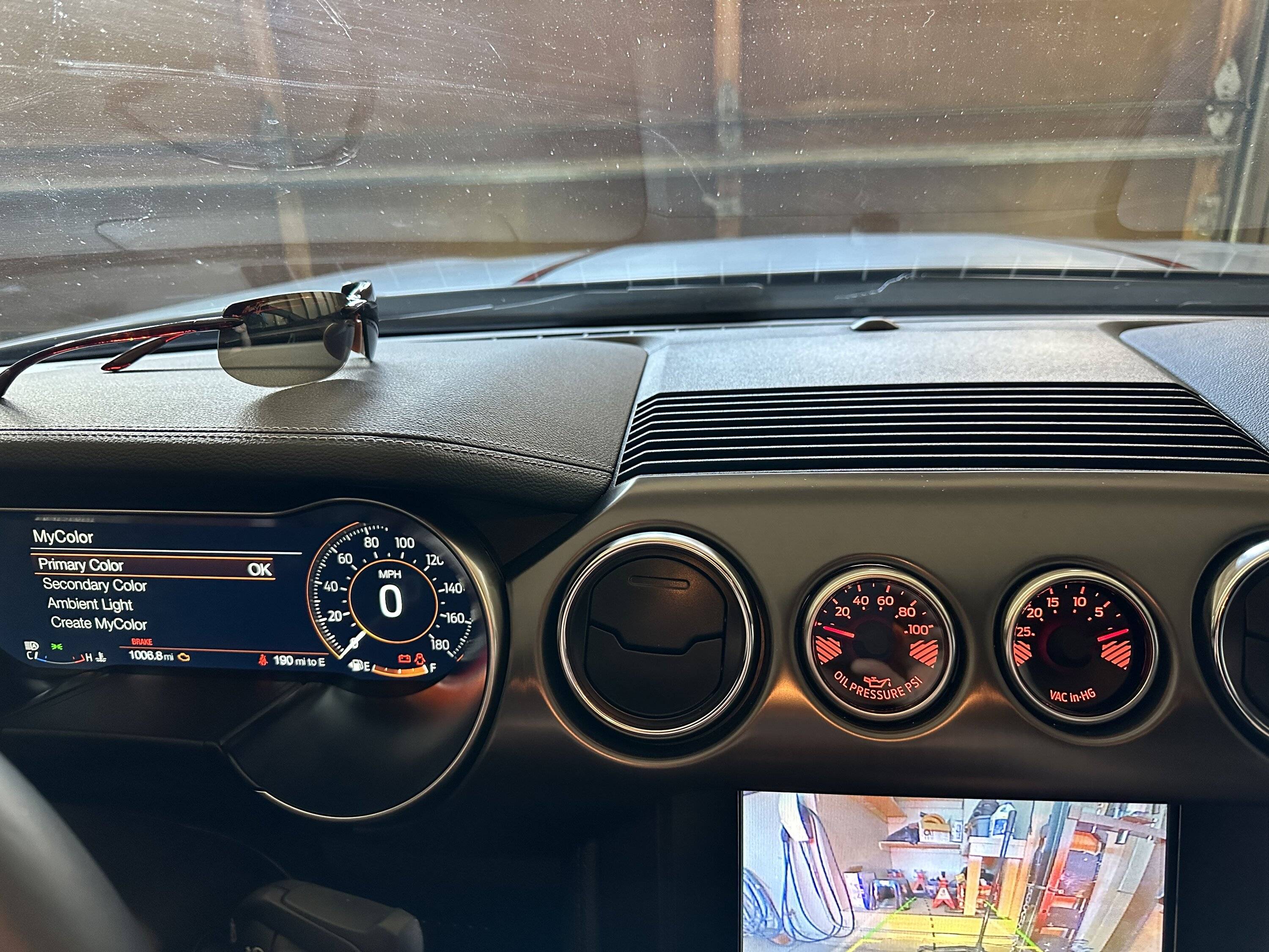

You can change the color of the vac/oil pressure gauges to anything you want.
go to My Color. Then select Primary color. This will allow for blue, red or orange to be selected.
If you want your own color, select "Create My Color" which brings up 3 different color pallet discs. This allows you to create a custom color of your choice.

Thank you! My primary color was a diff color than my guages earlier, but doing it this am worked and now it's all synced up.
