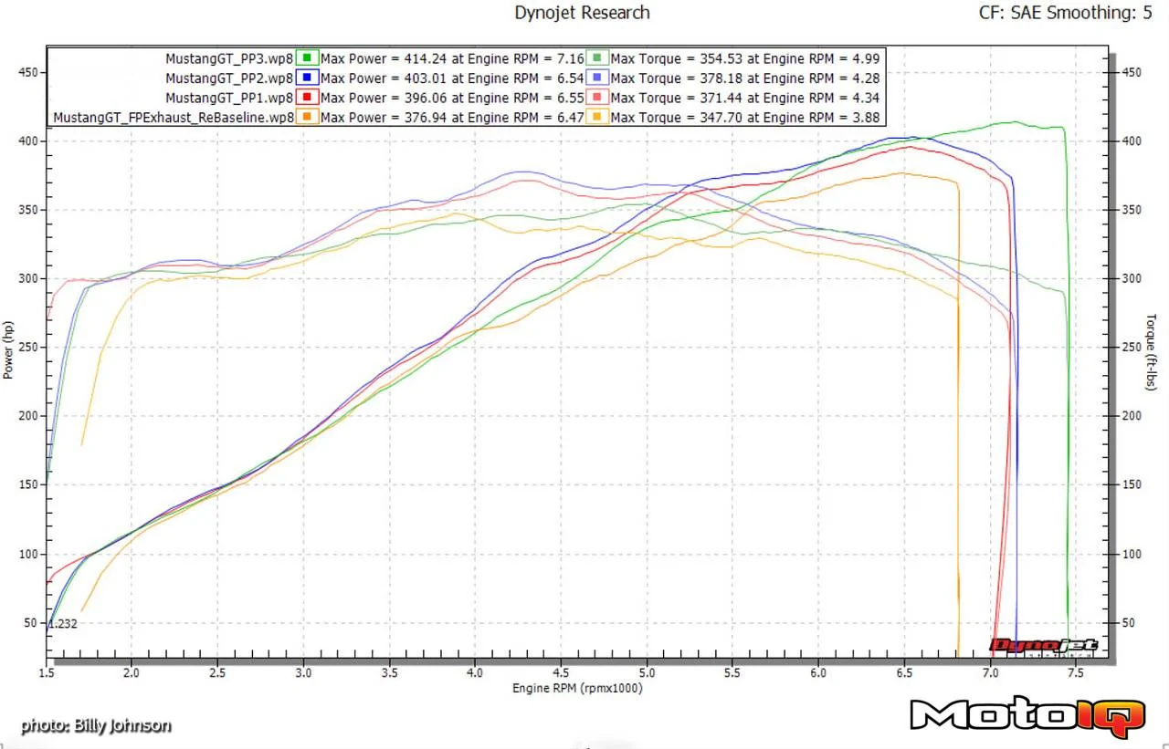

He's correct about street driving. The pp2 has the torque. Pp3 up top. If you're not racing keep the pp2. Here is a dyno sheet found on this forum
stang GT Power Pack 3 vs Power Pack 2 vs Power Pack 1 vs Baseline-X2 (1).webp
