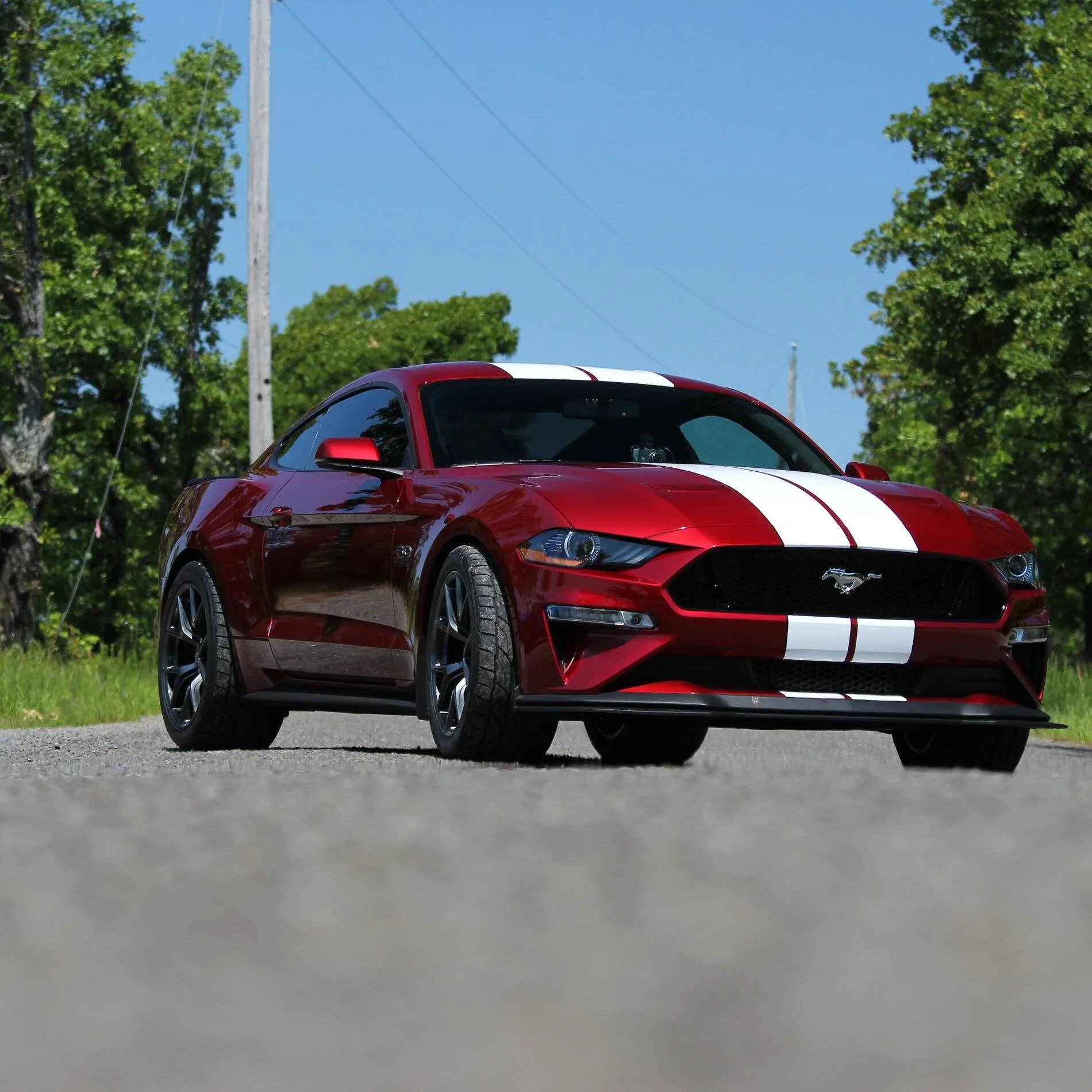

Anyone know if there are any issues running the 305/35 on a 19” pp2 wheel? I’m making sure 35s will work. Thanks
Arknsawchuck
Mar 29, 2020
599
711
Cabot, Arkansas
Chuck
2019 Mustang GT PP2
No problem at all. I've been running that size for 9000 miles now. I wouldn't do it if you have lowered the car though. Mine is not lowered and on a very rough road, in normal mode, and cornering hard at high speed I've had my left front just kiss the lip of the fender. I was the side wall and not the tread so it just kissed the inside of the lip and did no damage. But that has only happened once. It sport or track mode I haven't had it happen. It does close the big gap some so that is a good thing.
