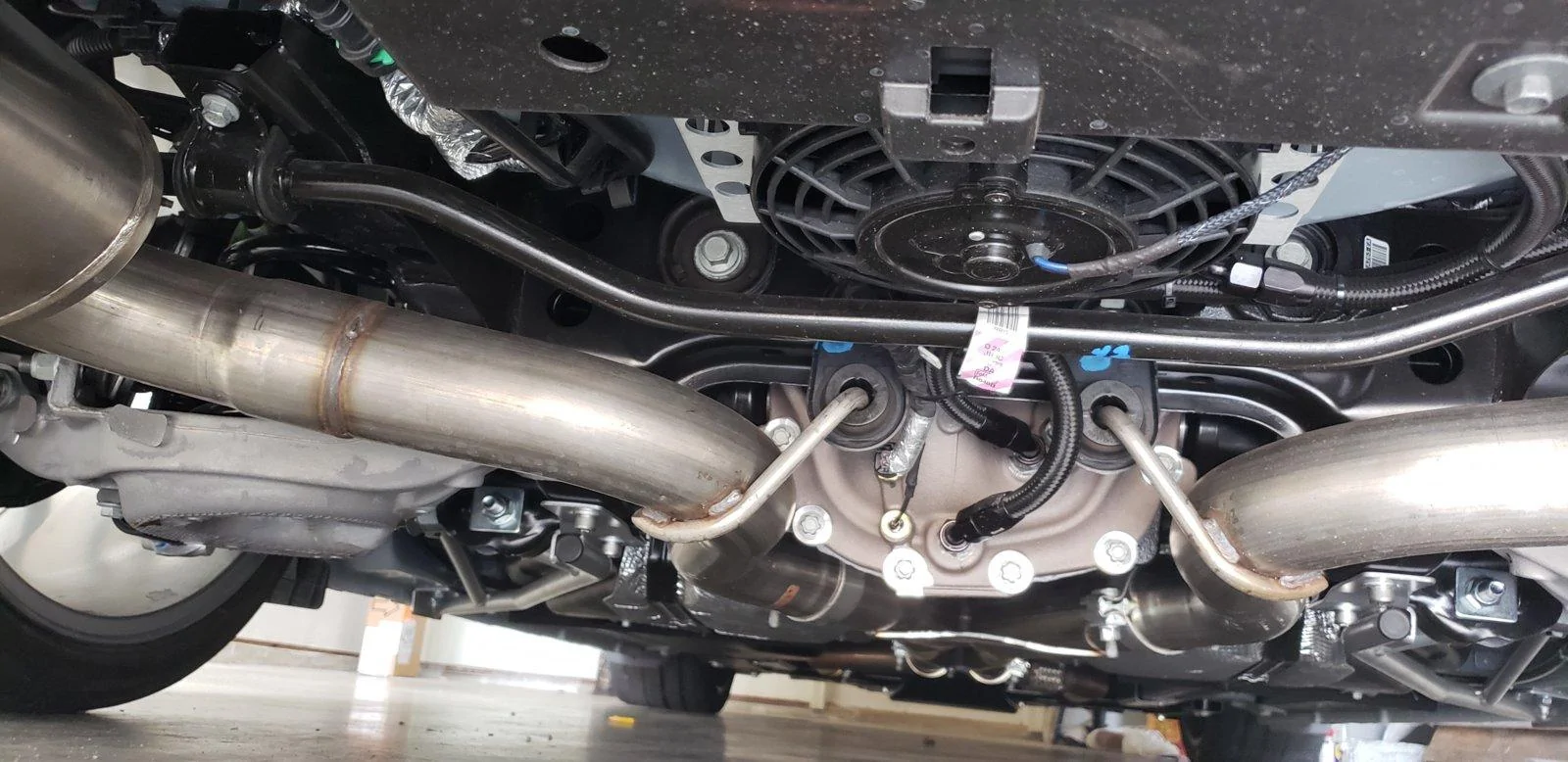

Oh...well Im not sure how hard you "ragged the car" you drove...but as I said at the beginning of all this. When you "floor it" in 1st gear in a roll even..PP2 owners will tell you the back wheels will hop. And the Steeda Stop the hop kit I highly recommend to my fellow PP2 owners. Another thing I did to track the car with confidence was to add the "Full tilt boogie racing" Rear diff cooler...pump and all not just air cooled
Rear diff cooler is a must if you plan to track a PP2, and I own both a 2019 PP2 and GT350R.
