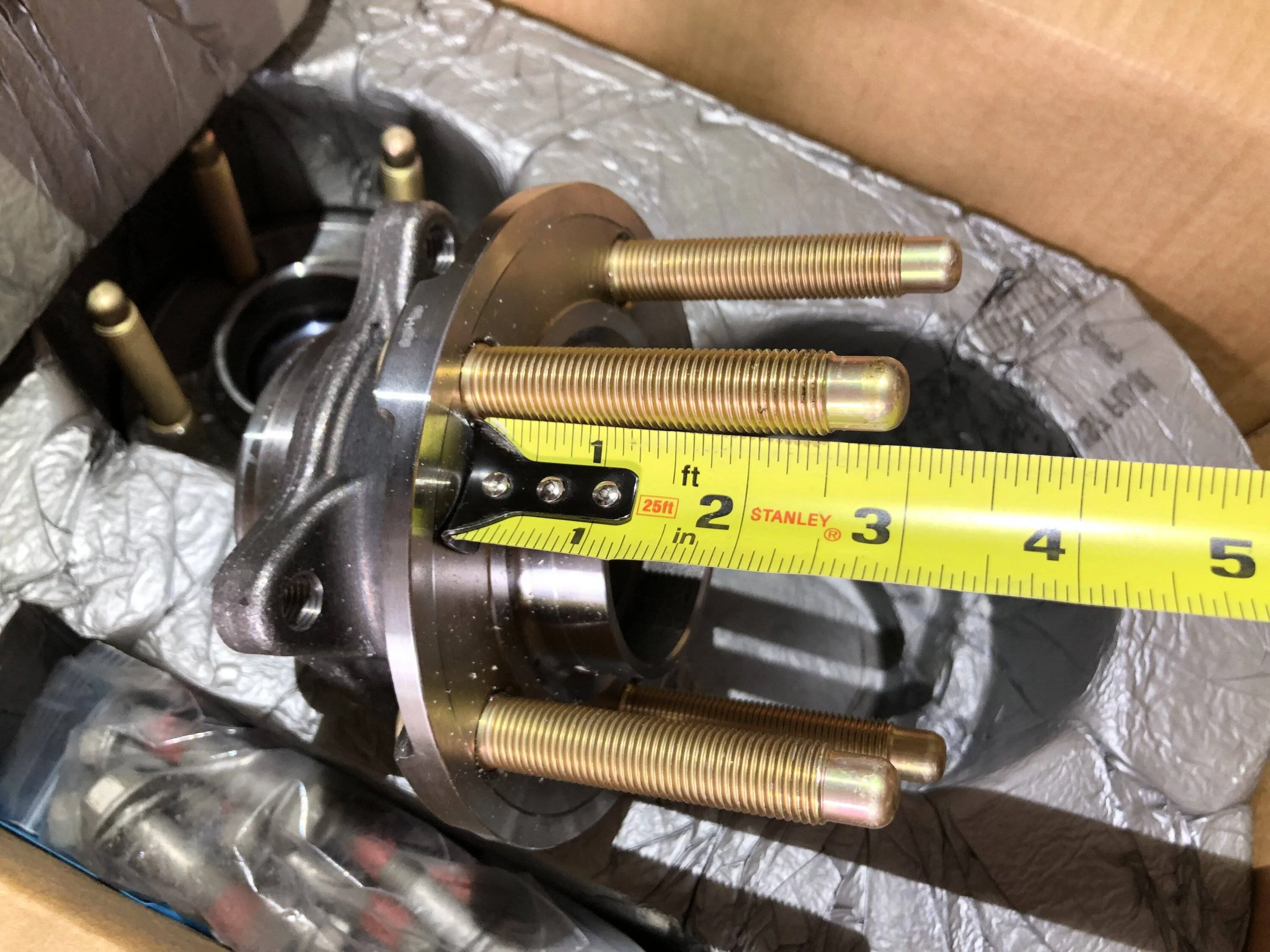

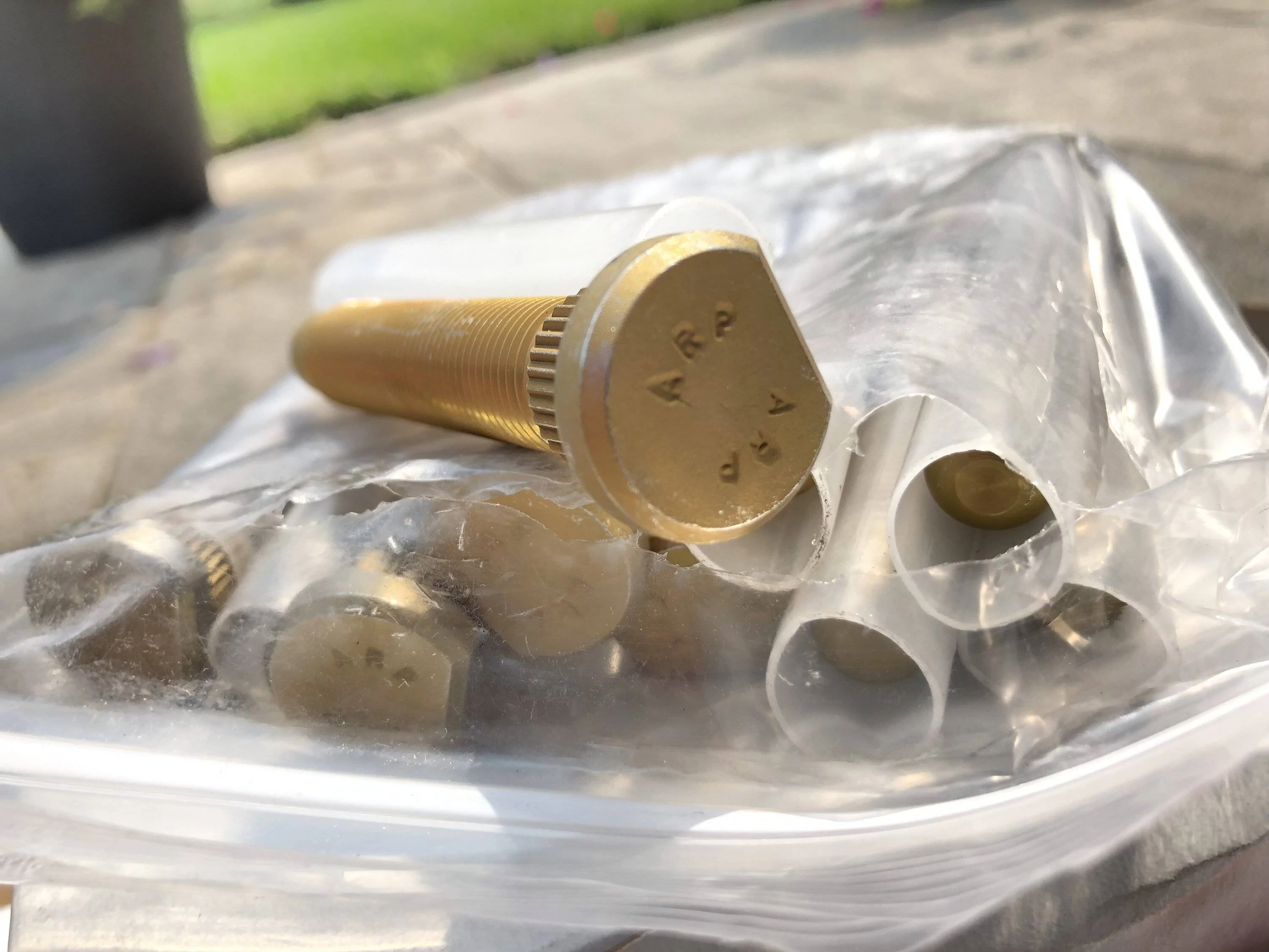

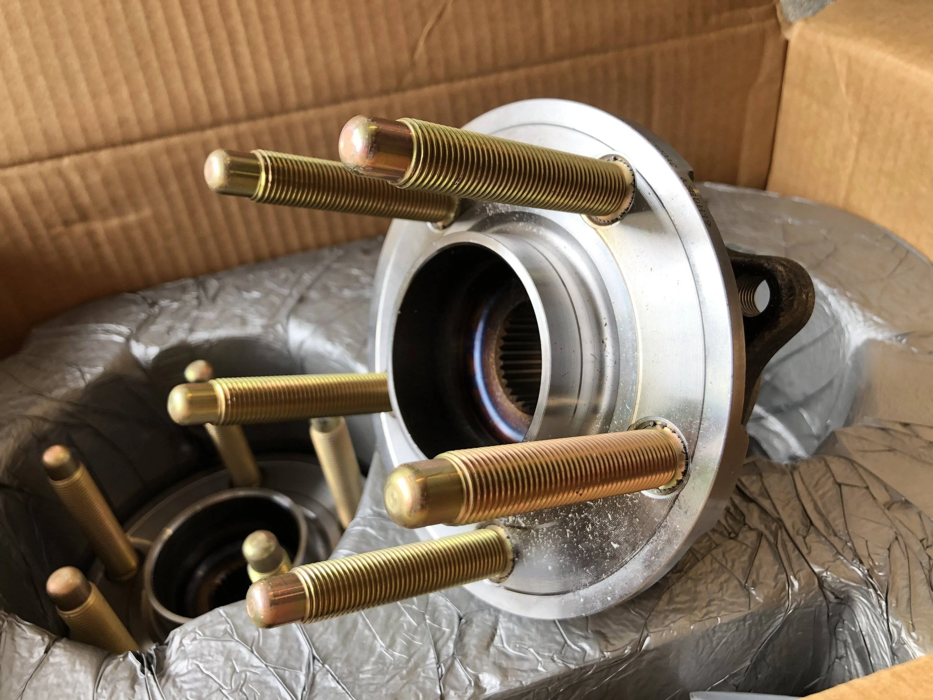

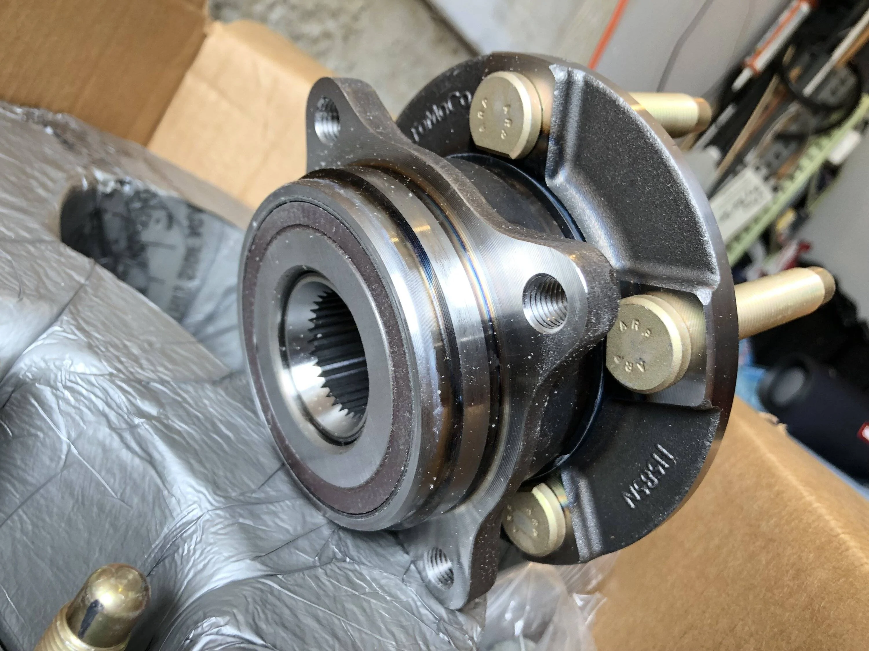

Regarding extended lugs, I have them on all 4 corners. Short story version is I was removing my wheels a few yrs back, and finally experienced the dreaded Ford lugnut swelling issue (well documented everywhere, it's actually not just Ford, GM and Chrysler too).
A few lug nuts were really tight in the socket, one was so tight, hammered it out, but shot out and almost ricocheted to the car. After that, I said F this - went with the Ford Performance open-back lug nuts and extended studs all around to prevent this. Rear is actually the FP upgraded hubs assys which include the ARP studs pressed in. At the end, got upgraded studs that handle loads of more aggressive driving, and also give me the "exposed machine hardware aesthetic" that I like (paired with the Steeds 2pc rotors chilling behind the wheels).
A few lug nuts were really tight in the socket, one was so tight, hammered it out, but shot out and almost ricocheted to the car. After that, I said F this - went with the Ford Performance open-back lug nuts and extended studs all around to prevent this. Rear is actually the FP upgraded hubs assys which include the ARP studs pressed in. At the end, got upgraded studs that handle loads of more aggressive driving, and also give me th "exposed machine hardware aesthetic" that I like (paired with the Steeds 2pc rotors chilling behind the wheels).
