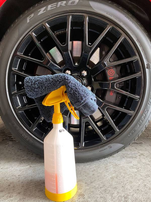

I have commented before about this, but whoever designed these wheels must have a wicked sense of humor. Cleaning this wheel design takes some patience and determination. Throw in generous amounts of dust generated by the factory Brembo pads, cleaning and keeping them clean can be a chore with these wheels.
I am not a professional expert on detailing, more like a crazy obsessed hobbyist, but here is my little pictorial tutorial on maintaining S550 PP1 wheels.

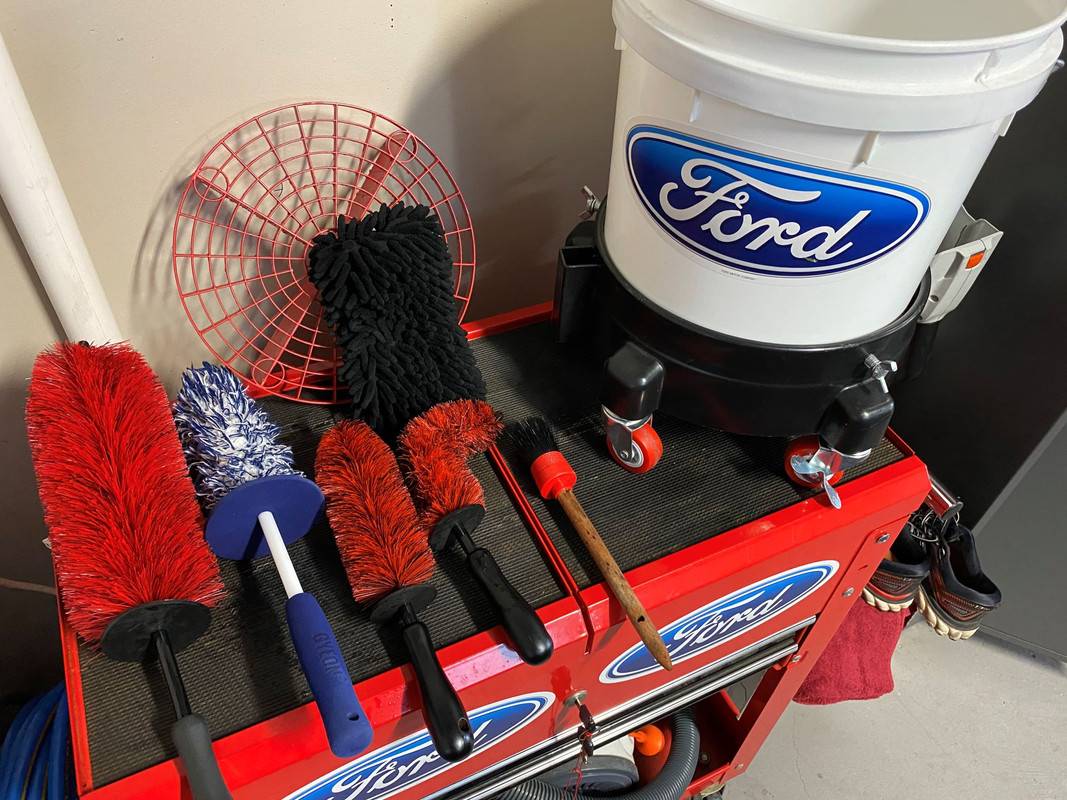

The design of these wheels and the size of the Brembo caliper/disc on the front axle means a few different tools are required. Now you don’t need as much as I have here, I did say I was obsessed :crackup:, but a couple of brushes are needed to navigate around the calipers and around the back of the spokes.
I use a separate wash bucket with a grit guard for wheels, filed with the same wash solution I use for the bodywork. The brushes pictured are both large and small Speedmaster wheels brushes (red bristles), a Gyeon microfibre wheel brush, a microfibre wash pad and a detail brush.

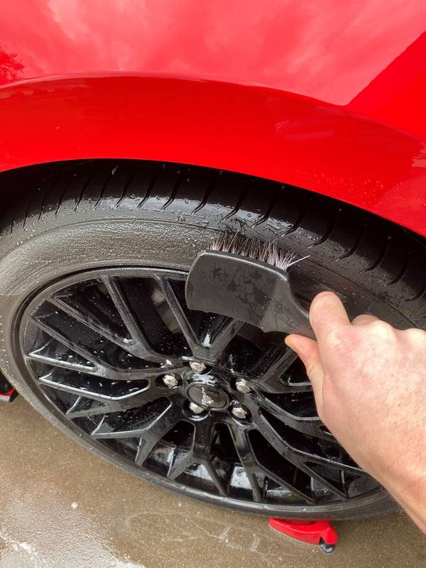

Tyre clean. Now this step is optional, and it doesn’t really need to be done at every wash, but is certainly a worthwhile task as clean tyres take new dressing much better. Spray the wheel, and wheel arch if required, with a tyre cleaner. Agitate with a stiff bristle brush, then rinse.

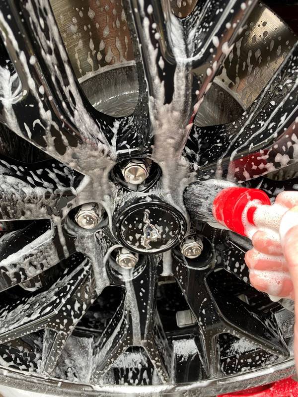

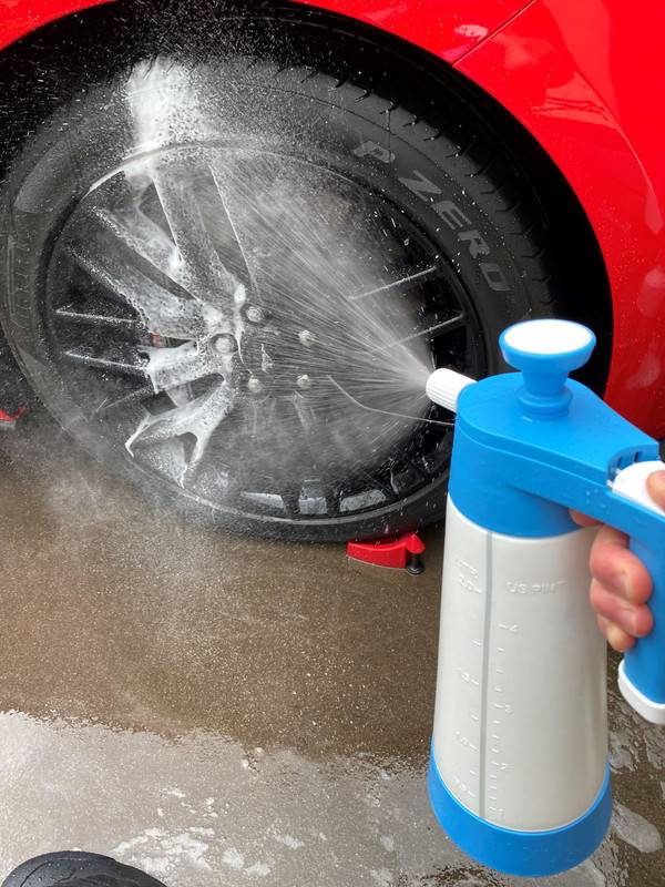

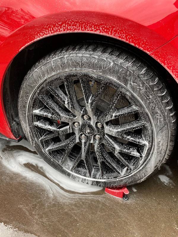

Now onto the wheels. This where a wheel cleaner is often used. In my case, these wheels are detailed often and therefore don’t require the use of a strong chemical. I therefore use a small foamer to spray down the wheel and arch with my wash solution mixed at 10:1.
Next, use the detail brush to clean the lug nuts and the calliper where possible.

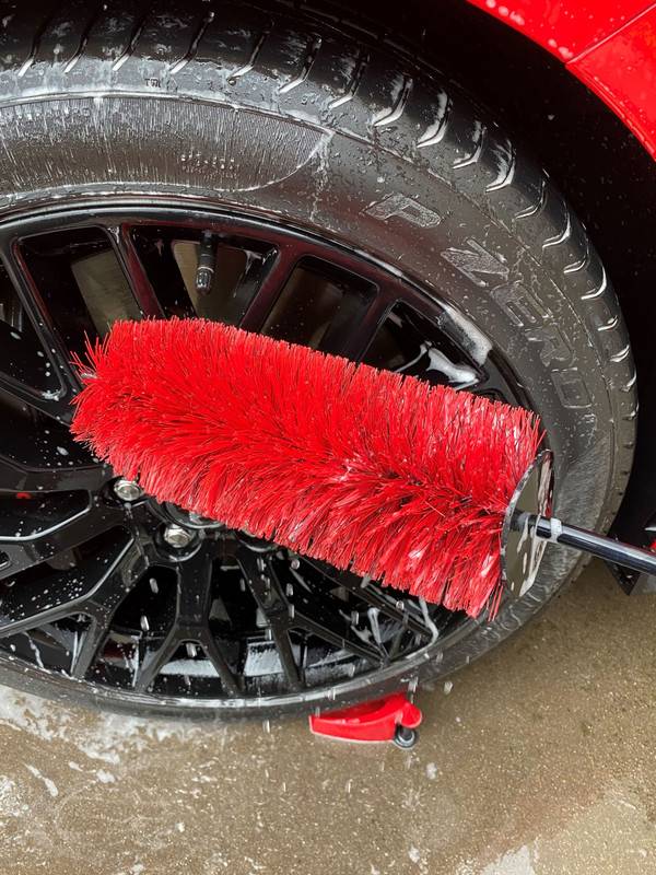

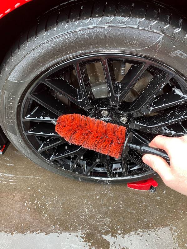

Now use the large Speedmaster brush to clean the barrel of the wheel.

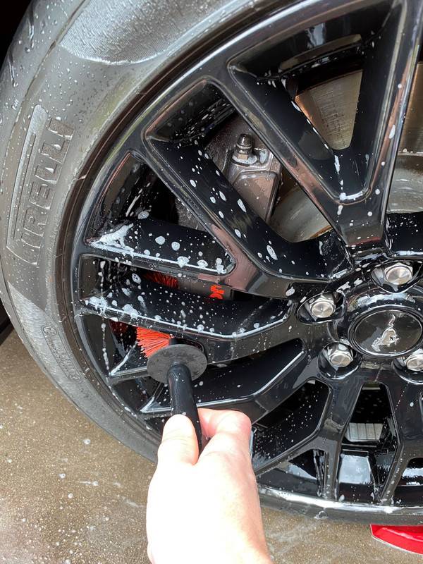

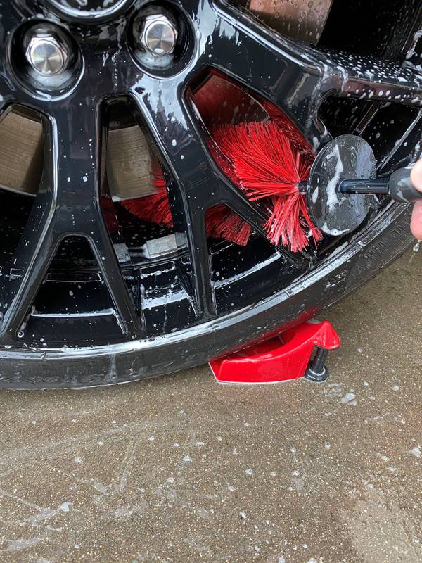

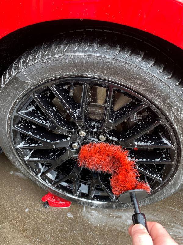

To get behind the caliper, use the smaller Speedmaster. I also use the smaller brush, bent, to get behind the spokes.

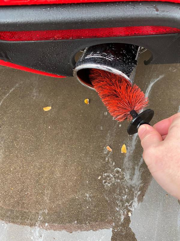

Whilst you have these brushes on hand, clean the exhaust tips.

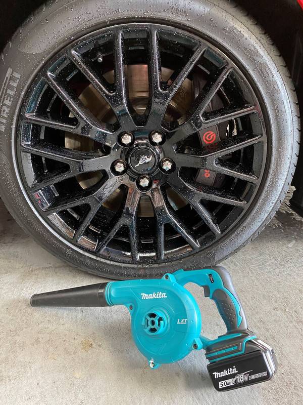

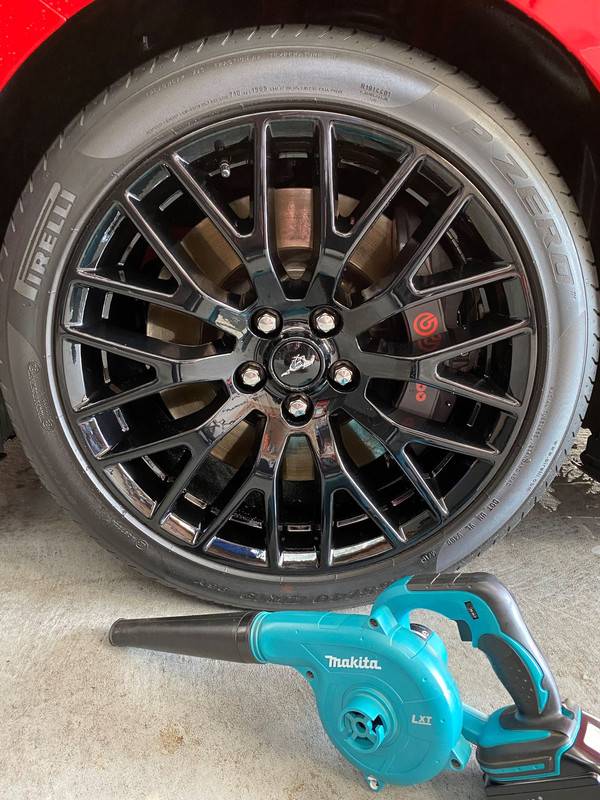

All clean and ready to be dried. Being coated, the use of a small blower makes drying easier.
I then give the wheels a final wipe over with a microfibre and some quick detailer.

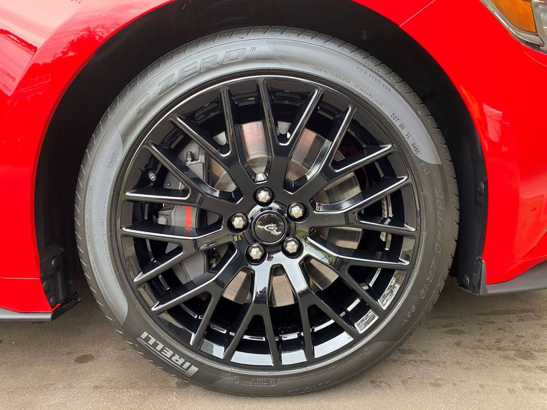

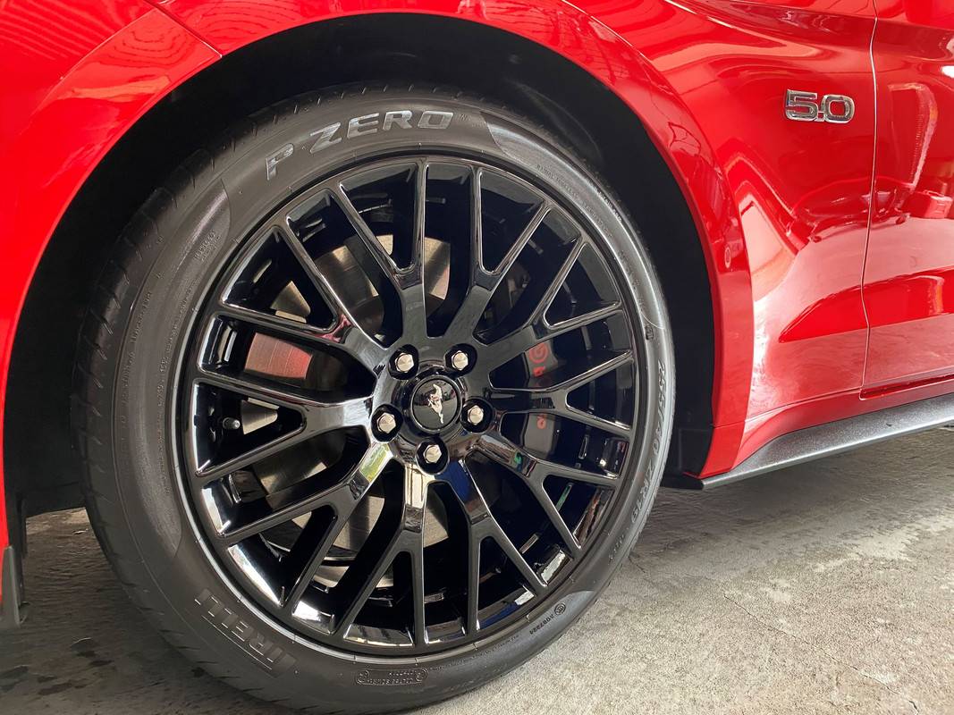

And 15 million hours later, the final result after some new tyre dressing. Guaranteed to stay that way for less than one minute into the next journey. Ahhh, the things we do for our cars hey! :crackup:

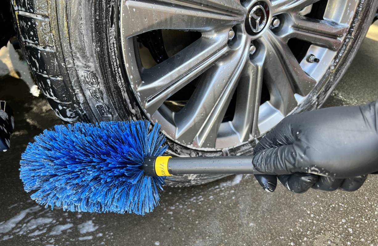

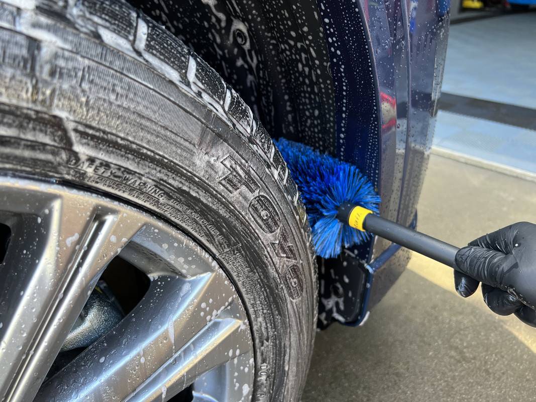

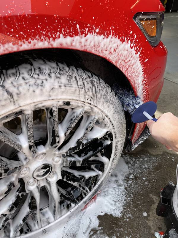

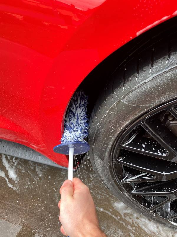

The wheel is not a huge problem for me, but I do have a problem with cleaning the wheel arches. Any suggestions on how to attack cleaning the arches without taking the wheels off?
DFB5.0
DFB5.0
Mar 15, 2017
93
5,458
15,727
Australia
Mustang GT Fastback
When cleaning wheel arches, I use whatever brush I am using to clean the barrels, be that a microfiber or bristled brush. I will use the same wheel cleaner or soap as the wheels.
I'm really liking this version of the EZ-Detail Brush for wheel arches at the moment -
Go EZ Detail Brush – EZ Detail Brush by EZ Products inc.
Obviously, you will only be able to clean as far as the brush reaches into the arch with any of the above brushes.
