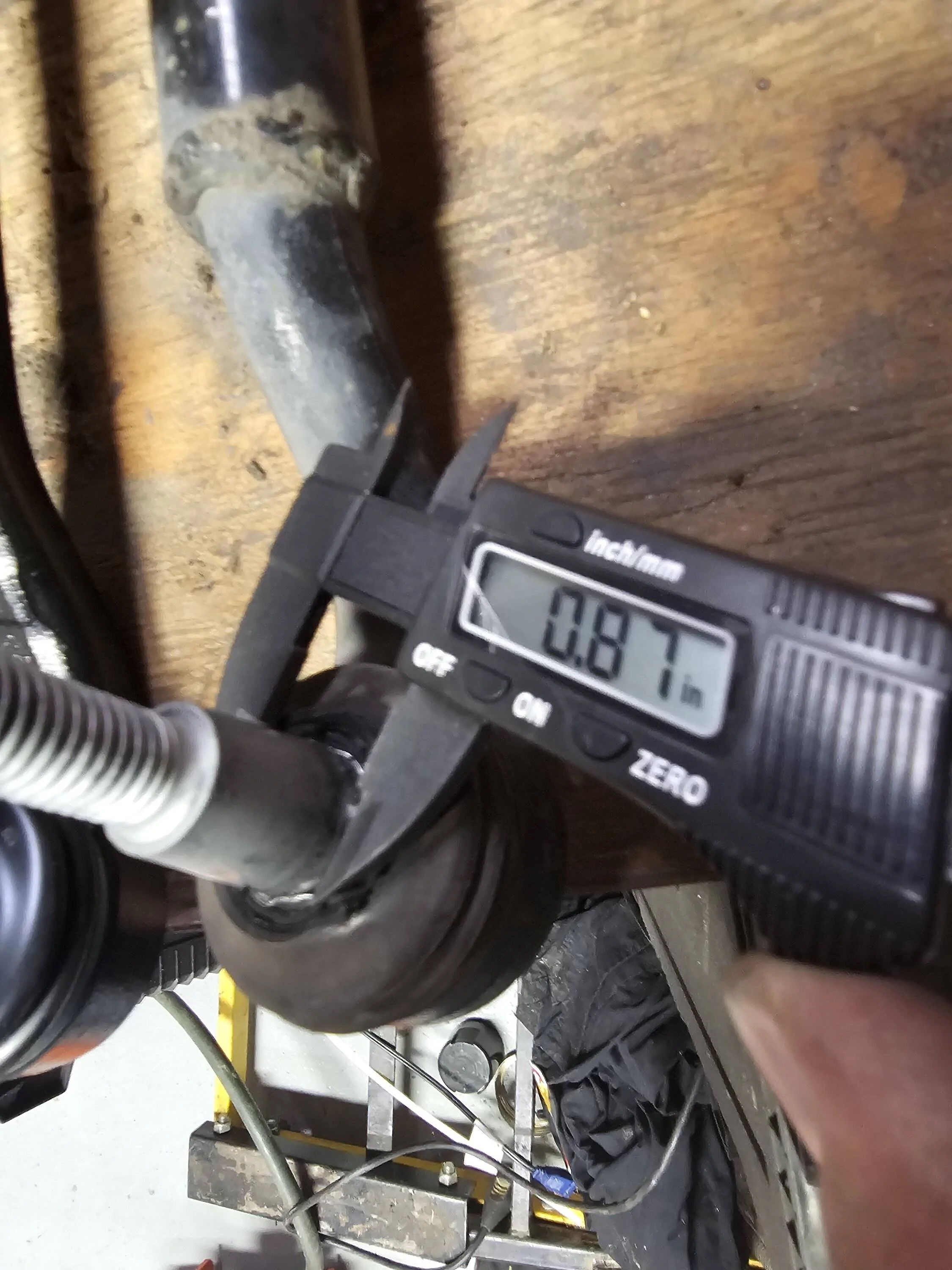

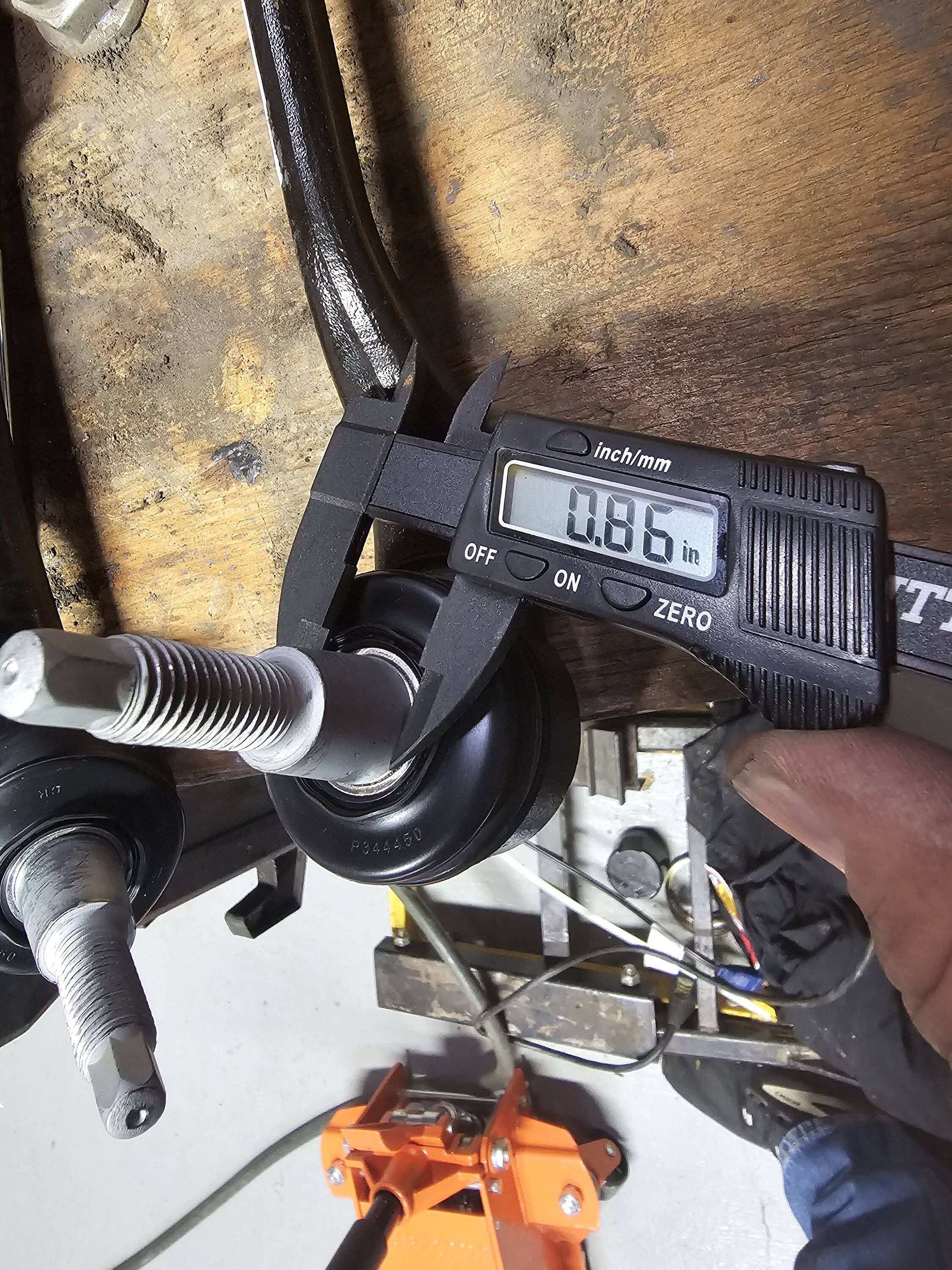

I have .850 on the PP arms and my stock ball joint stems are .870
The .850 stems pull through.

Ok, looking at this closer there is a collar on the bottom of the ball joint stud. So even if the stud pulls all the way through it should land on the collar and that should allow movement as the collar turns with the stud.
With my stock arms installed it drives and steers like it should. With the PP arms it binds up.
Any ideas what I should look for? The bars measure the same and appear to have the same offset. I'm at a loss here.

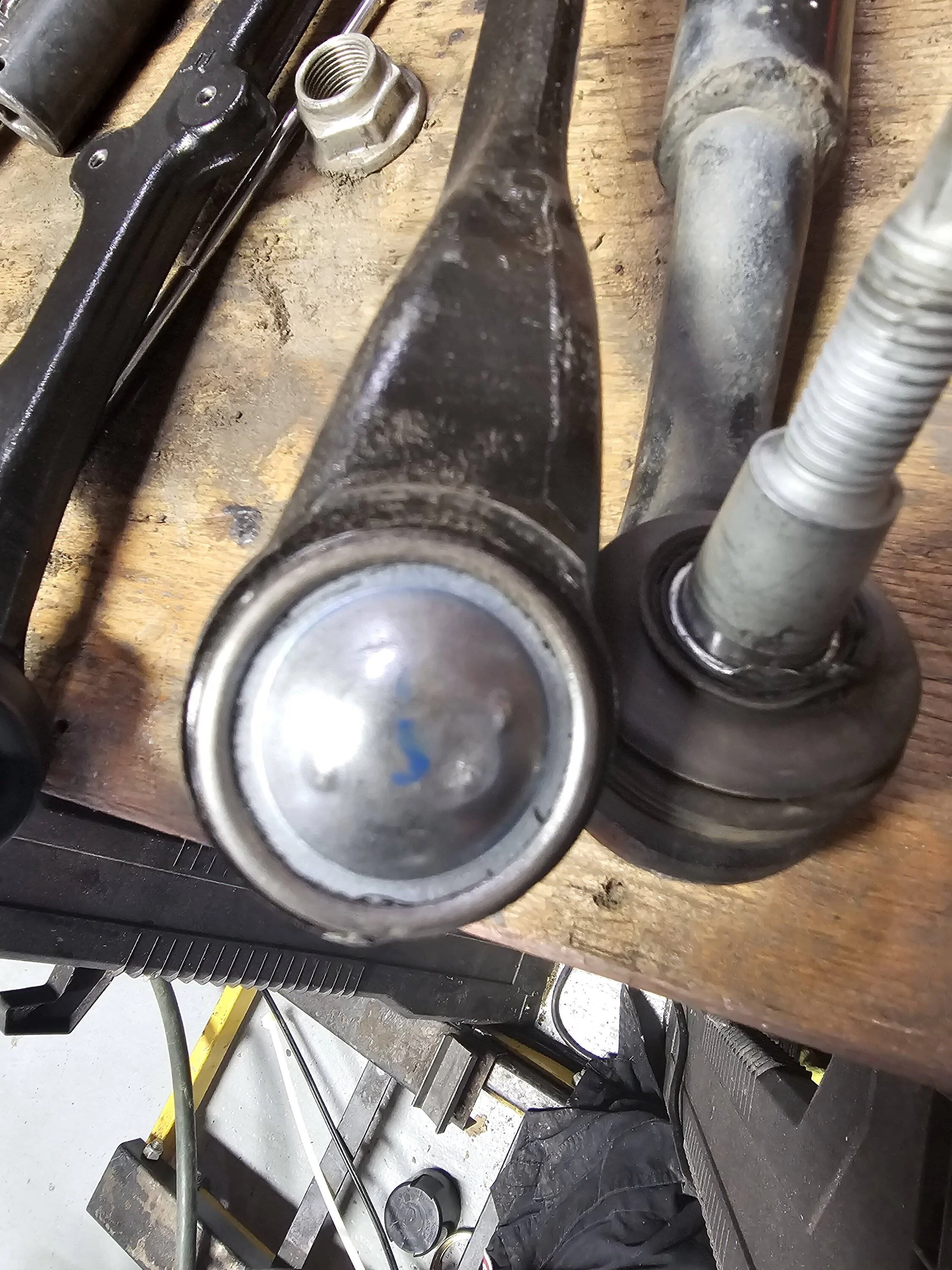

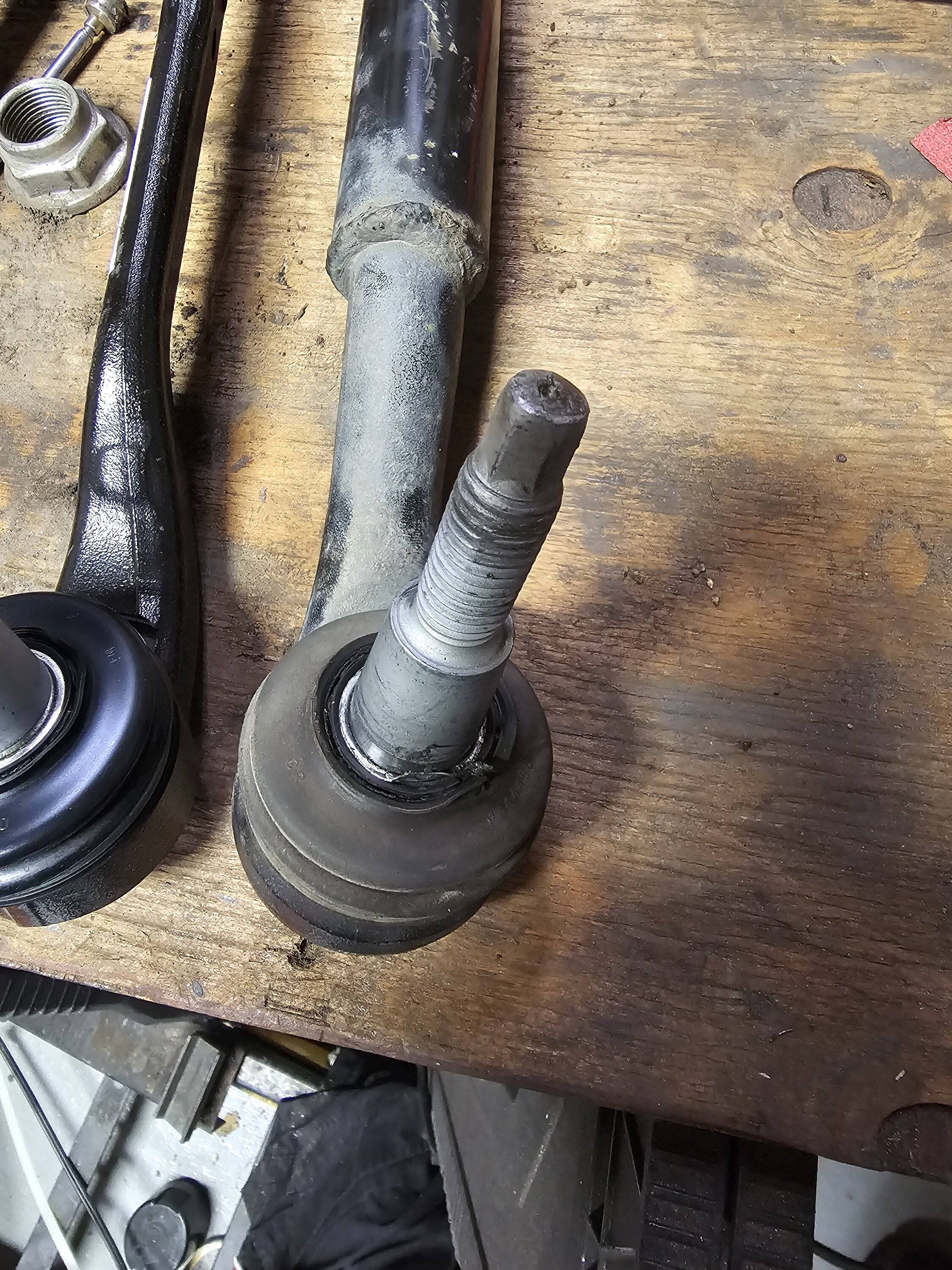

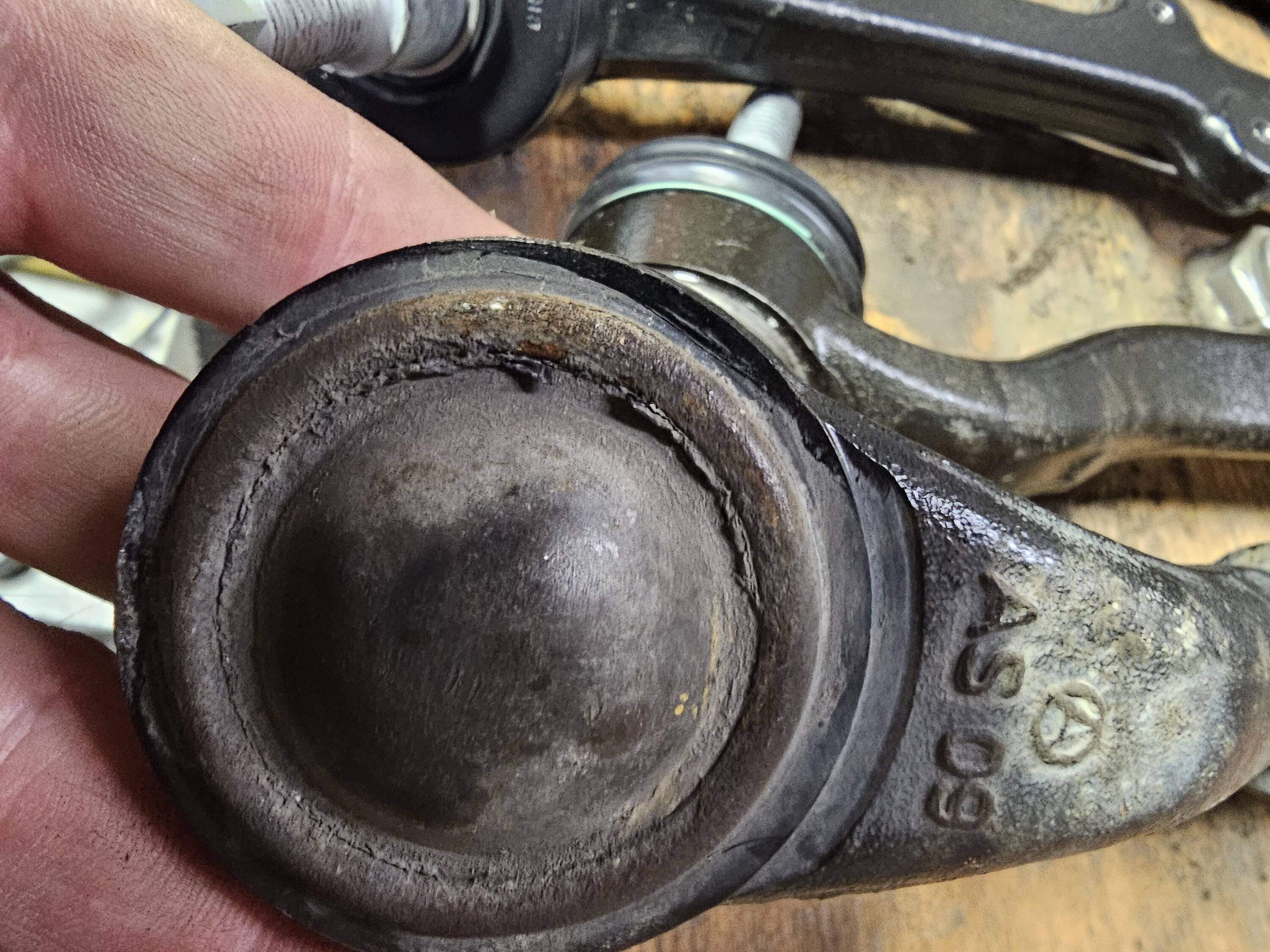

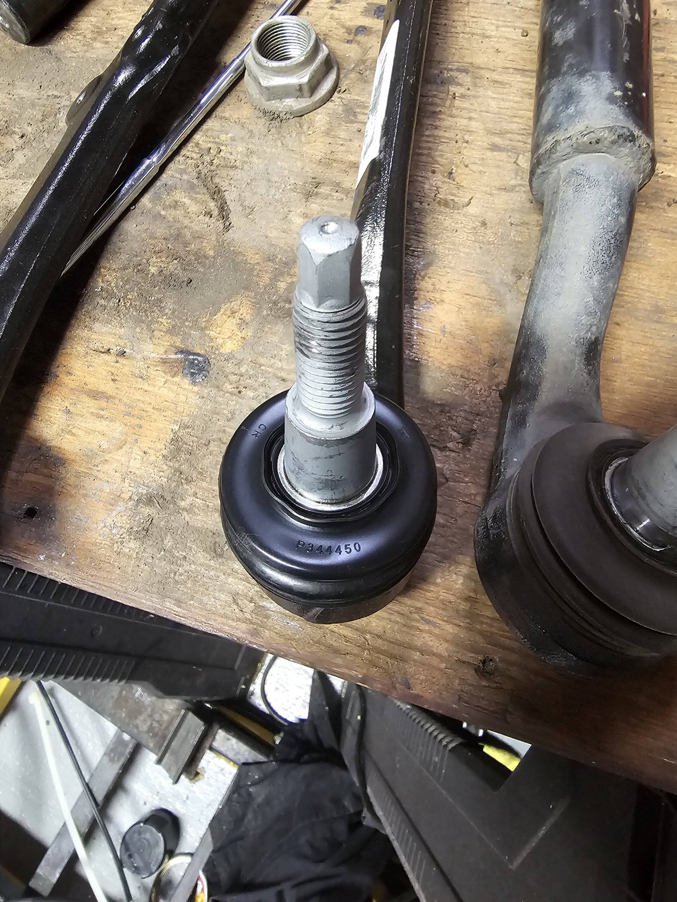

If you can post some pictures of the ball joint end of the arms, the studs and the cap on the bottom of the ball joint that would be helpful

Here you go. If you need more or different angles let me know.

Take a 10mm (or whatever the size is) wrench and see how the ball joint spins. You have verified that everything is torqued properly (the ball joint spins in the arm-NOT the knuckle) When the ball joint is tightened it should be wedged into the knuckle. Is it possible the steel caps at the base of the ball joint have damage and it has locked up the ball joint? Have you checked this Binding with the wheels off? Do you have the forward mounted control arms installed on the proper side (they are also right and left) Are you positive it is not just an alignment change from the new parts. Need more on what binding means, you cant turn the wheels or it feels different? I will assume you are not attempting to place the ball joint into the knuckle upside down...
