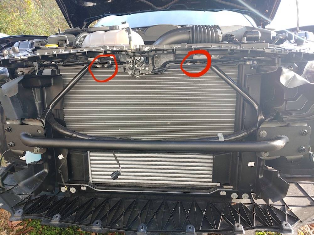

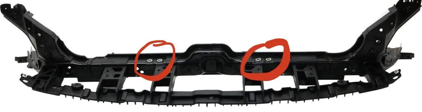

I believe I have figured out at least part of the puzzle but I still am not 100% sure of the bolts that mount the braces (FR3Z-8187-A, FR3Z-8182-B) to the radiator mount / upper tie brace (FR3Z-8A284-A).
Based on this post I believe there's a chance nuts used to secure the braces and the bolts used up top are the same thread, unless this person swapped their bumper bolts. Bolts are cheap so I'll take the gamble and order 4 extra bumper / impact bar bolts (W711097-S437) along with the 4 nuts noted above (W716409-S442).

The support stays the same. It's the two front braces pictured here that aren't on non-PP GTs:
It's the bolts circled here I'm not 100% on what they are :

The first pic is a refresh PP car, so yep, they're there.

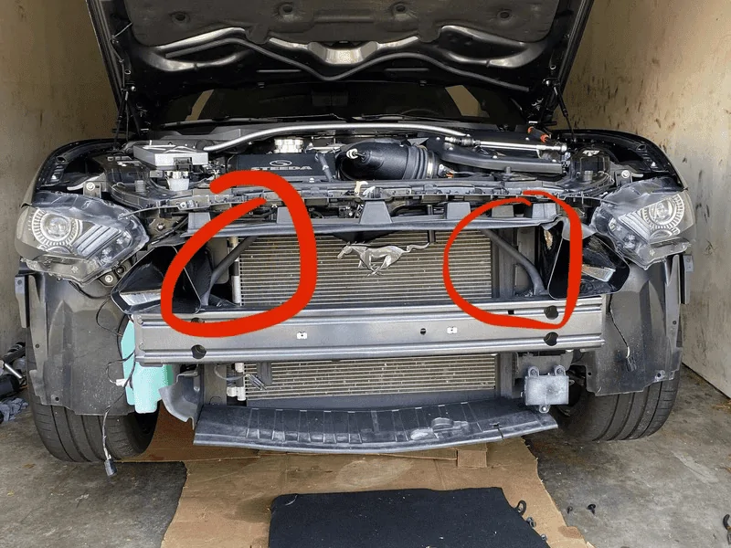

Oh lmao, I didn't notice the headlights for some reason. I still wonder if they were on there by default or that person added them though, especially since they changed the crash bar (as well as modified the grille and had velossa big mouths). Either way, I don't see what the purpose of them is, and I've never seen anyone on here talk about them in the few years I've been on here.

That would be crazy if I'm the first lol. Tasca's site also lists the part as applying to 2015-2023, so I'd wager they're there.
I think if more people were adding them after I'd have had more replies by now. I'm going to reach out to some dealer parts departments and ask if they know what bolts they are.

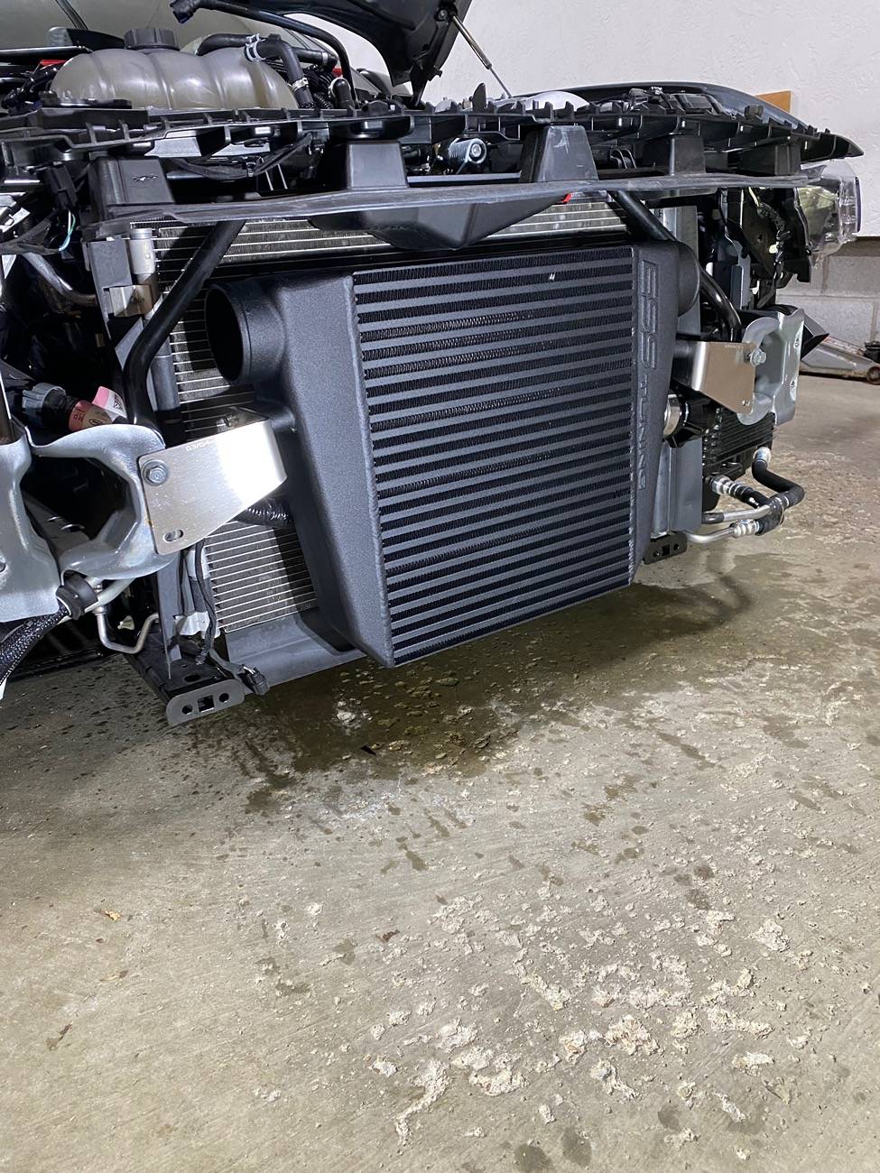

You might not need them. They are removed if you install an ESS supercharger, and I would assume any other blower with an intercooler in front of the radiator. You can see in this picture they are blocking the inlet and outlets of the intercooler. I've had no weird issues after taking them out.
