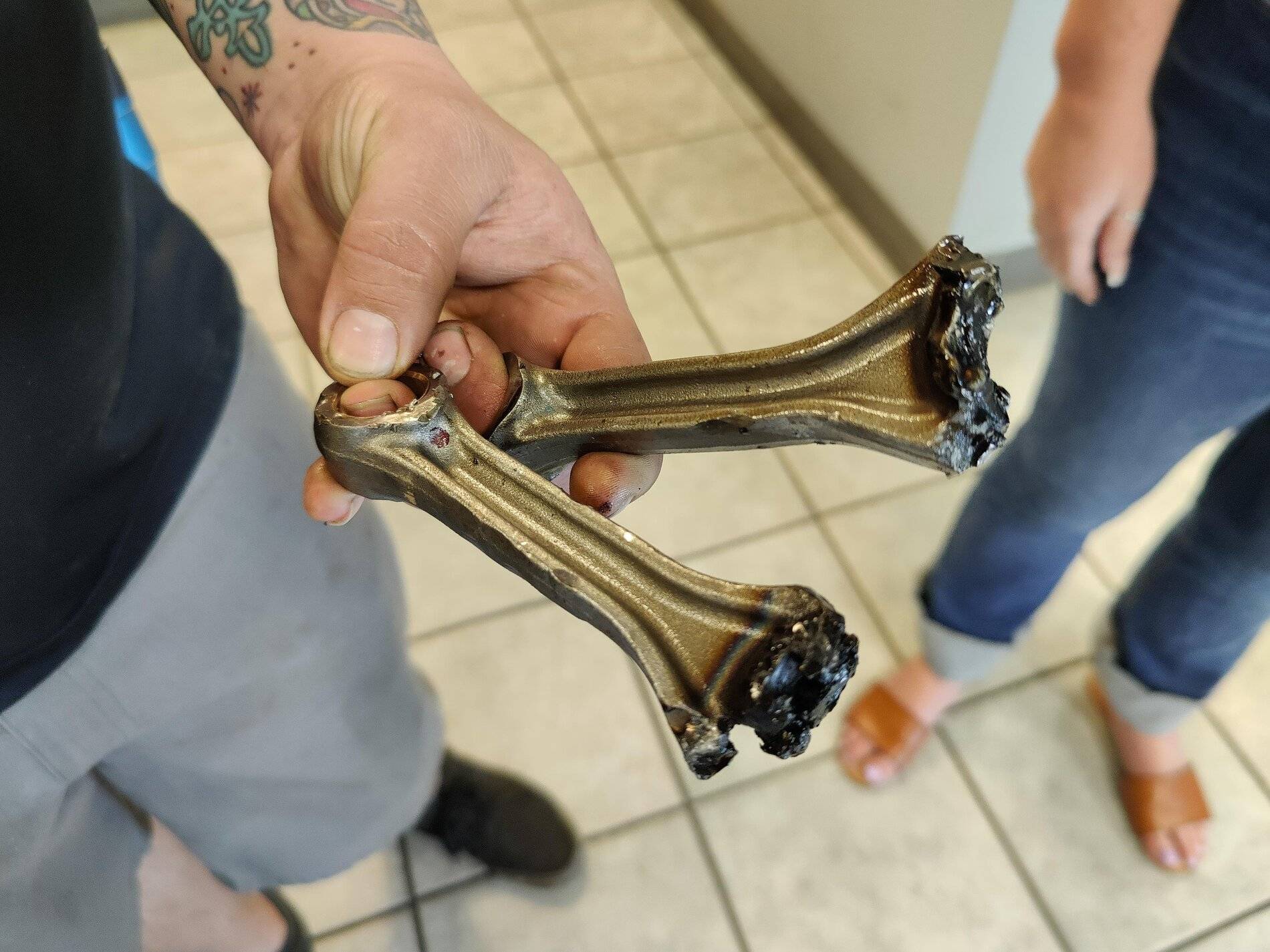

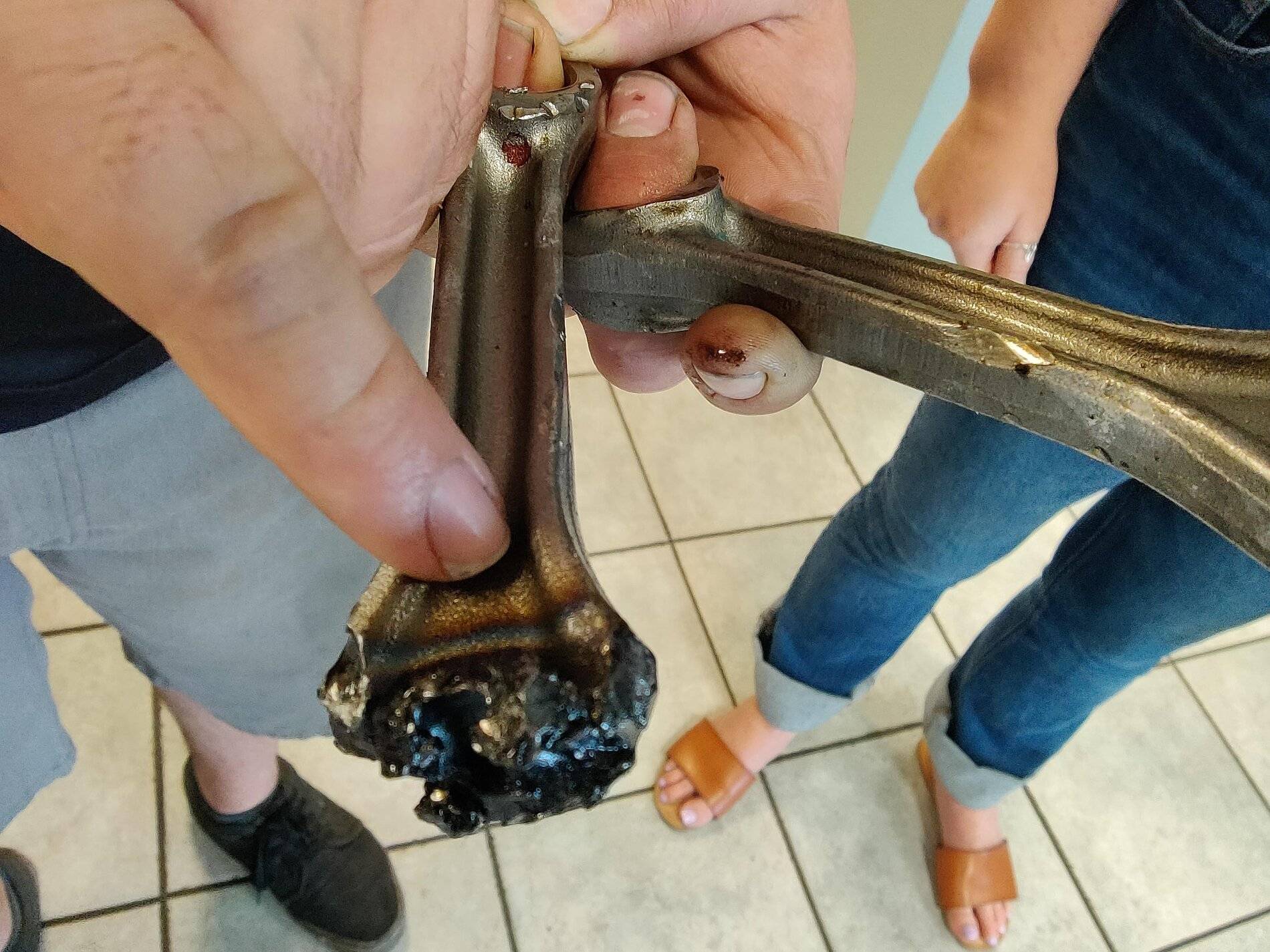

Official RCA is in, confirmed spun bearing. Atleast that's where it all started. One of the rods was hanging out of the oil pan. Kevin pointed it out when we were first looking at things but it was hard to tell based on where it was and we didn't have good light or space to confirm.
Dealer started the car and let it warm up to running temp with the existing damage. Then pieces started flying. The timing chains got destroyed and the head was blindered. Rockers were missing and some shrapnel was shot into the valve cover. A wrist pin shot out of the oil pan and was spinning on the ground when they turned the motor off.
They got a new long block in Wednesday and I just got home from picking it up today.
