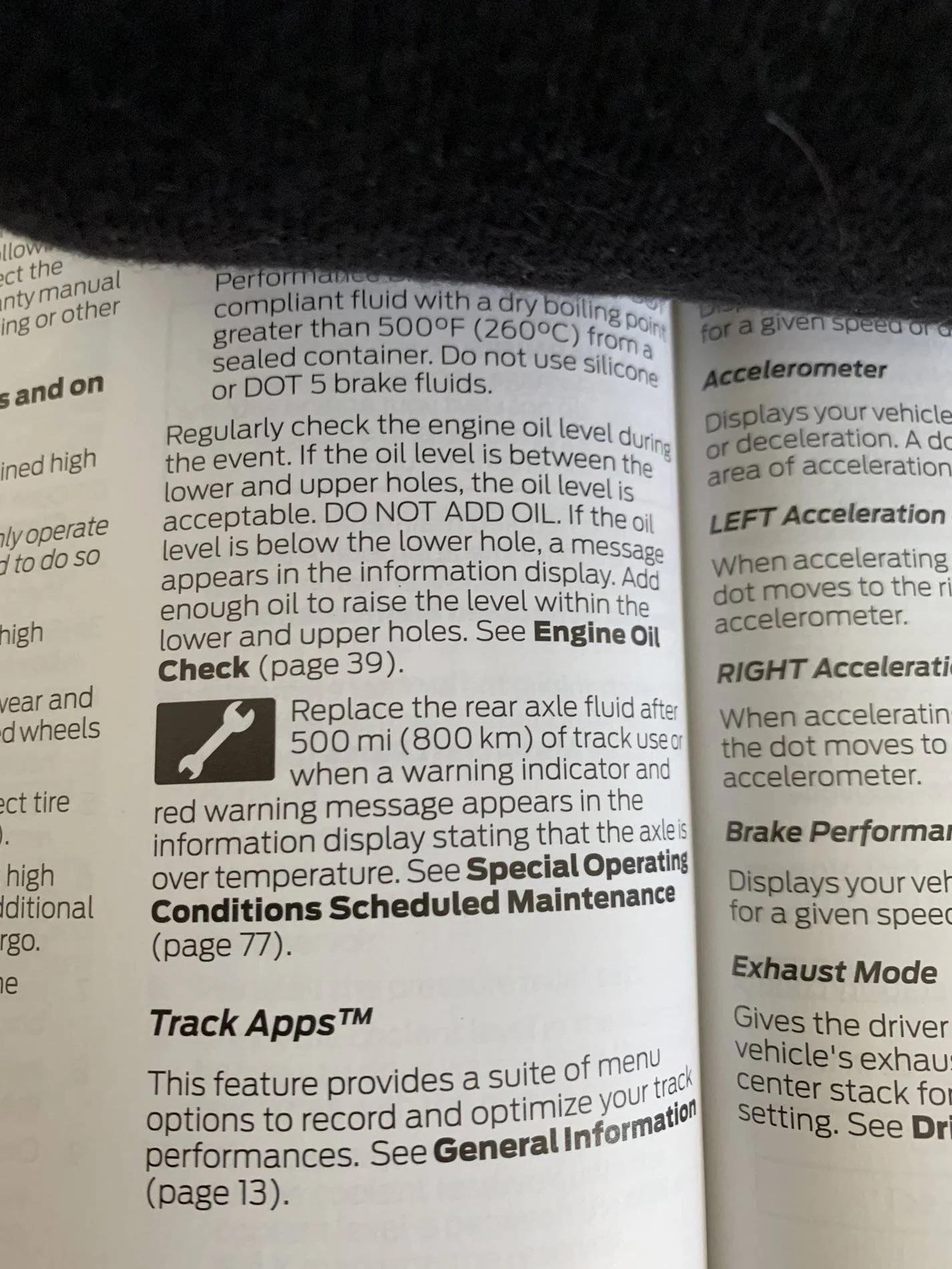

I believe the wrench means dif fluid change required. Usually would come on after 500mi of track use.
I’m not sure why it would come on after 80mi. Page 44 in the GT500 supplement

May mean dif cooler is not operating properly.

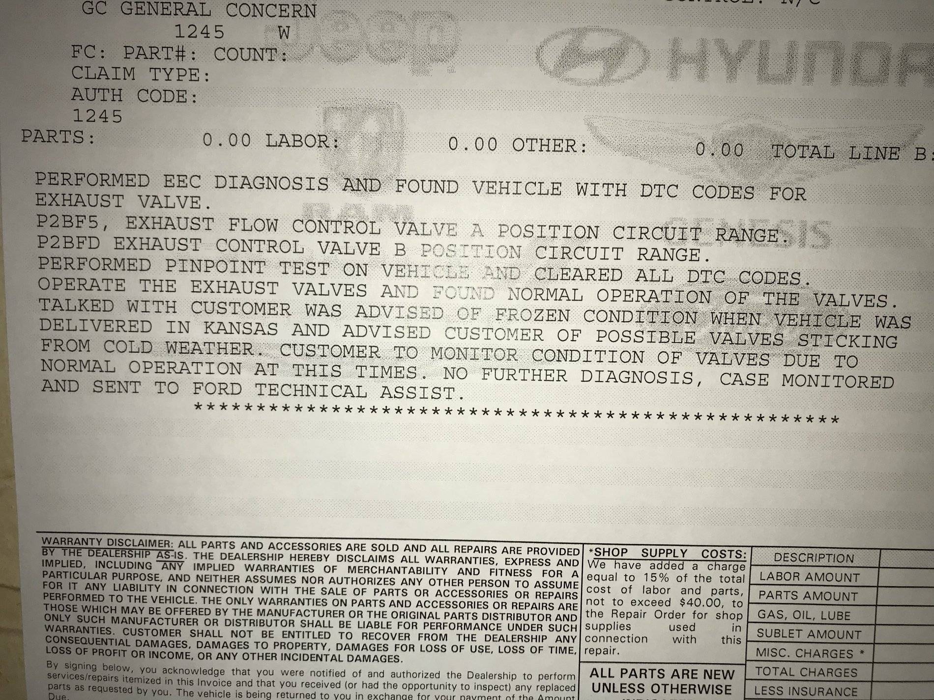

Pointless to guess without a code. Best bet is get it read, itll still be stored.

GF04, It had been stored in a garage overnight, and was probably 38*f /Ks. when she left and driven 10 mile when wrench came on. Message display read powertrain. Maybe affecting viscosity till it warmed up? Voodoo, rodger that, will try to get it on a machine in the morning.., Almost here and will check it out.
Thanks all for the tips. Once known will advise..............rk

Ford available to read code this afternoon. (Wife did mentioned it showed 34*F
when leaving Ks.) Maybe know something this PM. Epy, No visible leaks of any kind will check it out. Kilo, bib overalls wouldnt fit if I still had them, that was 30+# ago....lol. (Keep them avatars coming!) Snoopy, found wicker ground effects in trunk tucked against back seat....thx.....later rk

This is my story, I'm sticking to it! God Bless America.
KB by popular demand. YES!.... lol Regards to all.....rk

And thats why u dont speculate and cause mass hysteria lol
