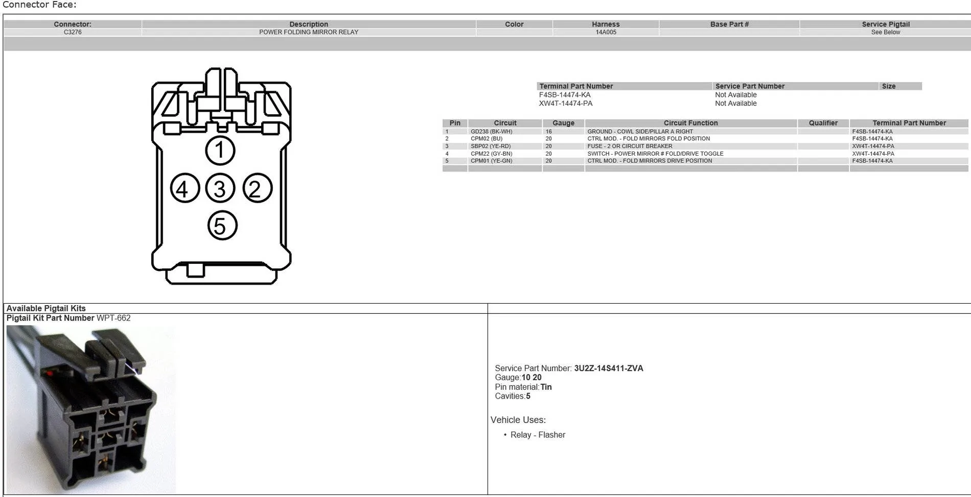

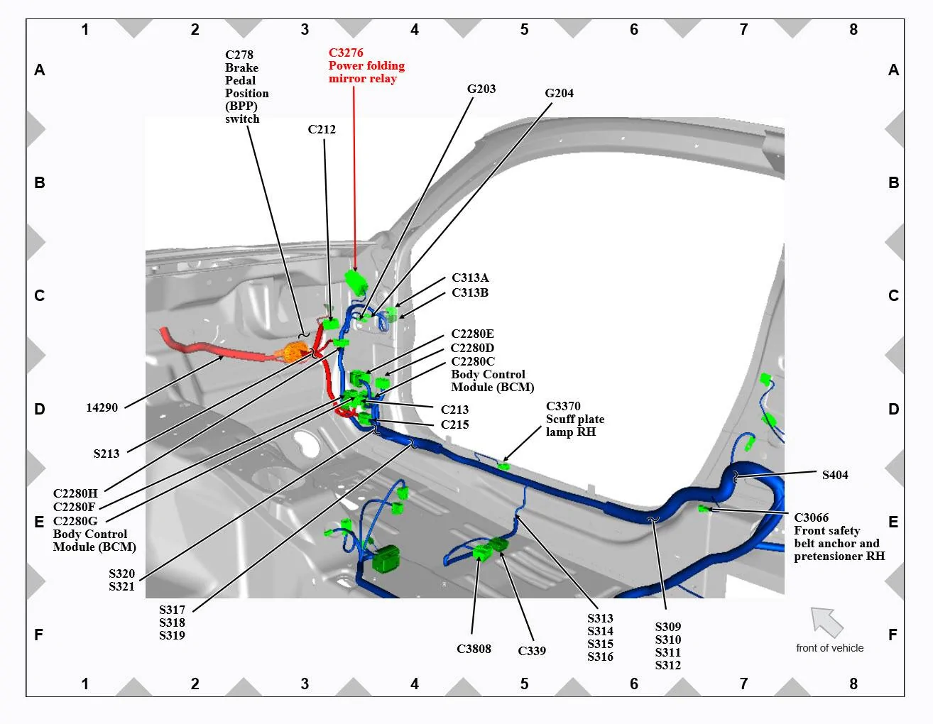

I have two pictures from the Ford repair website. RelayLocation.jpg shows in red (reference number C3276) where the relay is located. RelayConnector.jpg shows the plug that is used for the relay.

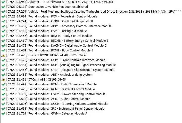

doesnt your car come with the Driver Door Module and Passenger Door Modules? (i thin US spec ones do actually have the DDM and PDM where as ours dont) if so if you find the correct wiring where to hook it up you can programme it in? like with the fusion/mondeos? i've got the wiring diagrams for the fusion which i'll take a look at and get back to you
It does not. I believe those modules are used in Mustangs with the memory seats/mirrors. I did take a screenshot of the modules Forscan found.
