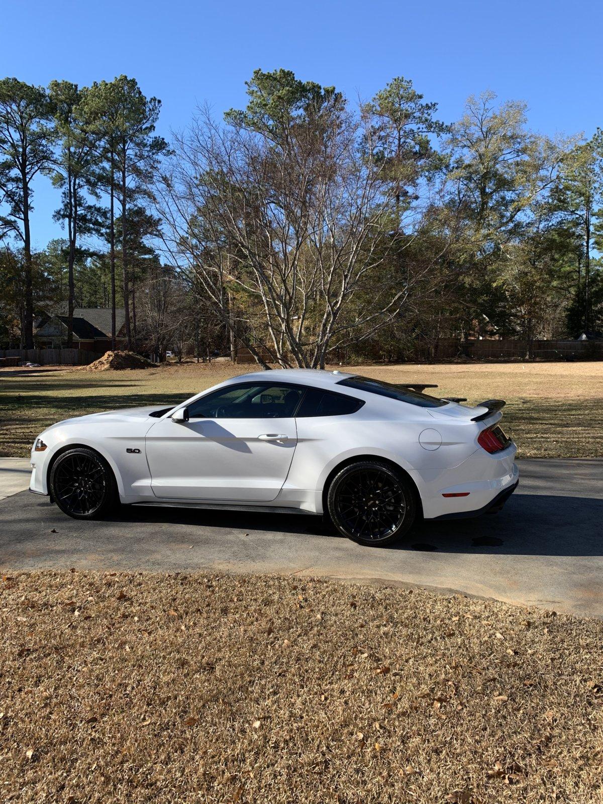

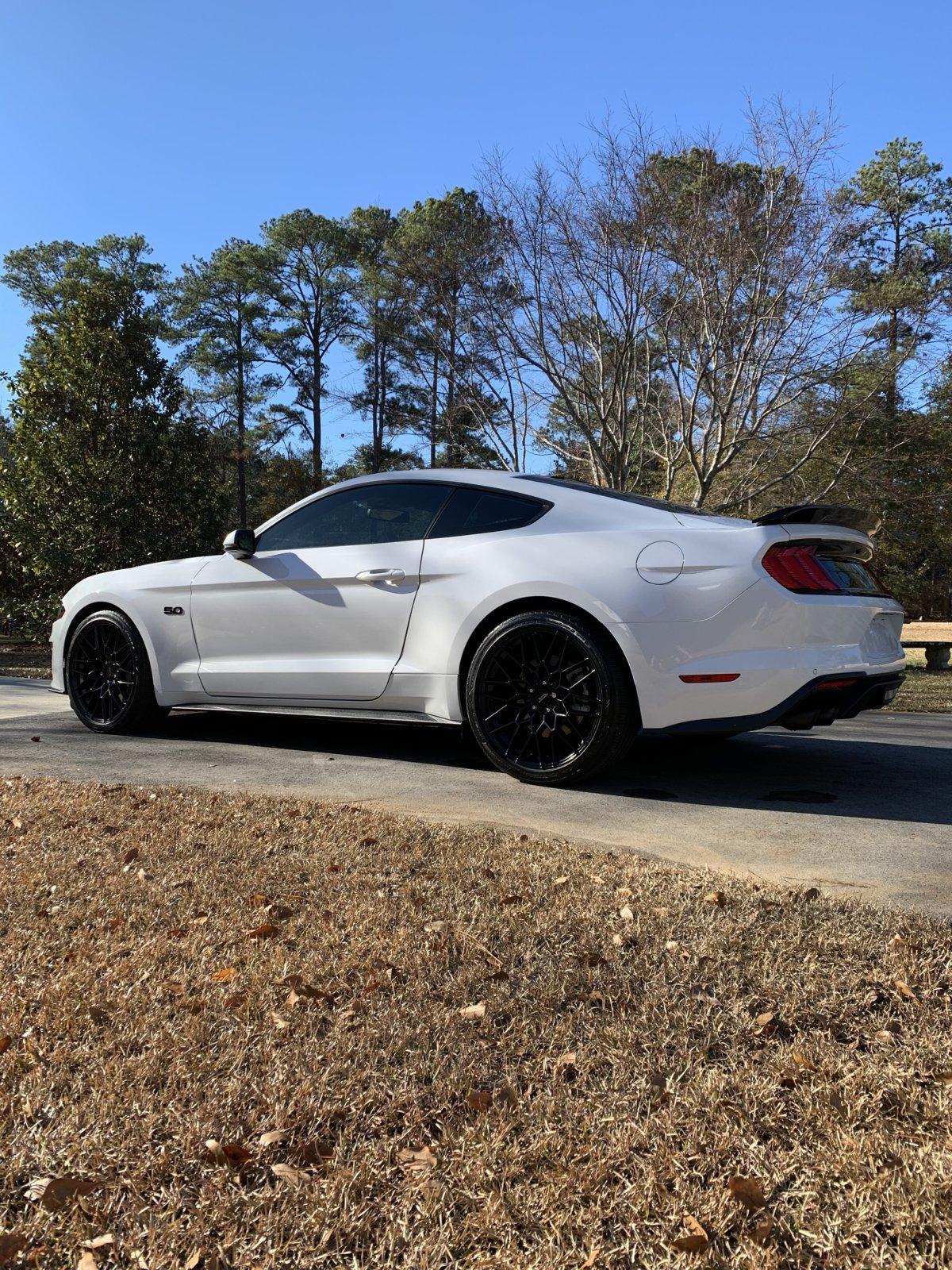

P51’s in a custom gloss gunmetal, thanks to Jake at Vibe Motorsports!
20x10 et35 & 20x11 et50 w/ 275/35 front and 305/35 rear.

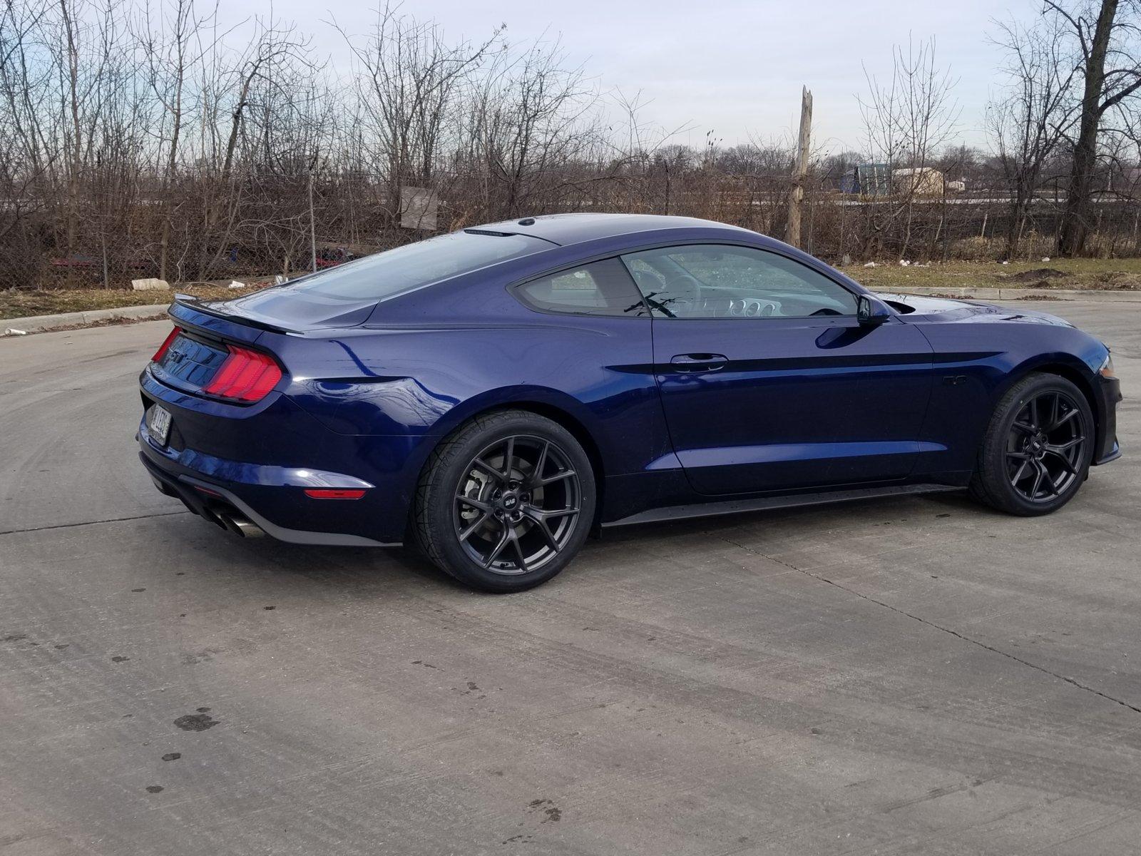

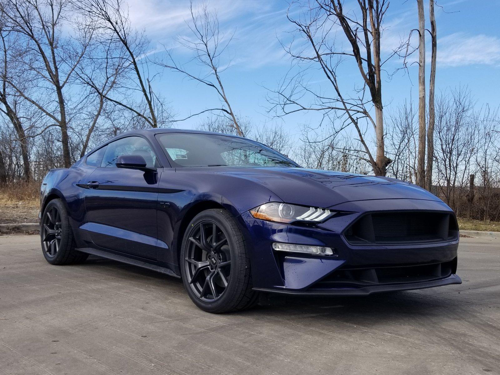

Ford Mustang GT 2019 Race Red with Package 301A
SVE SP2 wheels, 19X10 & 19X11 with 285/35/19 & 325/30/19 Nitto Invos.

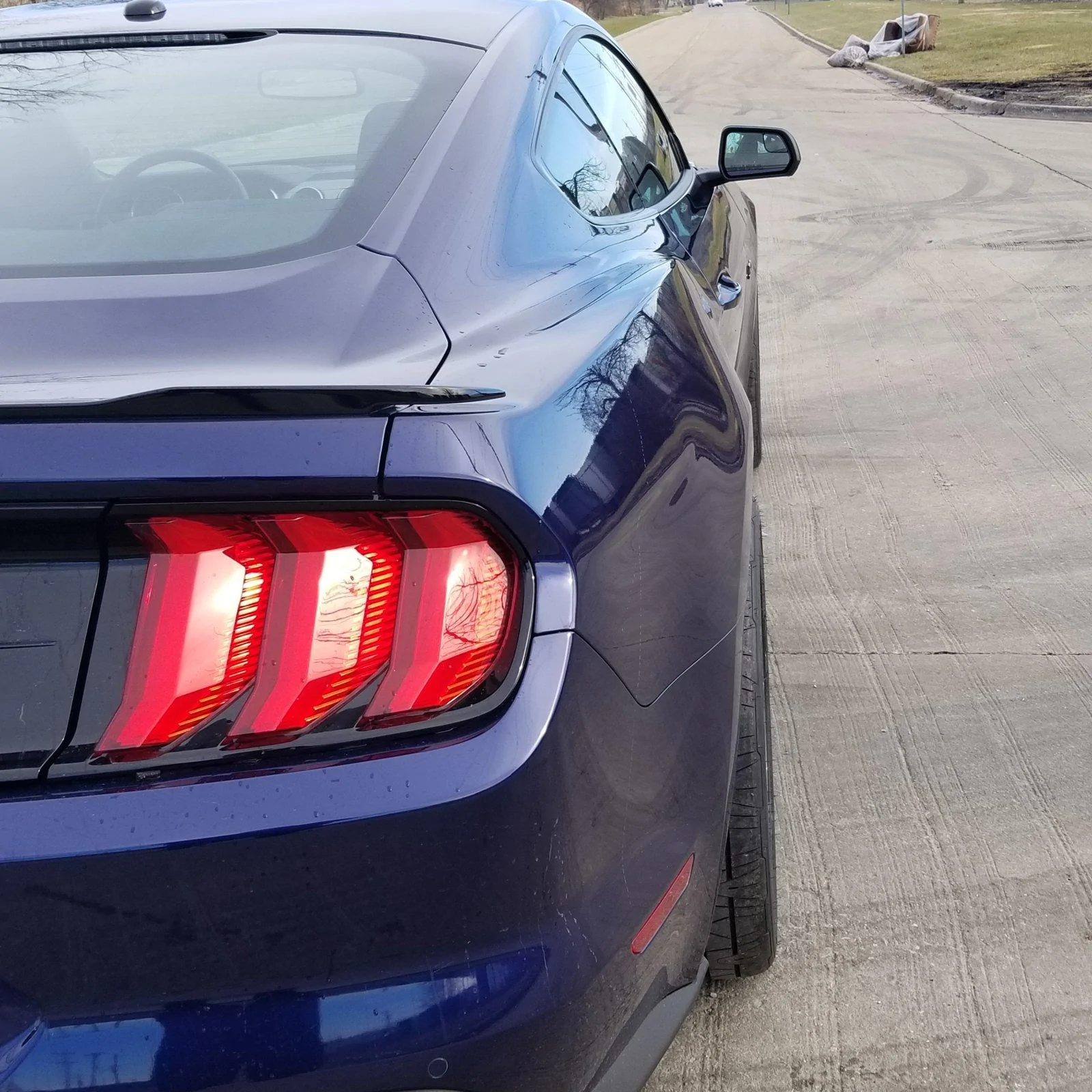

Looks great. I am thinking do the same but still confused if i should go 20" or remain 19" so i have a question. To my like front looks excellent.
In my case i don't want to see that little poke on the rear so should i go with 10" also in the back or should i use a les wider tire like 305?
Thanks in advance...

I'd probably keep the 11", but go 305's in the back.

The 325's are 12.91" wide. As long as your rear tires are no more than 12.3" section width on the 11" wheels, there should be no poke.

Thanks @LSchicago for the advise and clarification. At least at the moment i am not planning to lower the car so i think it is a great idea to keep the 19 for the bumpy roads overhere in PR.

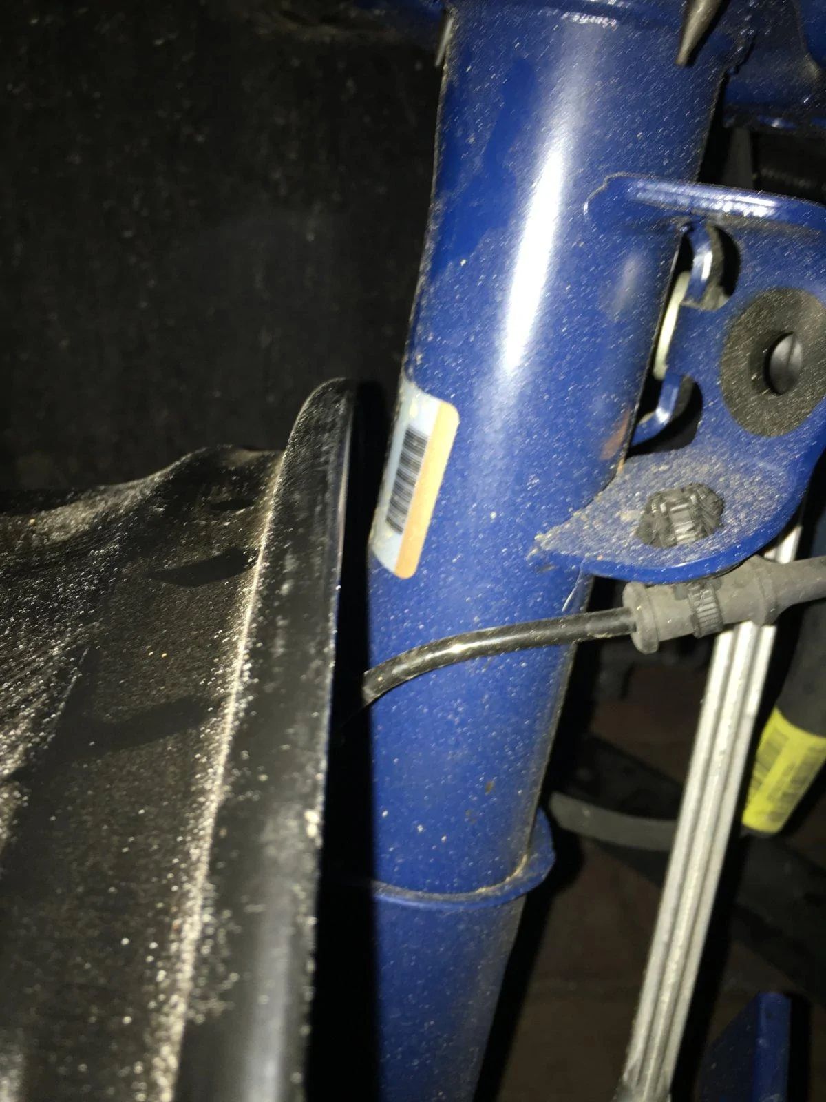

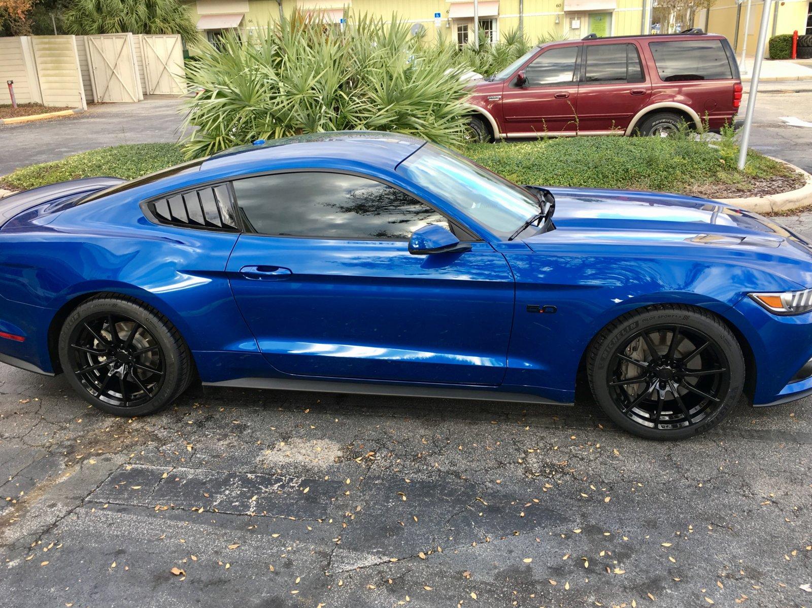

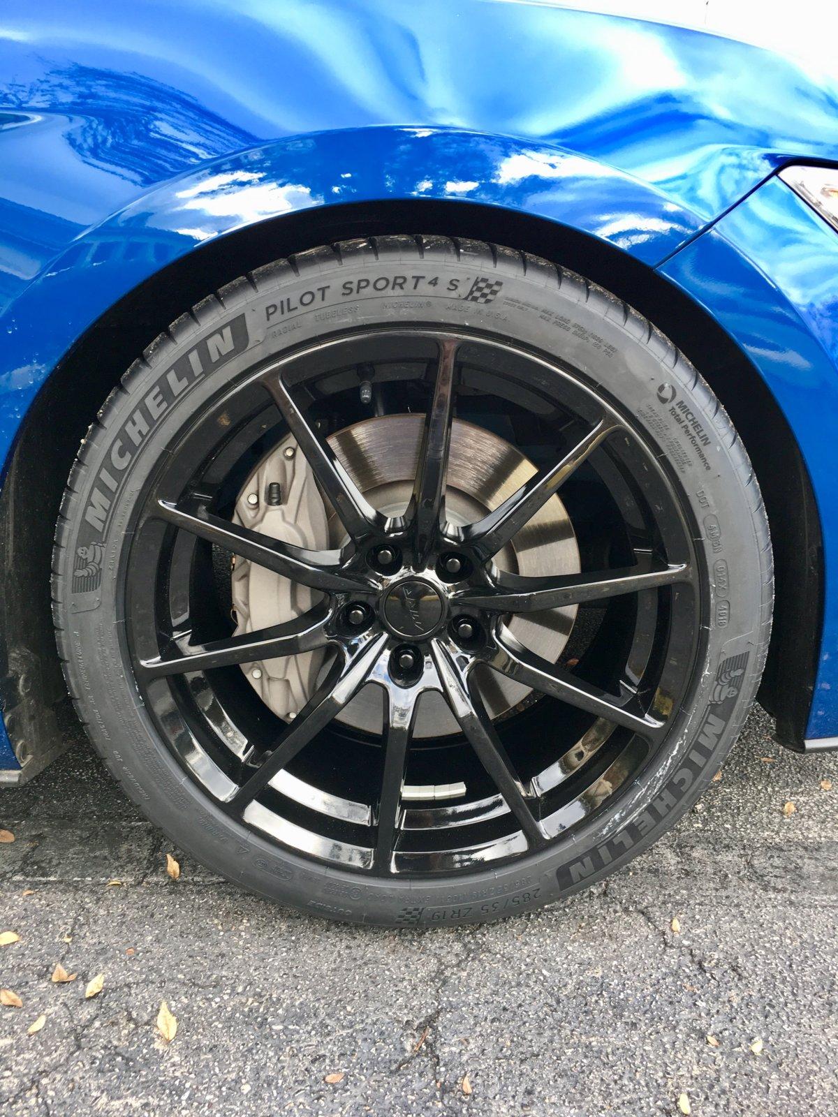

Got a good deal on some brand new MRR M350 wheels a couple weeks back. 19x10 with 40mm offset wrapped in Michelin Pilot Sport 4S tires, 285/35/19 all the way around. 5MM spacers were required on the front, car is lowered on the full Ford Performance Track Handling Pack suspension. I was a little concerned about fitment/rub/poke and so far have had no issues. I'm extremely satisfied with how well they tuck in. Can't wait to get the glue off them so I can start pushing the car a little more. Two of the MRR's were just slightly warped and required a bit more weight to get them balanced. I saw another thread on here where someone else had a similar issue, but they're rolling just fine at the moment.

Why were 5mm spacers required on the front?
Have you got a side shot?

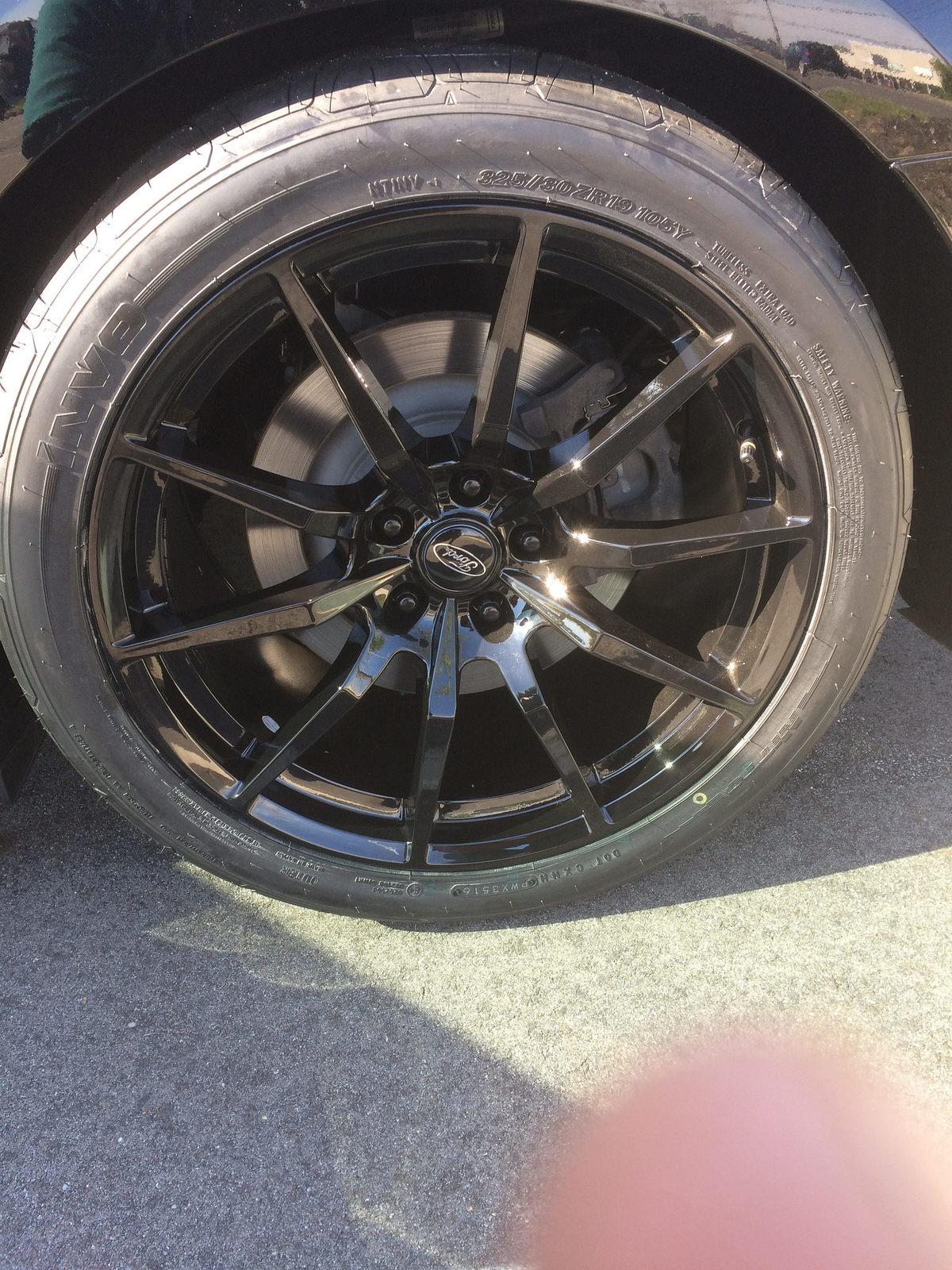

I've got a bad sideshot from the day of the install. I didn't bother taking a better one for some stupid reason...
Anyway, I did a test fit of just the wheels and they were super close to the front strut. See the attached pic. I told them to try it without the spacers and see what happens. After I picked it up the guy said the tires were really close to the front struts, so to eliminate any possibility of rubbing he put the 5mm's on the front.

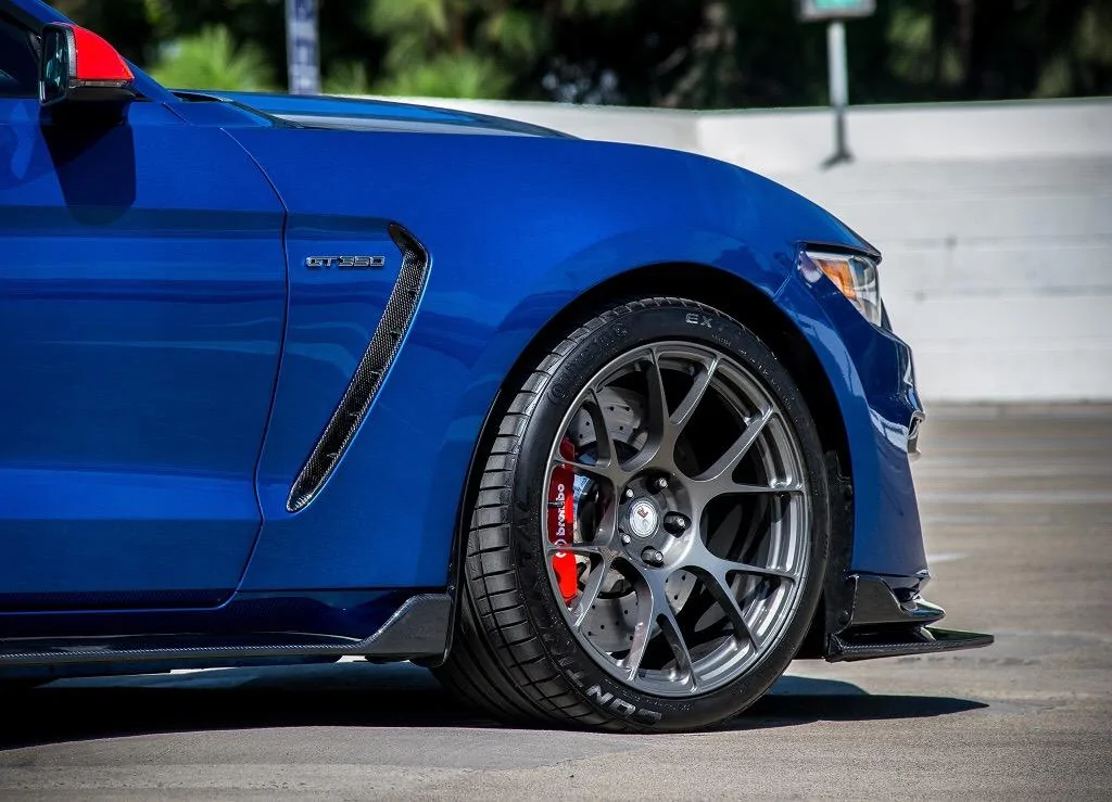

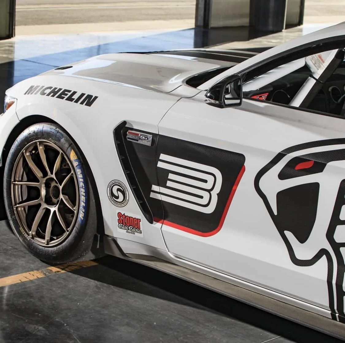

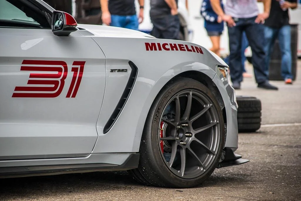

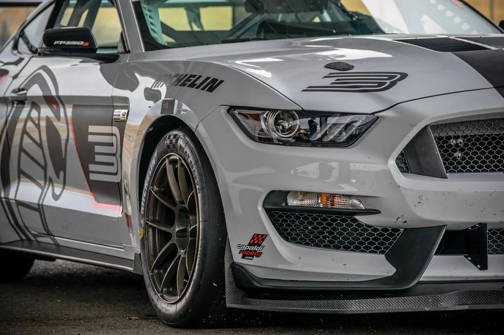

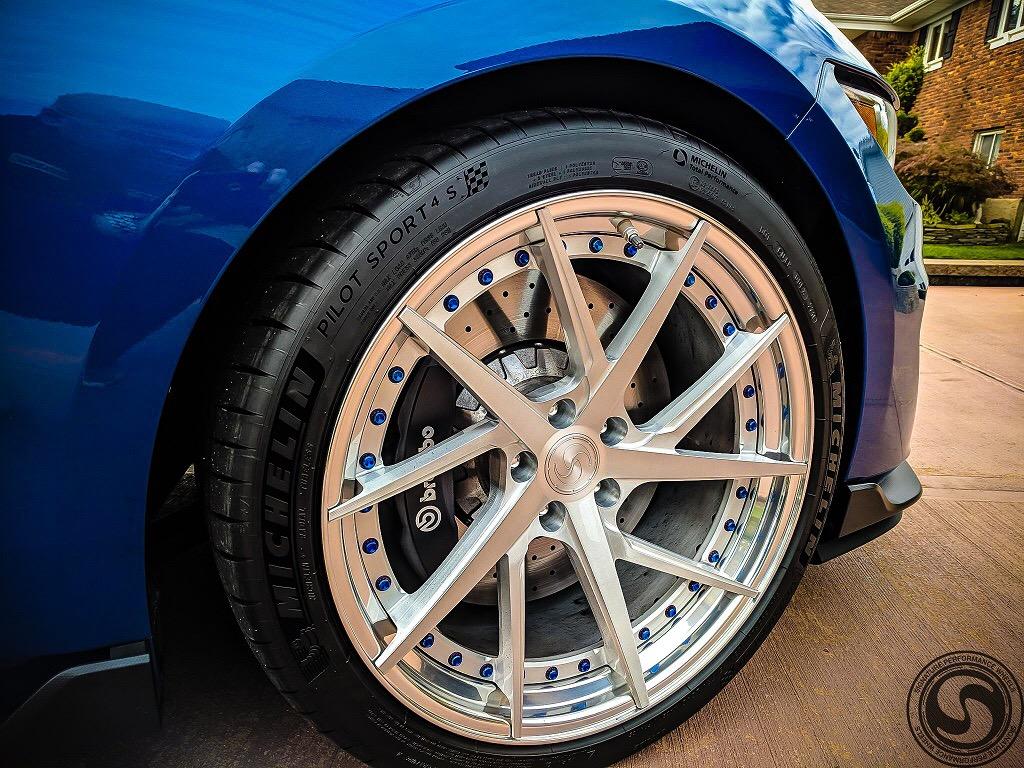

Where to begin....
https://photos.app.goo.gl/qBHDLwf5bI6kFYRK2
Signature Wheel SV306S
Signature Wheel SV307S
Signature Wheel SV302S
Signature Wheel Precision Series SV702
Signature Wheel Track Series SV503
Signature Wheel Track Series SV502
Are the Signature Wheel SV306S in the first image Bronze or Royal Gold? Can I see them in both finishes somewhere? Seriously considering buying a set, these things are fire.
